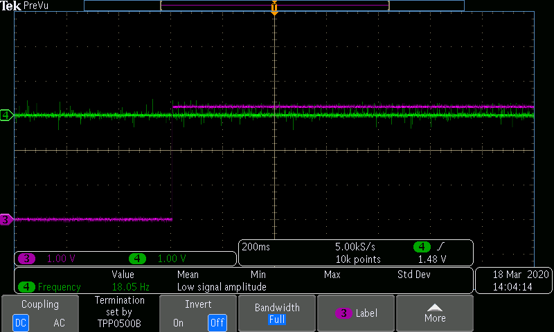

Hello.
I have a problem about operation of LMZ31707.
This circuit used to operate normally.
but there has been an malfuction.
Green is SS/TR Voltage. not working.
Insert the capacitor on the outside to perform normal operation.
I want to know reason. Why did this problem occur?
Thanks.
  • Hi, did you intend to attach a waveform? Please double check. It will help if you can also share a schematic snippet to help point out the capacitor you are mentioning. Adding the capacitor makes the circuit work again?

  • I do not see any issues with your schematic.
    What is the waveform showing -  Green is SS/TR and Pink is output voltage?
    Is the issue you are reporting that you cannot measure any voltage on SS/TR pin (though output voltage is fine)?
    If you add the external soft-start capacitor C229 then you do see voltage on SS/TR pin?
    It is not clear to me what problem you are facing.
