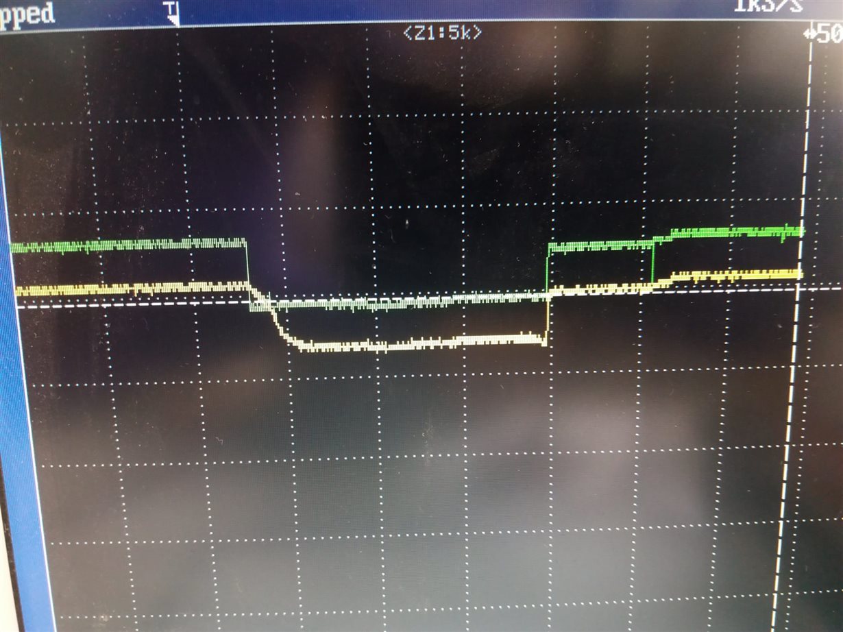

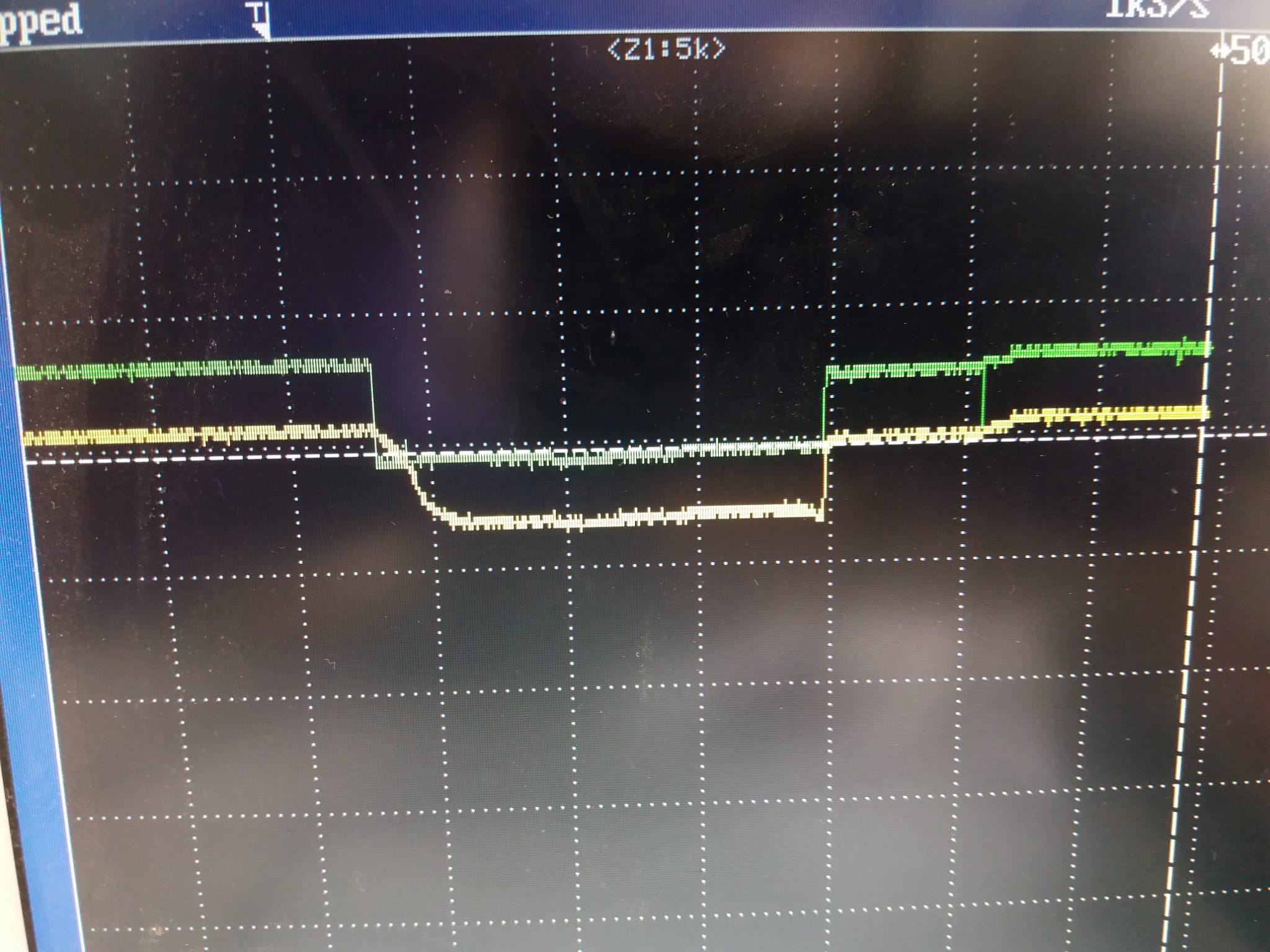

    Both signals are stable during programming:
    SW=2,8 V
    Vin=2,55 V
    After that, we make a system test, where SW voltage decreases below Vin during 100 msecs aprox. as you can see in the following picture:
    Is it a problem?
    BRs,
    Igor
  • Igor,
    I would have expected just DC voltages.  It is difficult to comment without being able to see the amplitude and time scales as well as the ground reference point.
  • John,
    Green signal is Vout=SW. 2,8V
    Yellow signal is Vin. 2,55V
    During the test, Vout decreases to 2,4 V, and stays below Vin, during 100 msecs, until Vin decreases also 0,4 V (0,25V below Vout).
    Scales are 500 mV / 500 msecs.
    BRs,
    Igor
  • Igor,
    Why do the voltages change?
  • Hi John.
    Voltages change because some LEDs are blinking during system test.
    I have been doing same procedure: to power the reader through regulator-Vout to 2,8V and do system test, but after testing 200 readers, Vout doesn´t decrease below Vin on most of the cases.
    So, regulator Vout & Vin are stable during programming and also system testing.
