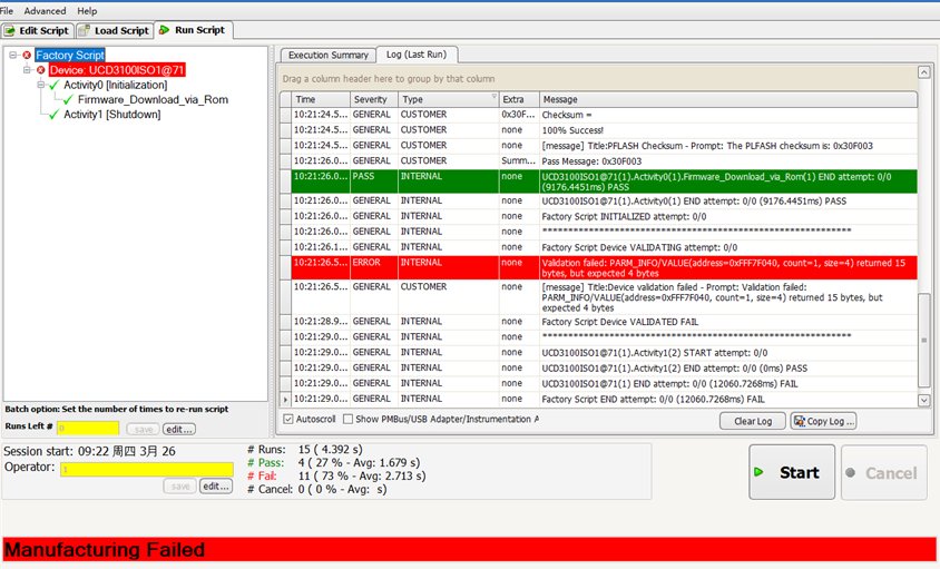

Currently I'm testing the fusion production GUI for factory production purpose, and get 2 errors, can you please help share some comments on below 2 questions?
1. Download firmware via rom. If the memory peek/poke commands were taken out in firmware, it will insert a falied message after finished download. I think the production GUI will try to send the memory peek/poke command automaticly after program flash contents finished, can you please help to fix this? Here is my testing sripte solution folder, that could be used to reproduce this issue.MFR SCRIPTE- download via rom and momory peekpoke takenout.zip
The error picture shown as below:
