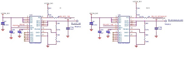

I  want to know the PG of the first TPS74401 control the en of the second TPS74401 to control the power on
  • Hi Lei,
    Yes. this is possible. The only thing to consider is that the PG asserts at around 90% of the target voltage:
    This is no significant delay on the PG pin asserting, but you can use the SS (Soft-Start) Capacitor to increase the Soft-start time of the 2nd rail to make sure that the first is in regulation before fully enabling the second rail.
    I hope this answers your question.
