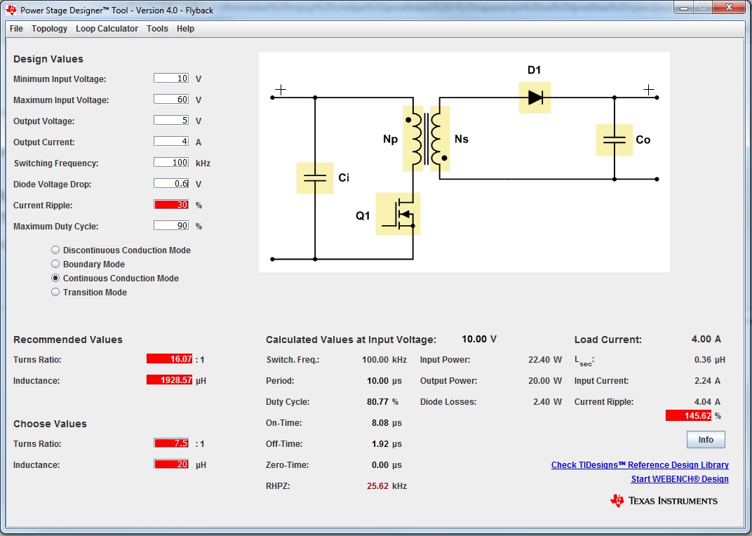

Hi Richard,
I used the Power Stage designer with parameters flaybak transformer 20 uH / 7,5:1 / 100kHz and got the following results:
My question is: Is it possible to design TPS40210 in this duty cycle?
Tsvetan
  • Hi Tsvetan,
    TPS40210 datasheet has specifications for minimum on and off-time, where on-time is defined as duty cycle*period, and off-time is (1-duty cycle)*period.
    At 100KHz, your specification is fine, but your inductance is much too high. This can reduce your power density and efficiency because your inductor would be incredibly large. I would recommend finding another transformer that has a higher turns ratio that allow for more flexibility.
    Additionally, there is also the next-gen version of the TPS40210, which is the LM5155.
    Looking back at your original post, I found a suitable reference design that you can use that follows the LM5155 for a non-isolated output, and an isolated output. Please take a look and let me know about what you think.

  • Hi Richard,
    Design is entering its final phase, but I have some concerns. The flyback transformer (EPCOS B82802A0055A225) is designed for 36-60 volts, and I use it for an input voltage of 10 to 60 volts. With a turns ratio 7.5: 2.5: 1 and a duty cycle 0.91, will I be able to get output voltages of 5 and 12 volts DC? Everything is fine by design calculations(DesignValues_12V_LM5022.jpg), but still, please check the design for major bugs.

  • Hi Tsvetan,
    Sorry for the delay.
    In general, your power-stage design looks fine.
    Your configuration of the compensation network is correct. The error amplifier should be disabled, since you are controlling COMP externally.
    I would change Ccomp to 1.5nF, since C_comp should be equal to 1/(w_zea*R_fbt). .
    Richard
