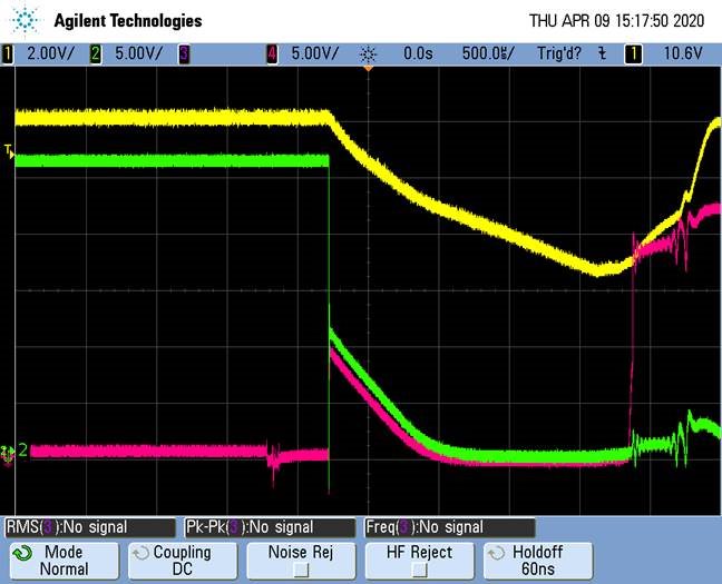

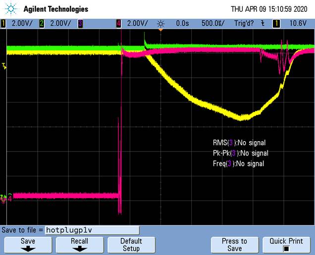

Hi Expert,
Customer use TPS24741 to ORing and hotswap between two 12V rails. The system voltage 12V is working fine(won't reboot) when switch from main to aux. However, when switch from aux to main, Vsys will reboot. Would you please provide some suggestions how to translate smoothly without system voltage drop? Thanks.
Oring_TPS24741_copy.pdf
Yellow: system voltage12V
Green: 12Vaux
Red: 12Vmain
Green: Vgateaux (U60 pin4 in the schematic)
Red: Vgatemain (U63 pin4 in the schematic)
Allan

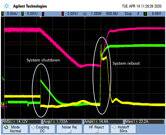

  • We measure system current, system 12V, U63 GATE voltage as follow picture this morning.
    When we plug out and plug in power module, system will reboot high probability .
    The left white circle in picture, we don’t know why U63 GATE close after open shortly.
    Our current is not enough to trigger OCP, are there have any other conditions to close U63 GATE?
    Yellow line: system current
    Green line: U63 GATE voltage
    Purple line: system 12V

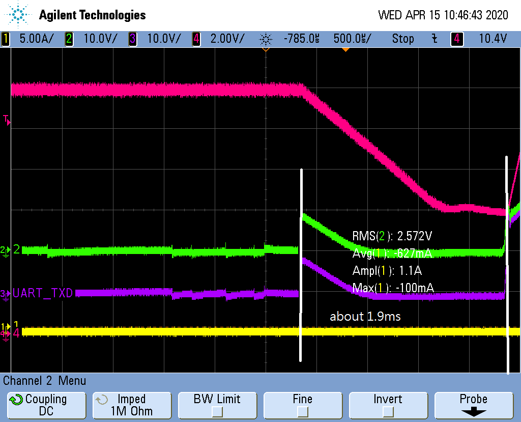

    Looks like you are sharing the gate signal of ORing FET. Please probe gate signal of the Hotswap FET. Al : we probe the How Swap gate ,when our system reboot the ORing and HOT SWAP gate is turn off at the same time
    Please share waveforms as below during switch over from AUX to MAIN,
    Al:ok
    note that when our system reboot, the TINR and TFLT is always low
    and we can saw that is gate is off, the restart time is about 1.9ms

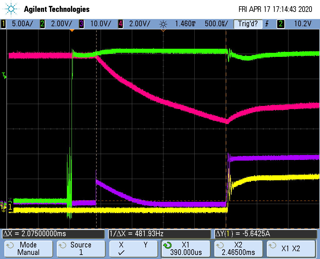

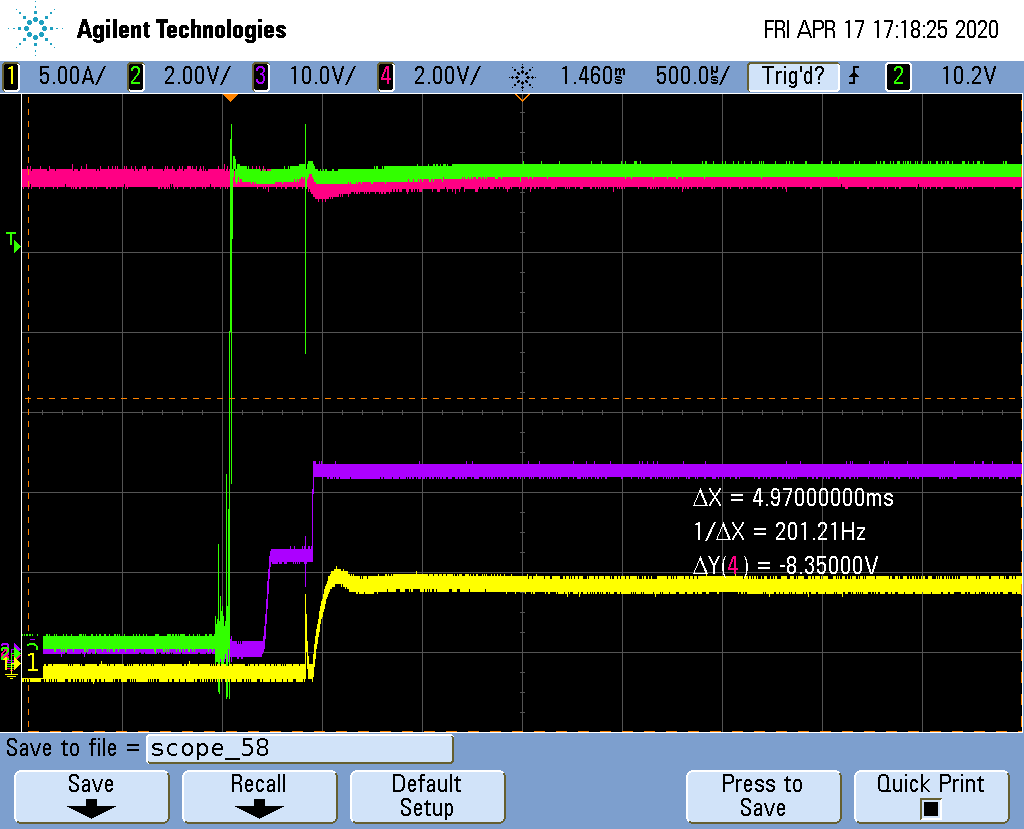

  • Hello Sir:
      we measure the waveform
    Main Channel: Vin, Vout, Iin (Main), Hgate
    Green line: Main 12V
    red line: system 12V
    Purple line: Hgate
    we got 2 different situation here
    1.system will reboot
    2. system will not reboot
    we can see that the system reboot because the 12V in system got power drop cause the gate for main is turn off
    ,some time the gate for 12V  main  is not close, in that moment our system is keep working,but we didn't why will cause
    this happened?? do you know how to keep the   TPS2474 always workinig on  situation 2 (system not reboot)
    thanks
  • Hi Al Chang,
    Please see attached updated design calculator. The design is robust with CSD16415 FET.
     0714.7585.TPS2474x Design Calculator_RevA .xlsx
    One way  to avoid the 1.9ms delay is to Enable the Hotswap after some delay of say 5ms. You can do that by delaying the ‘Oring_MOS_PSU2’ signal which is given to the ENHS pin of TPS24741 using MSP430
