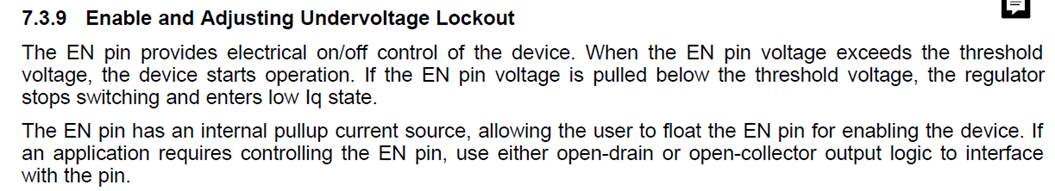

Customer is asking that, for TPS54620, can we pull EN direct to 3.3V to enable IC, or we can only float EN to enable?
Hi Shenhua,
The EN pin can be pulled direct to 3.3V or any voltage that is within the ratings of the pin. It would be good to include a placeholder pull-down resistor from EN to ground and a resistor from the EN pin to the 3.3V signal in case they are needed. A pull-down resistor can be used to help ensure the output is disabled until the 3.3V signal is active.
