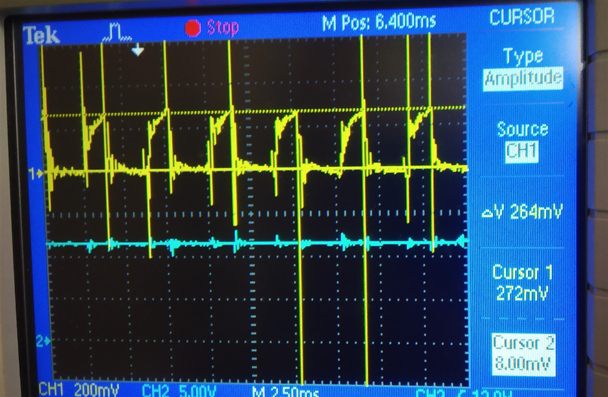

I am using UCC2897A control chip for converting 80-120 V input to 12V output, and a maximum load of 25A. My schematic diagram is shown below: -

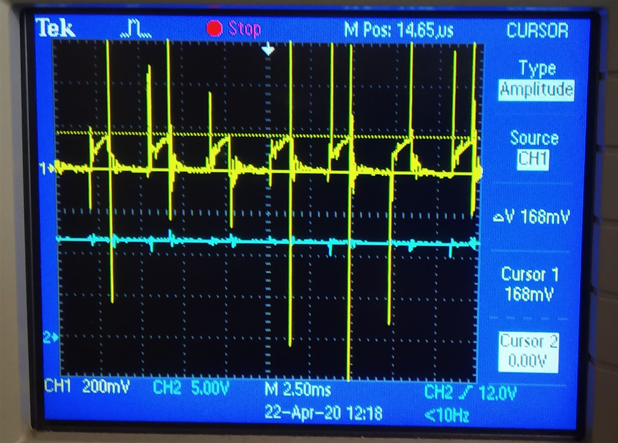

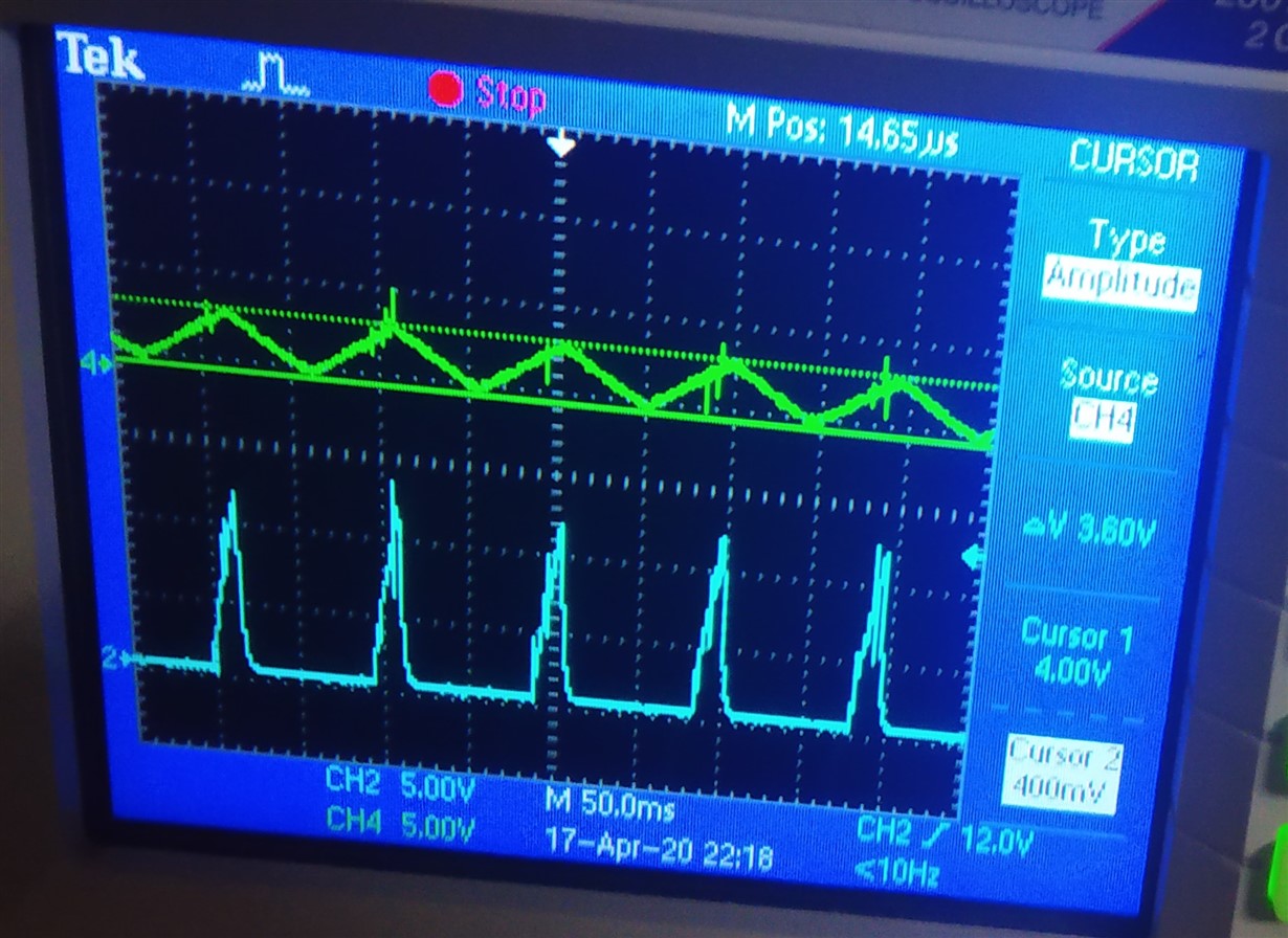

My output is going unstable when I am loading 12A at 120V or 15A at 100V. This is happening because the SS_SD pin is discharging and charging as shown below. (Green is the SS_SD voltage and Blue one is the output)
I am not able to understand why my SS_sd pin is even discharging when VDD pin is stable at 12.8V, Vref is stable at 5V. LINEOV is also in the limit. This is happening at different load condition at different input. (120V input and 12A output or 100V input and 15A output).
Please suggest us with probable reasons for this.
