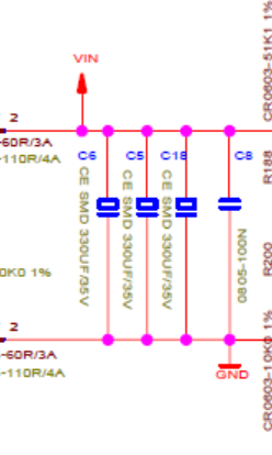

we would like to use the E-Fuse TPS26633 to control the inrush current of the powert supply (Cout). The device is a display, that needs about 0,8A nominal current at 24V. The inrush current can reach 25A during the start up.  We would like to limit it at about 4.5 to 5A. I have tried to calculate the capacitor value and the rising time of the voltage (see below. Texts are in German but you can just understand the equations) for these both current values.

dabei ist C(out) die Gesamtkapazität am Ausgang vom E-Fuse. in unserem Fall C5, C6, C18.
Vin ist die Eingangsspannung vom E-Fuse. In diesem Beispiel : 24V

    thank you for replying. I do not know why the attachment is not working. Is there any special way to attach the file?   But what about my description? I just want to control the inrush current using the TPS26633 IC and the actual value of this insrush current is about 25A. Is it possible with the TPS26633 to regulate it at about 4.5 to 5A. is ti possible ? The the power condensators i would like to charge are 3 x 330UF. Is it possible to set the Inrush current higher than the nominal current of de device?

    You spoke last time about the  the capacitor range to use on the dVdt pin (47nF ...100nF). So that means, the maximum Inrush currrent can only be about 1A as I caculated last time. What about if my device nominal current ist set at 2A for example?  doesn't I need to consider the device nominal current if calculating the Inrush current?
    In the caculation sheet, I also do not understand why the device nominal current cannot be less than the Inrush current.
    What about the surge behavior. We are also scare about that the device can limit the surges and ESD pulses applied on the on it according to the EMC reqirements. I mean due to Ilim setting.
    If I chose for example an Inrush corrent based on 100nF Capacitor (about 470mA) is there any issue if my device nominal current ist still set at 2A ? of course Ilim can be set higher.
    Is the only disadvantage the start up time in this case?
    My idea with the chip is to use the PGOOD output to switch off first the DCDC coverter , when charging the 3*330uF Capacitors and switch on after. So in this case i do not need to consider the device nominal current. What do ou think about it?

    Sorry for the confusion on the design sheet. We may need to rework to make it simple..  The inrush current and the normal operating current are independent.
    No.
    Yes, longer startup time due to 100nF capacitor
    During surge event, the device fast-trips the path due to large currents generated by the surge transient voltages.. but the device recovers quickly and resumes operation in current limit mode. Hence, the recovery time depends on the current limit set point.
    Yes, you don't need to consider device nominal current as the downstream load (DC-DC converter) is enabled using PGOOD signal of the eFuse.
