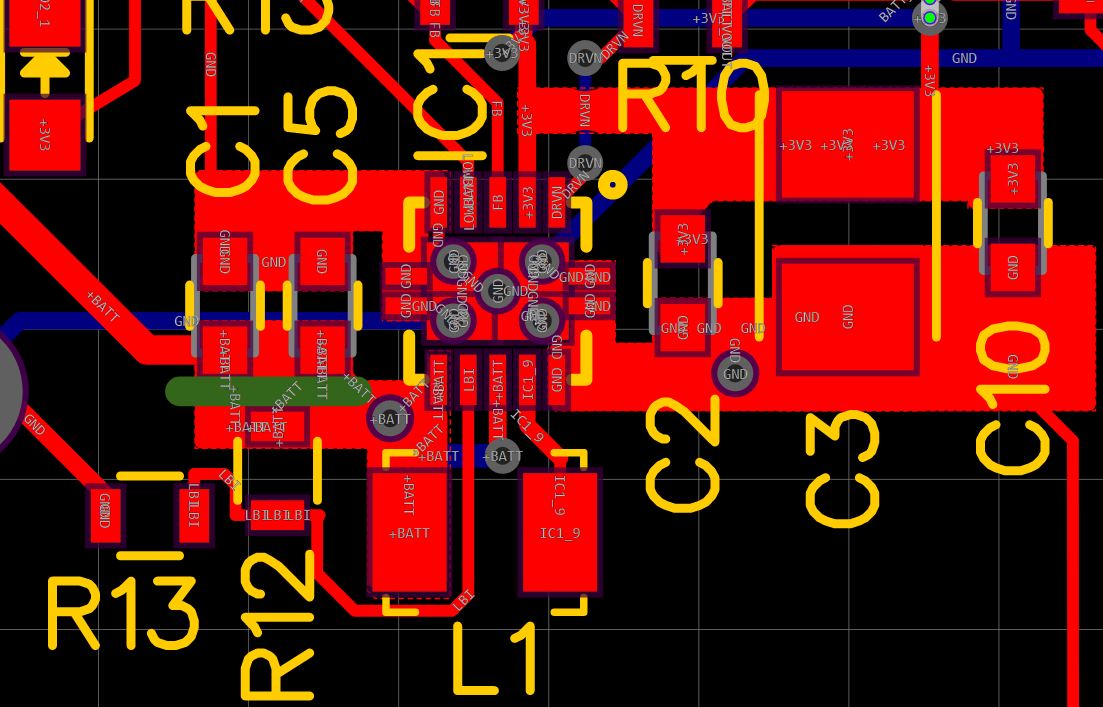

Hi, Iam doing low power board design and just get ~1V output from TPS61025 VOUT pin. C3 is used low ESR Tantalum Capacitor - KEMET T520B107M006ATE040. Where can be issue ?
Schematic_ESP8266 low power board Sensor_2020-05-11_08-20-55.pdf

Hi Egis,
the layout is too bad, i would suggest to improve the layout according http://www.ti.com/lit/an/slva773/slva773.pdf?&ts=1589245399494
is the IC damaged? you could measure the input current and pins to GND impedance to check that

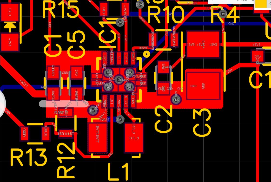

Hi Egis:
Yes, the FB should be float for fixed version.
And the layout is much better now.
