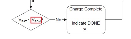

>2. If the part dips below the recharge threshold, the charger will return to the start of the flow.
Does this recharge threshold mean VOREG-VRCH ?
In the case of VRCH, it means that it will not be recharged until the battery voltage drops to 0.1V, so they thought that over-discharging would shorten the battery life.

  • Koji-san,
    As shown in the bottom of the flow, when VBAT>VRCH, charge is complete and the charger stays in the flow there. When VBAT<VRCH, Battery Absent is indicated and the part returns to the beginning of the flow. As stated earlier, what is meant by dipping below VRCH is dropping a value of 100 mV/cell below the regulation voltage of the battery. Again, for a one-cell lithium-ion application with 4.2 V regulation, this would be 4.1 V.
    If you look at the electrical characteristics on page 4 of the datasheet, you will see the VRCH is specified as "Below VOREG." The part will not wait to restart charge below 100 mV as this is very deep into the Battery Short condition, which is lower than 2 V per cell.

  • Koji-san,
    The last decision block in the Operational Flow Chart checks to see if VBAT<VRCH (in this case VBAT< 4.1 V). If this is the case, then the charger will indicate battery absent and return to the start of the flow following the block diagram.
    Mike Emanuel

  • Hi Mike-san
    I understood the following from your answer above.
    VRCH(red frame) in the image below represents 4.1V.
    From your previous answer VOREG = 4.2V, VRCH = 0.1V.
    VOREG-VRCH = 4.1V
    When VBAT becomes less than 4.1V, it returns to the beginning of FLOW.
    Is this understanding correct ?
    Koji Hayashi
  • Koji-san,
    Yes that is correct.
