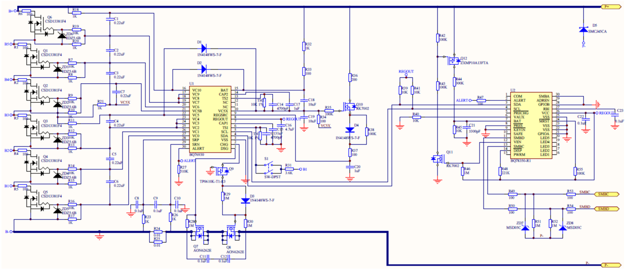

We use BQ76930 with Li-Ion cells in 6S1P configuration. We have the problem that we can't charge the battery anymore when it has reached the final discharge voltage and in addition to that is still connected to the load of ~3 mA for about 24h. The FuelGauge also does not respond in case of an error. There is a button in the circuit which goes to the TS1 pin of the battery monitor. If this is pressed, the charging and the communication works again. The cell voltages are about 3 V in case of an error.
I do not have the chemistry file from our supplier yet.
It seems as if one of the chips is in shutdown mode and only wakes up by pressing the button. Is it possible to configure the chip in such a way that it allows charging in general if a charging voltage is offered.

    We set CUV to 2500 mV threshold and recovery to 3000 mV and thought device will go at this range in sleep mode and FETs will switch off and periodically the BQ wakes up in order to check charger has been attached. Problem: If the charger is attached (BQ24610) and battery is in shutdown mode we can’t even charge the battery. The reset button is on the BMS PCB and not accessible from outside of our device. Our device needs when its running 300 mA and in off state still ~ 2 – 3 mA from the accupack. Furthermore our device has a huge 6 – 7 A peak current at the beginning within 10 ms and if battery periodically switch on the FETs in sleep mode the cell will get exhausted after a while and during the current peak cell voltage will decrease to 1750 mv and chip will go in shutdown mode. Do you have any idea how to fix?

    I am wondering why I measure still voltage @sleep mode coming from the battery pack. I measure 7.3 V which means battery is still serving power to our device which triggers to shutdown. Did you have an look on our schematic where could it come from?

    However we still measure current into our device in sleep mode which means we still loosing power and at the end we reach the treshold for entering shotdown. When we measure volatage at sleep mode we see 4,6 V on the pack P+ P-  and if we measure between b+ b- we measure 12,9 V. Is this normal?
  • Hi Ingmar,
    The current should be very low. CHG should pull down with 1M at R29 and 1M at R30, so the load at 12.9V should be around 4.3 uA.
    Maybe there is discharge through SMBC and SMBD. Can you try removing ZD7, ZD8, R51, and R52 to see if the Shutdown issue goes away? When the FETs open, it cuts the GND connection between the host and the BQ78350.
    Some application use high-side FETs (using the BQ76200 high-side FET driver) for this reason if they still need to communicate with the PACK when the FETs are open. Some applications use an isolation on the SMBus instead.
    Matt

    If the device is going into a state where the boot switch needs to be toggled to communicate, it means the device has gone into Shutdown which means the battery has drained to a very low level. There must be a current path that is pulling current from the battery when the FETs are opened. Can you try removing ZD7, ZD8, R51, and R52 to see if it eliminates the issue?
    If you lose communication because of the CUV, then connecting the battery to a charger should help to recover since the CHG FET should close once the cells are above the recovery threshold or charging is detected (there is a CUV_RECOV_CHG bit that determines this behavior). However, if the device reaches the Shutdown voltage, the BQ78350 is completely power off and only the Boot switch can cause the BQ769x0 to bring back power to the BQ78350.
    Matt
  • Hi Matt,
    Ingmar did remove the components you suggested, but still current is able to flow. The product is able to draw 3mA from the battery pack once it enters CUV. As there is no way of disconnecting the load, the battery eventually reaches the Shutdown level, as you also say.
    With the action of CUV, the discharge FET should open, but it does not. The discharge FET should stay open until the CUVR threshold is reached and the  XDSG bit should indicate this like in the BQ40z50. Is there another setting which is stopping this?

    Since you lose communication when CUV occurs, I suspect the issue is the ground connection. When the FETs open, they will lost the ground connection between the host and the BQ78350 which is why you see the loss of communication. This can be solved by using an isolator on the SMBus or by using high-side FETs (there is a BQ76200 high-side FET driver that many applications use).

    Thank you for your comments. For new designs, we will surely look at the information you have provided as now we know what we are looking for, but as this is a design that is already in a product, we just wanted to put a fix using the firmware settings.
    Does this means the discharge FET cannot be switched off with the hardware we have?
    Zahid
  • Hi Zahid,
    I don’t know what would prevent the discharge FET from opening. If the communications are referenced to PACK- there will be continued discharge through the comm protection circuit and/or the IC substrate. The charger can maintain a voltage and allow communication.
