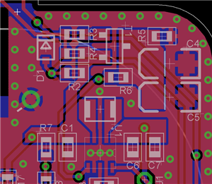

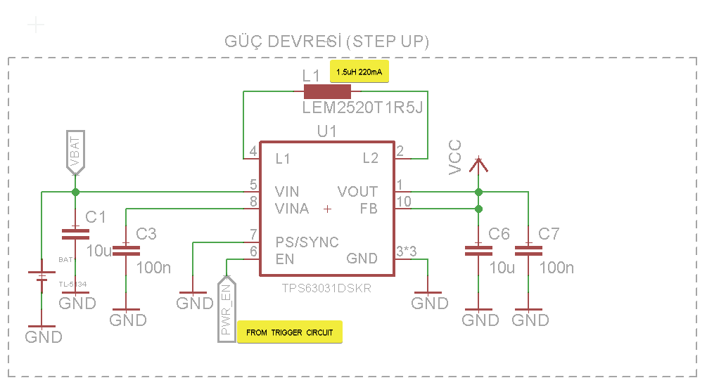

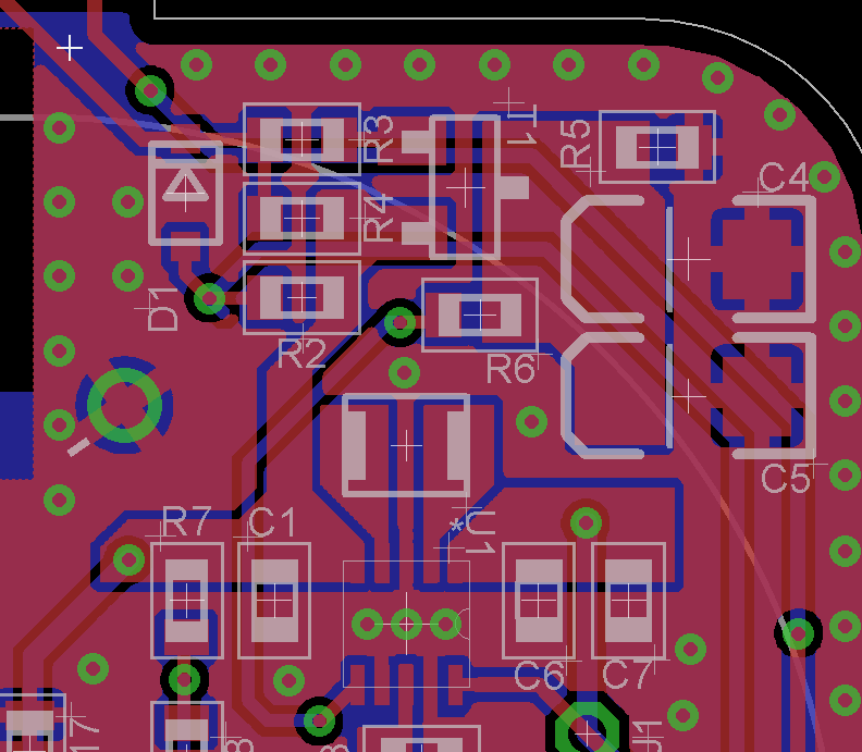

I have an issue about quiescent durrent. I already discussed this topic here. Then I decided to re-design the PCB properly as same as the suggested design. But the problem hasn't been resolved yet. Please help me what is wrong?
Hi Salih,
I guessed you should removed all the external components except the input capacitor, output capacitor and inductor for the buck-boost, correct? make sure all the current is caused by the buck-boost circuit
if yes, please follow https://www.ti.com/lit/an/slva828/slva828.pdf?&ts=1589761823293 to setup the bench for current measurement. it is for boost, but the principle is the same as buck-boost. make sure the VIN and VOUT are stable before measuring the current.
Thanks very much Jasper.
I don't know how mega-ohms on trigger circuit cause >300uA consumption but it happened. I removed all components except Cin, Cout and L components. The quiescent current has been dropped down below 50uA.
I added MCU and other ICs and also I can see that whole circuit consumes around 70uA in sleep mode. That is better than I aimed.
