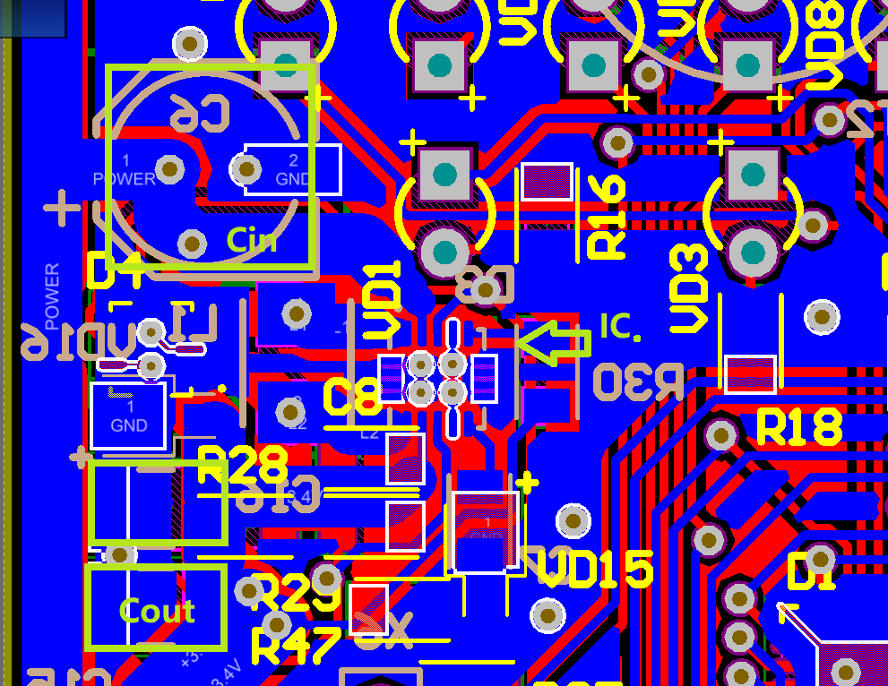

We have encountered this problem for the first time since the production of this project in 2013. We feel very confused. The schematic diagram can be provided!
We have been producing this machine since 2013 and we have never had such a problem!Besides, during the test, the abnormal machine can work normally by replacing this IC. Therefore, our preliminary analysis is that the IC function is abnormal!

When Vin=5.7-7.6V , Vo=3.4V, it works in the buck mode, I noticed there's a 100uF cap C6 at the input side, Is this an EL cap? what is the ESR of it.
By the way, could you please also share your pcb layout with us?
HI: Sir
C6 bit is a patch aluminum electrolytic capacitor, its specification is: 100UF/16V 6.3*5.4mm ±20%
:The attachment is PCB design information

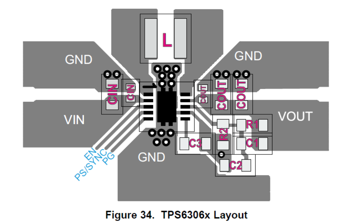

Be noted that the input cap should be placed very close to the Vin pin and the GND pin. the output ceramic cap should be placed very close to the Vout pin and the GND pin. Put as many vias as possible at the GND net of the input and output caps, so that the high frequency AC current can go back to the silicon's PGND with a lowest impedance. The feedback network should be connected to the AGND. The AGND and the PGND should be single point connected.

I checked the pcb layout. the layout is strange. both the input cap and the output cap is far away from the IC. See below picture: The input loop and the out loop are both critical loops. Big loop area may cause malfunction of the IC because of the big noise. I also checked the chance of connect the input caps and output caps near the IC, but seems no adjacent GND near the IC.
Please check on their real board whether place a 0603/1uF cap across the IC's Vin pin to PGND pin, Vout pin to PGND is possible. If can't place the small ceramic cap across the pin, then they have to re-layout the pcb board according to the layout suggestion on the datasheet.

"The TI engineer gave his recommendations .... but he did not answer the question of why the board works fine when powered up to 6 V.
There is grounding under the IC, it is made on the red layer, where the earth test ground is also located.
The increasing in noise level and malfunction due to this, due to the far capacitors located far from the IC,
we would see during the operation of the motor, because at this time we have the largest consumption and noise from the motor.
But this is not noticed.
But not switching on from a voltage of more than 6 V. is exist. The engineer at TI said nothing about this."
