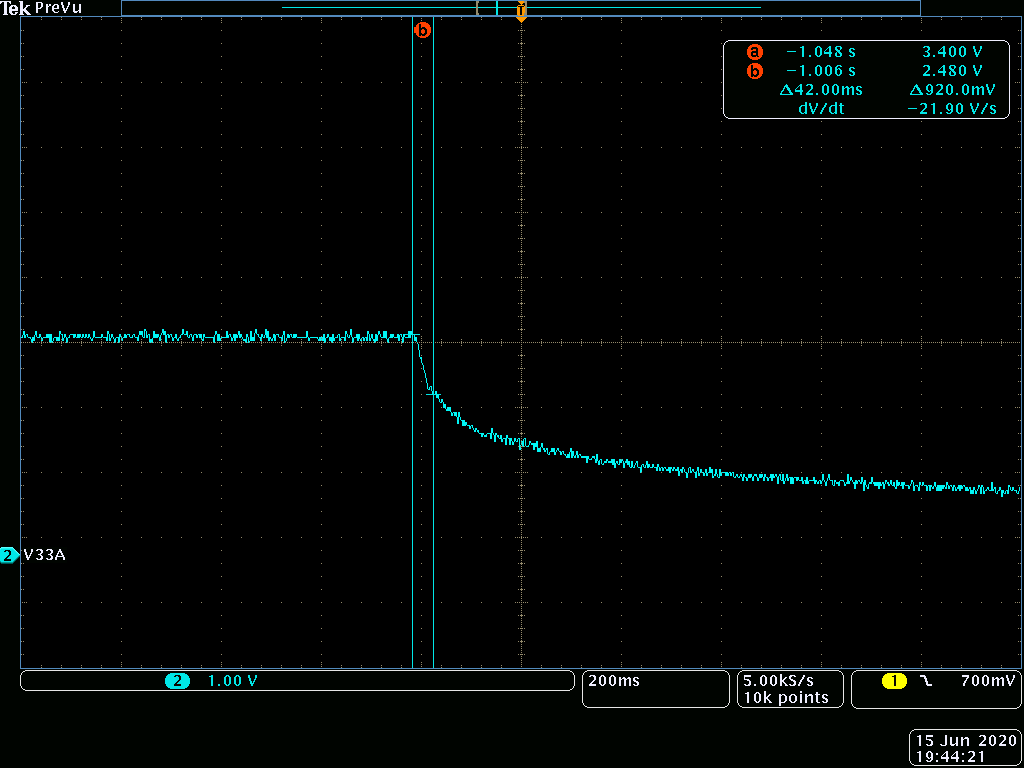

  • Hi Yihe,
    Could you help to review our brownout circuit as attached pdf file ? I also uploaded the waveform of P33A for checking the power volatge can maintain power voltage 2.5V at least 43ms after power off.

  • Hello
    What's the output voltage of U14? Please be noted that there would be a forward voltage on the diode. if you have a brownout circuit, the input voltage to the diode would be 3.6 instead of 3.3V.  But brownout shall not change the fault type. The brownout is to maintain at least 5ms between 2.9V and 2.6V. Please check this.
    In the previous post, you mentioned that BMC polling introduced those extra faults. Now, without launching GUI , it introduced extra fault. Do you still have BMC poll without GUI. This does not make sense for me. if there is a signal integrity issue on the I2C, without launching GUI shall make problem go away if BMC does not poll.
    Have your tried the security mode? have your dump the setting to confirm that the OV thresholds are changed indeed?
