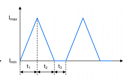

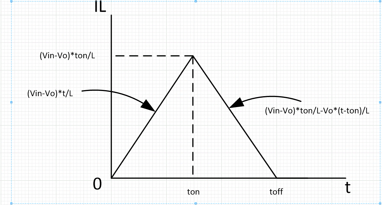

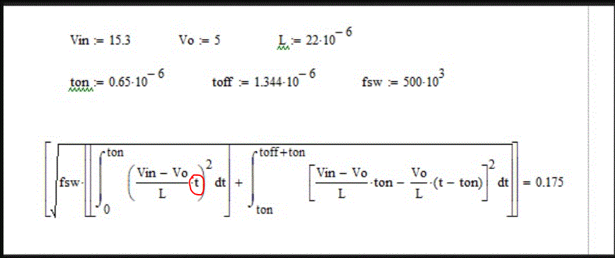

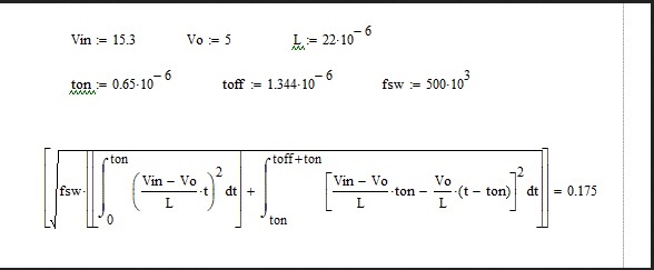

Hello! You wrote that <t> is the time that changes in time, tell me what number to substitute in the formula? I have looked at the design guide of authors Markus Zehendner, Matthias Ulmann, section step-down converters. There are three parameters <t1>, <t2>, <t3>. What is <t> equal to?
