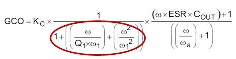

    I calculate the pole/zero following the datasheet. Can you please check whether I'm on the right track?
    Q1.
    Equation above is the control-to-output gain from DS. The denominator highlighted in red looks like Complex Conjugate Pole of the LC Output Filter, so w1 (pole) would be as below.
    But I found the equation for this pole was shown differently in DS as below.
    Can you advise which one is right?

  • Hi Kim,
    1. Omega1 = pi / Ton
    2. You can design the zero close to fo without issue, but for the high frequency pole, please move it around the switching frequency, if it is at low frequency, you will get lower bandwidth and harm the transient performance.

  • Hi Chasel,
    Thank you so much for your time! Could you please answer for my last question?
    Regarding your answer 1, how do I get Q1 then? I thought it was Q factor of output filter with Omega0 as below, but you told me Omega1 is correct, how can I calculate Q1?

  • Hi Minkyung,
    Usually there is mismatch between calculation and measurement due to component variation, board parasitic and etc.
    I would suggest to tune compensation with bench test.
