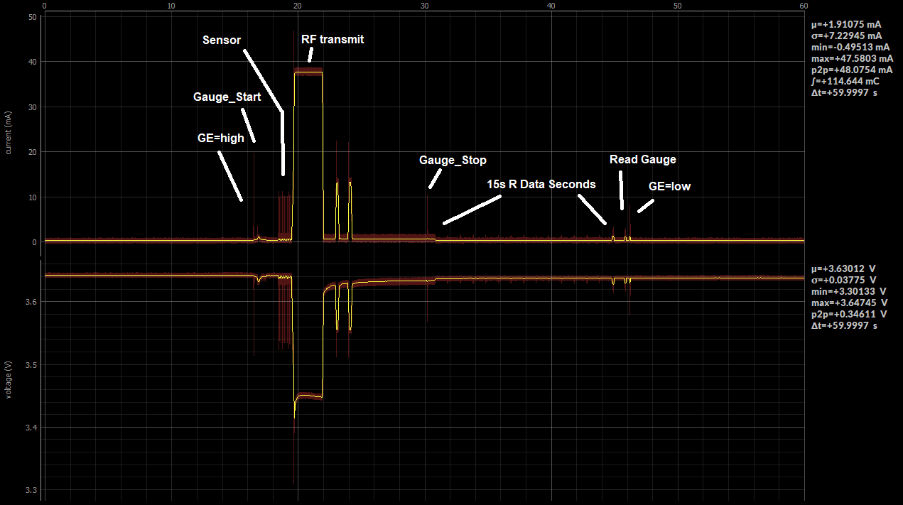

I have a Lithium Thionyl Chloride (Li-SOCl2) battery connected to my IoT device in development and use the BQ35100EVM. When I start my measurements of the day I connect the battery. Since the firmware is newly started it initializes the BQ35100:
  • make GE high
  • wait 2 seconds
  • Read the version of the data flash
    • unseal
    • read data flash version
    • seal
  • Send New Battery command. So the health is set at 100%
  • wait 2 seconds
  • make GE low
The firmware wakes up every 1 minute:
  • wake up
  • make GE high
  • wait 2 seconds
  • Send Gauge Start command
  • Check the GA control status bit every 100ms, and sleep in between. After about 1.5s to 2s the GA bit is set.
  • Make a measurement and transmits the results, which is a more high power activity (40mA for some time during transmit).
  • Wait for no transmit of receive activity for about 6 seconds.
  • Send Gauge Stop command
  • Wait for 16 seconds (since 'R Data Seconds' is set to 15 seconds).
  • Read the Voltage, Temperature and State of Health.
  • make GE low
The health (SOH) start at 100% and decreases with 2% (default max delta) with every wakeup until it reaches 0%. But the battery is not dead yet.
How do I measure the real SOH of the Lithium Thionyl Chloride? Or is the gauge measurement incorrectly performed?
BTW. I use a Tadiran SL2780/T. I specified the EVE ER34615T to the purchase department, but they provided the Tadiran. So I use the ER34615T chemistry since the SL2780 is not listed but has the same specs.

    Okay, but how to resolve this and where and how should I change the firmware to let the gauge take valid measurements?
    The following is the current and voltage measured by a Joulescope JS110, which is placed in between the battery and the BQ35100EVM. The load is high enough to let the voltage drop more than 100mV.
    What is wrong with the timing here? How long should the time between GE=high and GAUGE_START be? Or the time between GAUGE_STOP, the read of the Gauge values (Voltage, Temperature, SOH) and GE=low?
    Which BQ35100 register should I read to know it has taken correct OCV and Z value measurements?
    And what is the minimum cycle time in which the sensor readout and RF transmit should be performed to let the BQ35100 take a valid measurement? One minute is too short, but what should it be?
    Do I understand it correctly: To relax the current state of the BQ35100 it should be connected to the battery, with no load, and  with GE=low for at least 5 hours (according to the BQ5100 Technical Reference Manual section 7.5 'Battery EOS OCV BAD Warning')?
    Rene

    There are no large capacitors connected. The previously shown image shows there is even more than a 100mV drop (see Jun 17, 2020 7:51 AM).
    Section 8.2.2.6 of the datasheet states:
    "The BQ35100 device is designed to work in a system where there is a period discharge pulse of at least 10 s of mA for 10 s of ms."
    Which is btw a strange sentance with "...at least 10 s of mA for 10 s of ms.". The image of my current and voltage measurements shows the discharge pulse is at about 37mA max but only for 2 seconds. The total GE=high time and the time between GAUGE_START and GAUGE_STOP is however more than 10 seconds.
