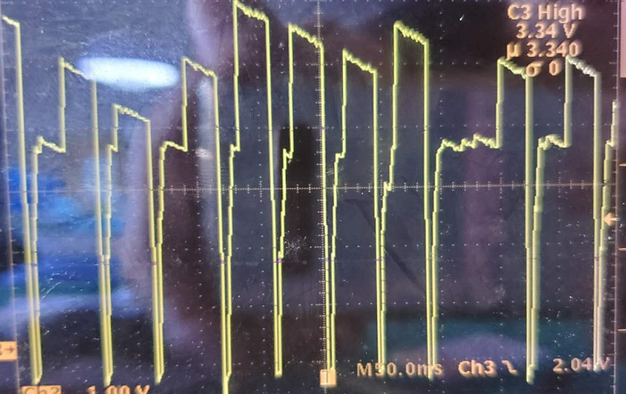

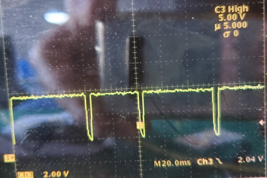

   Our own LM25141 PCB is setting work at 2.2.MHz switching frequency and 3.3V output,but i measure the VDDA & VCC are dropped about 2V(figure 1),also the Vout looks like unnormal (figure 2),could you point at what the problem for me?

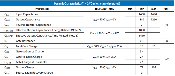

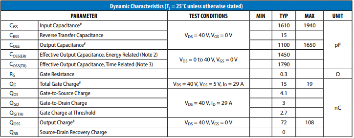

        1,I used the GaN FET,pls look at the parameters in figure below(first is HS and second isLS):

  • Hi
    have you tried external VCC and can you share the schematic and PCB layout?
    One thing you also can check is that you can disconnect the GanFET to see whether the  VCC and VDD is right. if it is OK, you may need check EN .
    GanFet has very high dv/dt which may easily interfere the chip's working statues, so it is very hard to predict which function has issue so that we may need schematic and PCB layout.

  • Hi Daniel,
        When i disconnect the GanFET the VCC and VDDA are output 5V normally.

  • Hi
    For Ganfet application, recommend 4 layer PCB for better noise immunity.  and 2 layers layout is not good .
    1. As our datasheet suggested: Keep the high-current paths short, in your layout the CIN+->Q1->Q2->CIN- parth is too long especially Q2 GND->CIN GND which will have large inductance on the ground make the ground very noisy when Q1 turn on and off.
    2. your AND use R16 connect to PGND, but you choose a very noisy PGND around the Q2 Souce.
    3.the current sense trace routing is wrong, you should use Kelvin connection way
    I think you need a PCB change .
