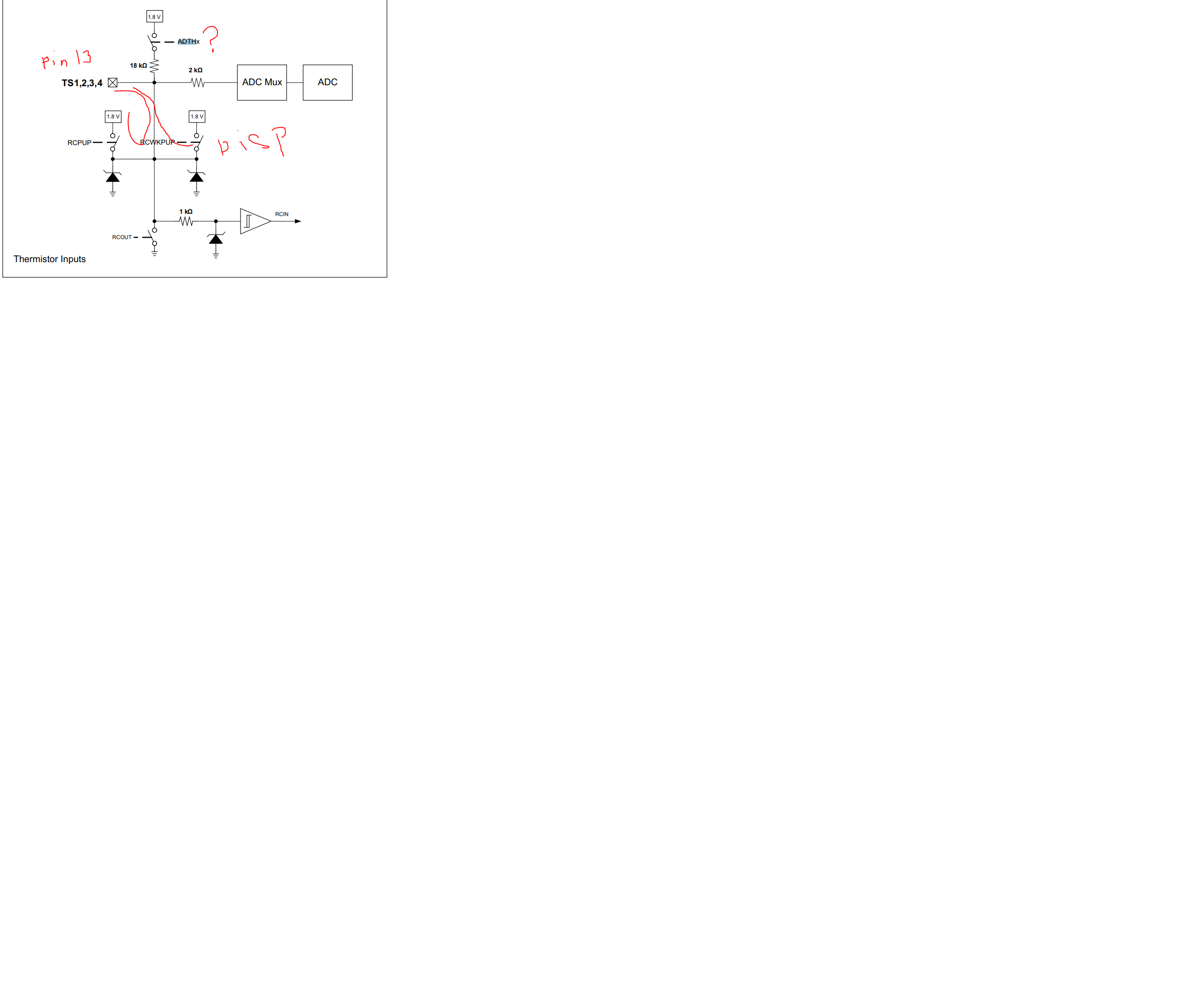

  • I cant find anything information about ADTH , RCPUP, RCWKUP
    It seems to me that in the mode [MFP13_SEL0] [MFP13_SEL1] [MFP13_SEL2] = 000,
    instead of enabling ADTH, one of the keys below is turned on.
    Since in GPIO mode the pin is functioning.

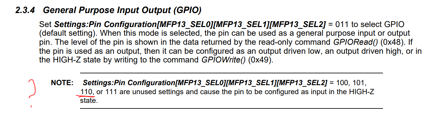

    ATTENTION Another strange point: in Pin Configuration mode [MFP13_SEL0] [MFP13_SEL1] [MFP13_SEL2] = 011
    sending 0x0004 word to register 0x49 do nothing.
    But in Pin Configuration [MFP13_SEL0] [MFP13_SEL1] [MFP13_SEL2] = 110 works and high state and low
    It seems to me. somewhere here an error crept in

    We have been looking into this issue and confirmed there is a bug in the FW, pin 13 is not being pulled through the internal 18-kOhm resistor. We are now working to solve this issue with the FW team and it will be fixed in the next firmware update.
    We would recommend using one of the other multifunction pins for the DISP feature until the new firmware is released.
