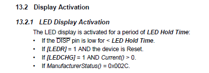

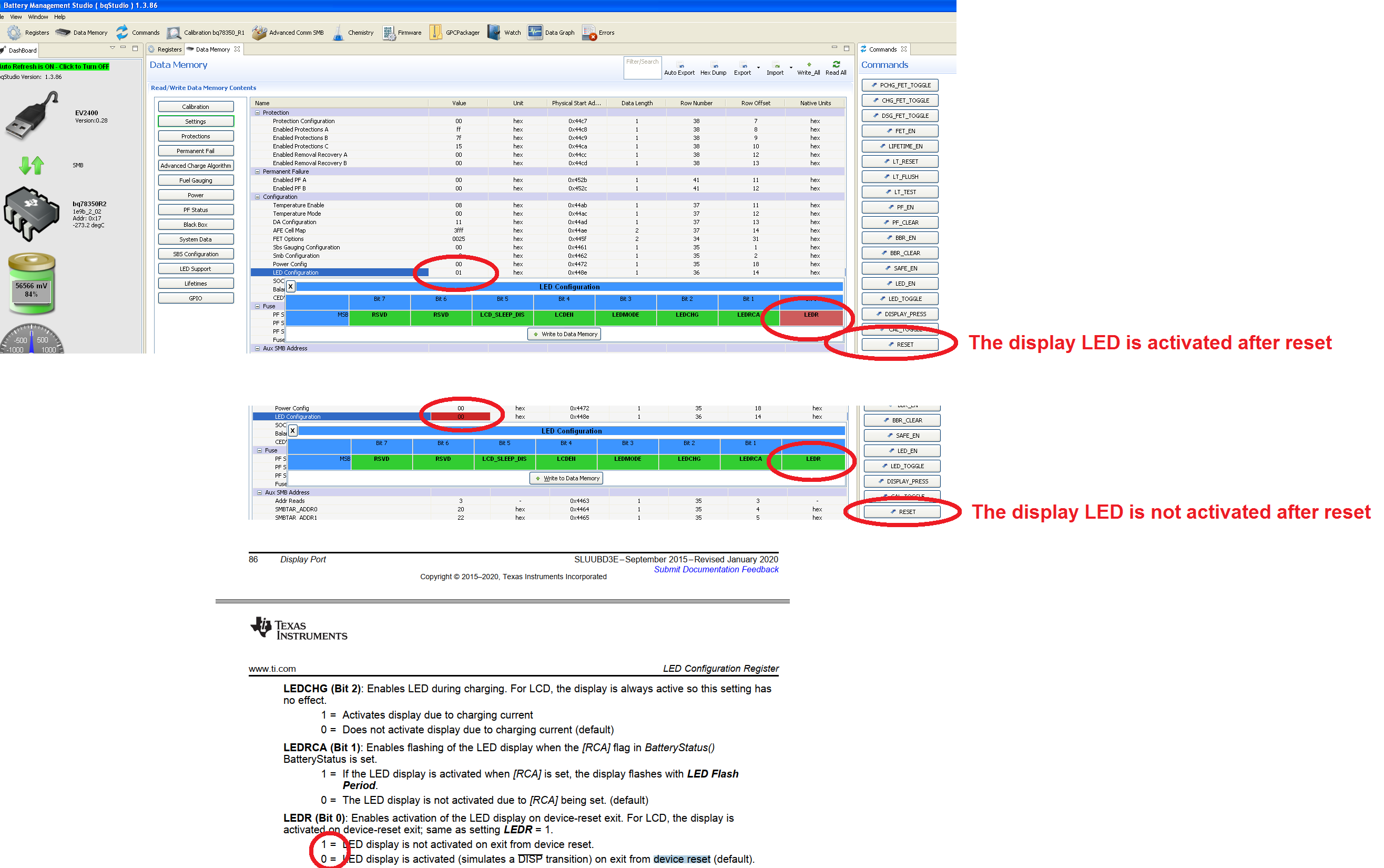

I'm developing a BMS with the BQ78350-R2.
According the datasheet the led display is switch ON autonomously coming from reset, if the flag is set and write previously of course.
It is working BUT in my opinion in a reverse way. I mean this features is set if the LEDR is 1. Have a look to the picture below.
Could you verify if I'm right? Or maybe I'm understanding something wrong.
