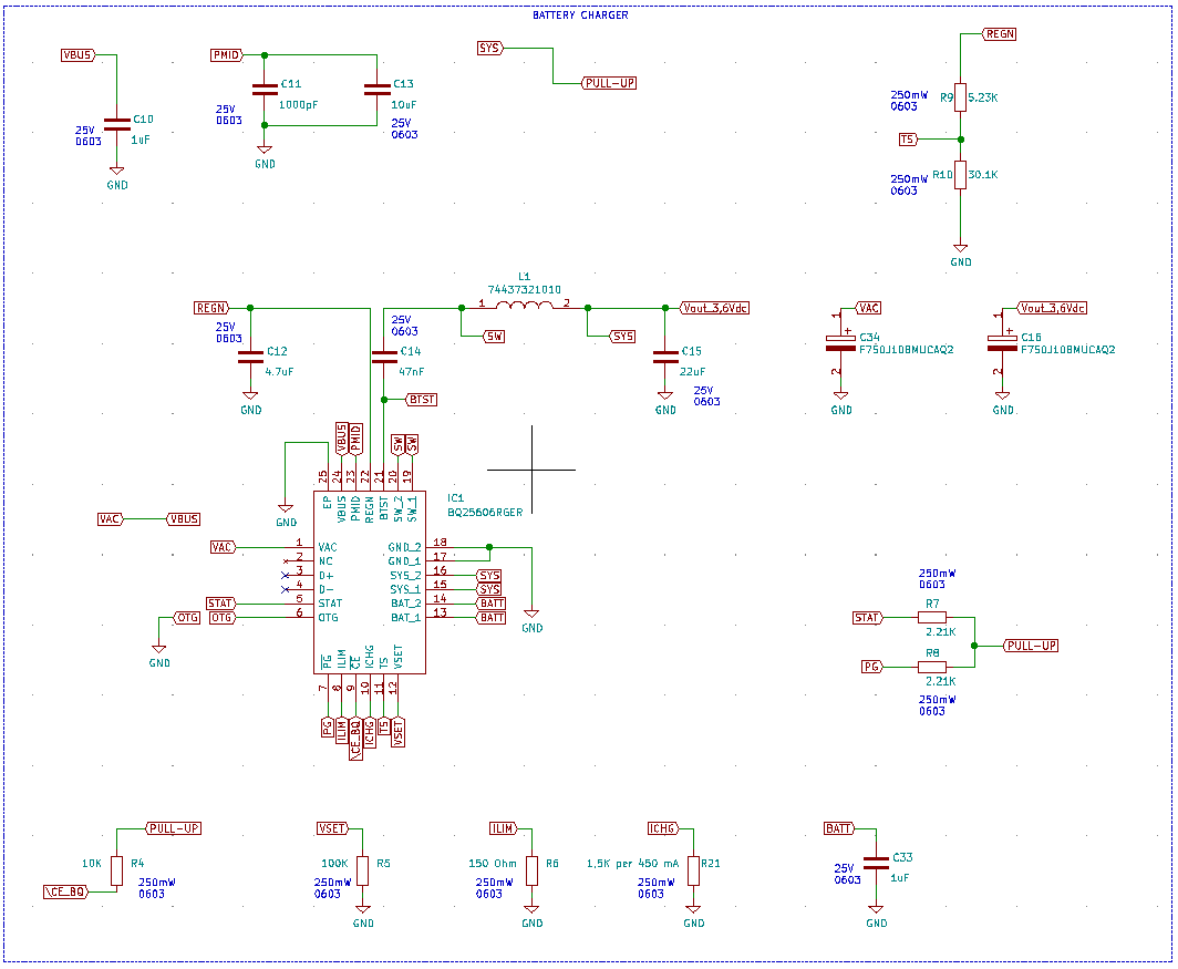

I attach the schematic and photos of the tests done on the Vsys.
From the datasheet, the bq25606 should be able to deliver up to 3 A even in the absence of a battery.
Also, if I measure the SW, I don't see a square wave as per the datasheet.
I'd like to understand where I'm wrong.
Thanks for your help
1273.Schematic BQ25606.pdf

    I describe in more detail how I set up the circuit of the BQ25606 and what I see from the tests I did:
    - /CE at VSYS, via 10k pullup resistor (charge disabling);
    - TS Voltage fixed with voltage divider (R5 5.23K, R6 30.1K);
    - 47nF Capacitor between btst and sw;
    - 1uH inductor 74437321010 Wurth Elektronik (Isat 7.5A);
    - 22uF Capacitor between sw and sys;

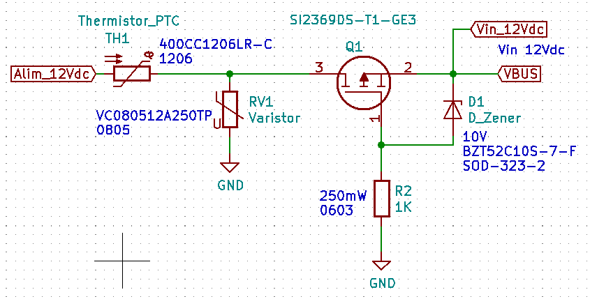

    Specifically, upstream of the BQ25606 I have inserted a protection circuit against voltage inversion and overvoltages, as shown in the figure, which performs its work from tests carried out.
    I noticed that by inserting an electrolytic capacity of 1000uF between the protection circuit and BQ25606 and an electrolytic capacity of 1000uF at the output (at Vsys) the system improves (I now see a drop in voltage at the VBUS, always 1.5 Vdc, but for a period of time about 3 msec).

    What is your input current limit setting (IINDPM)? Please refer to Table 2 Input Current Limit Setting from D+/D– Detection on the d/s for the details.
    Ning.
    The pins D+ and D- aren't connected in my schematic,
    I put a 150 Ohm resistor to gnd at ILIM pin (see schematic)

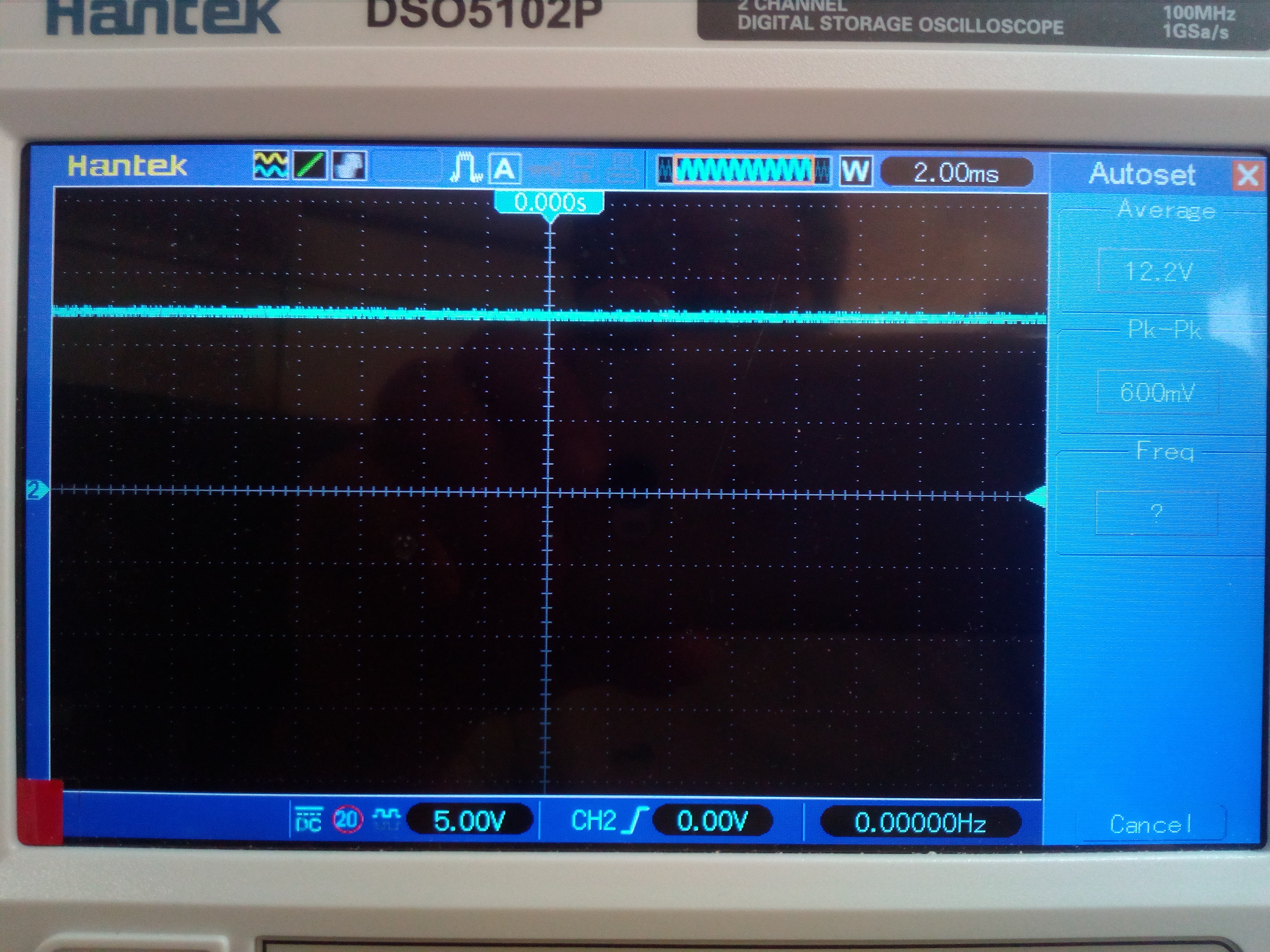

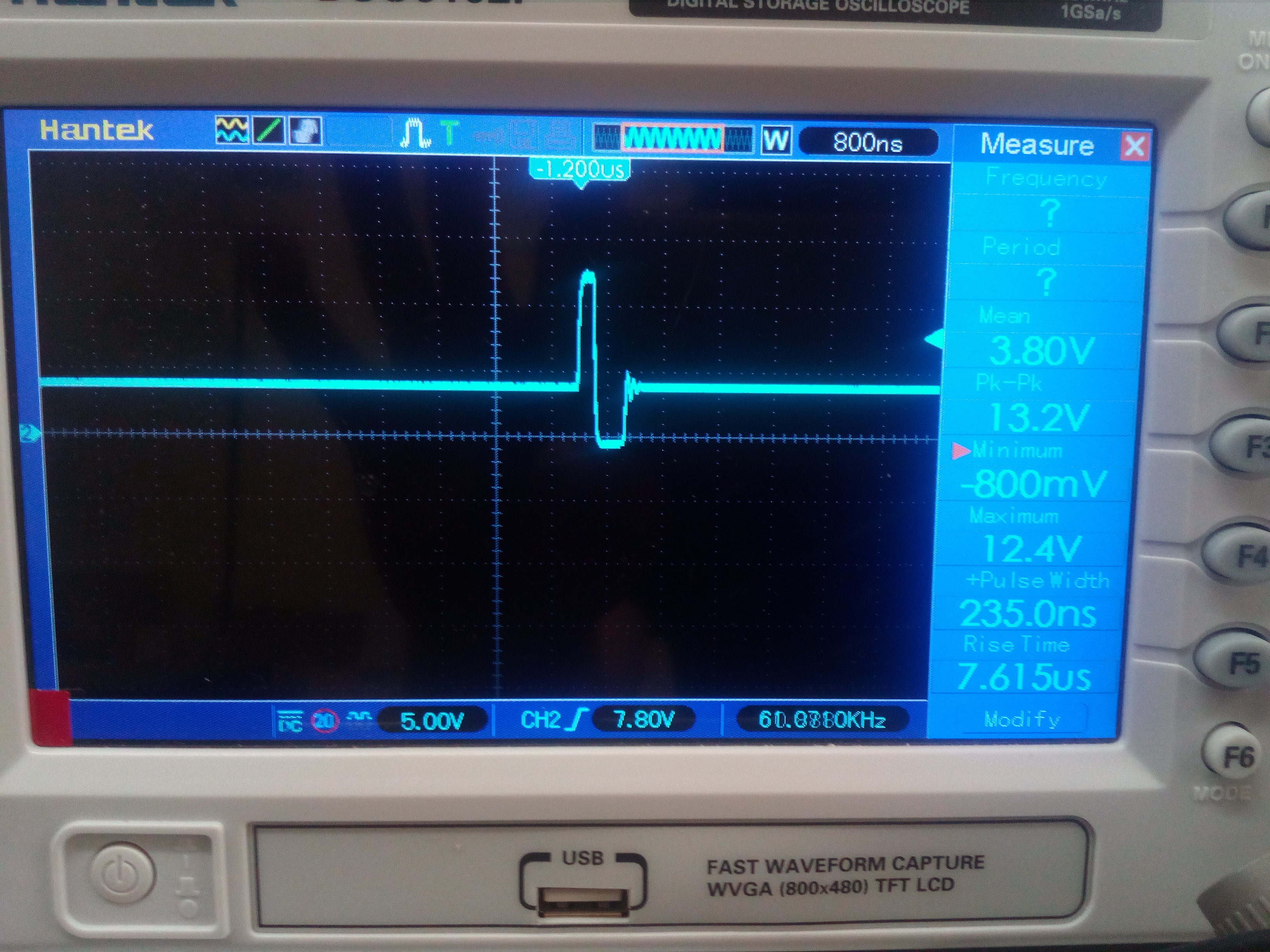

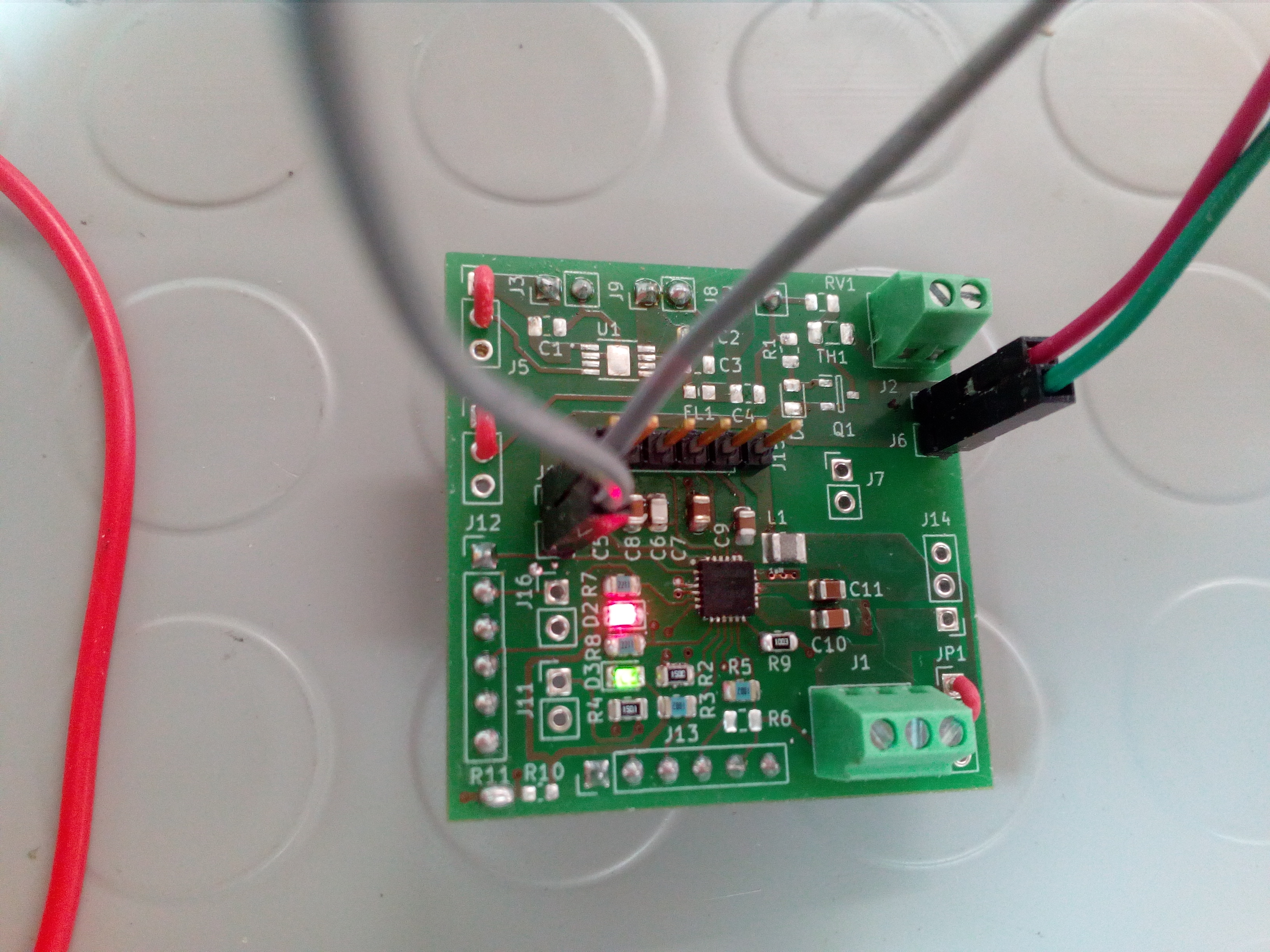

    1) pcb photo, as you can see I have removed all the circuits upstream and downstream of the bq25606. I powered the circuit by Vbus (12.3 Vdc), no load connected and battery not connected. As you can see from the video, the circuit works well.

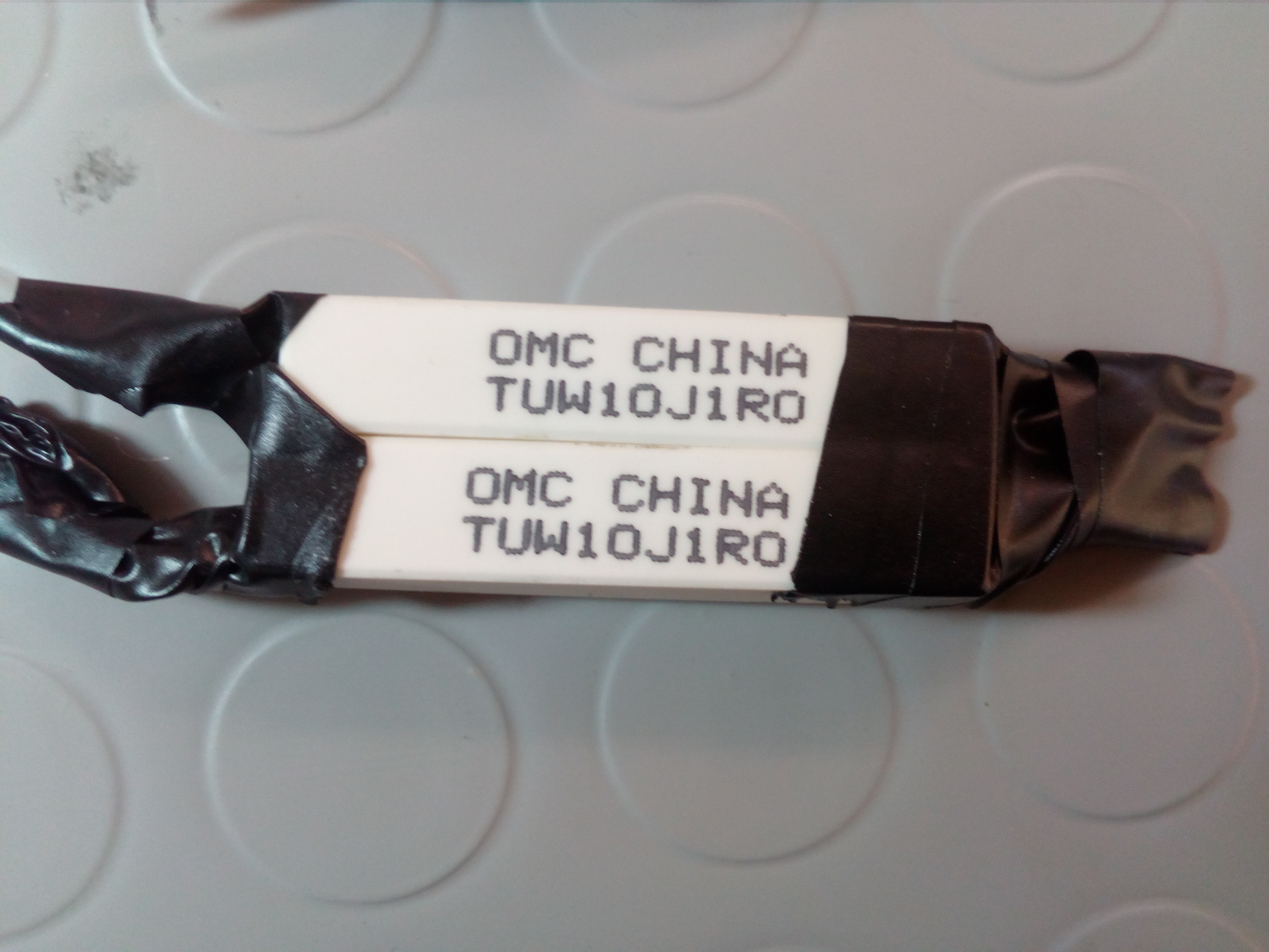

    Now I am going to connect (always without the battery connected) two 1 Ohm resistors in series, which, with a Vsys voltage of 3.68 Vdc, should absorb a current of about 1.84 A:

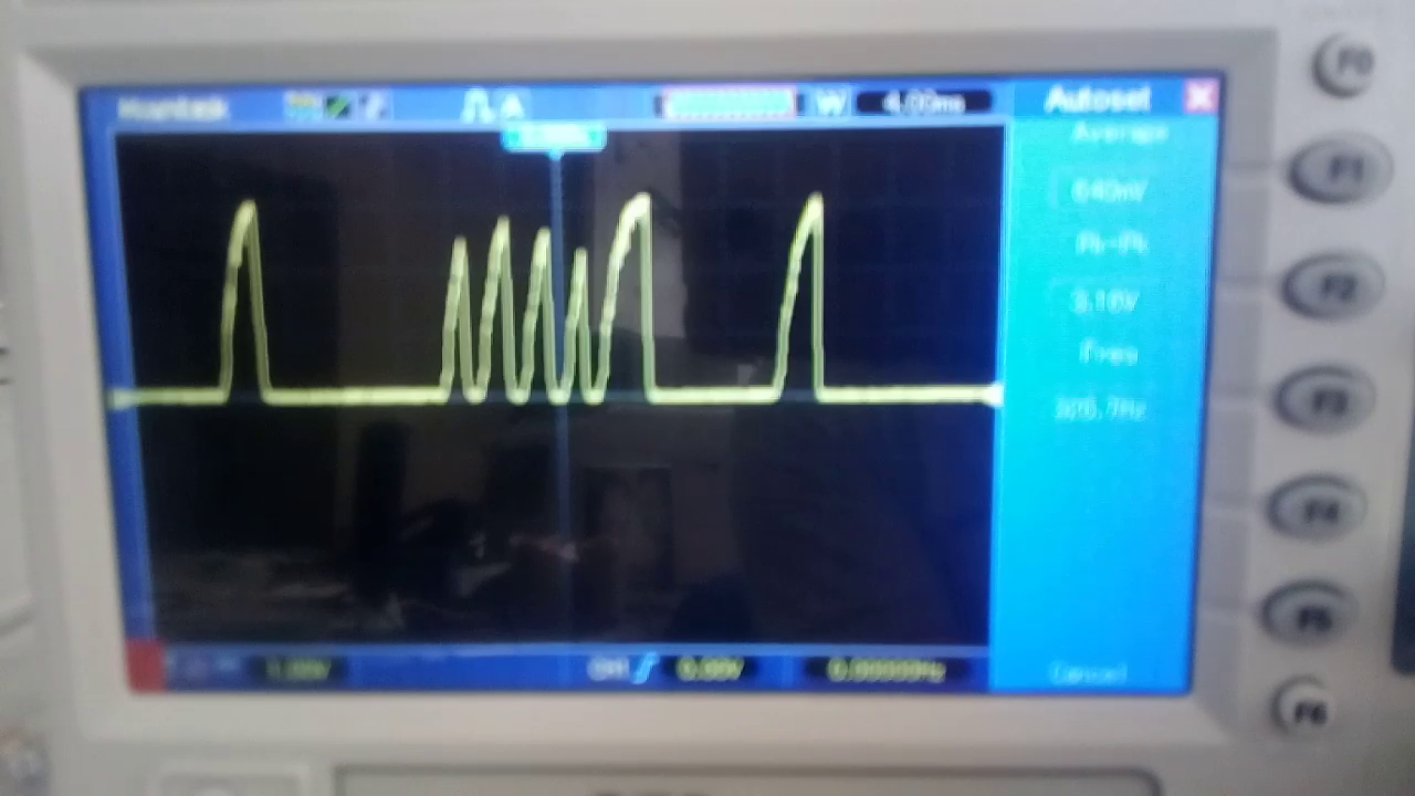

    This is what happens (see the photo and two videos below):
    Vsys:

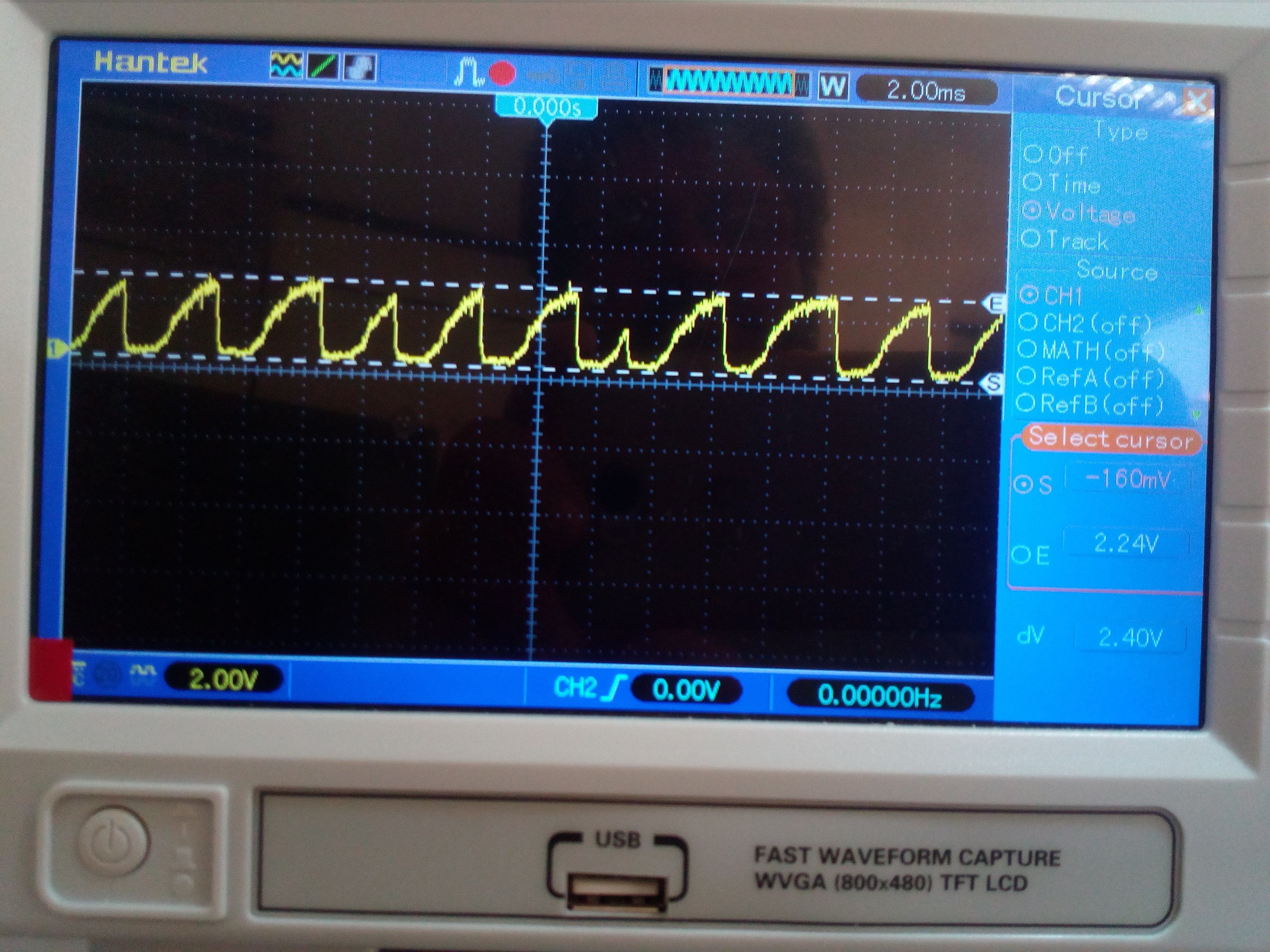

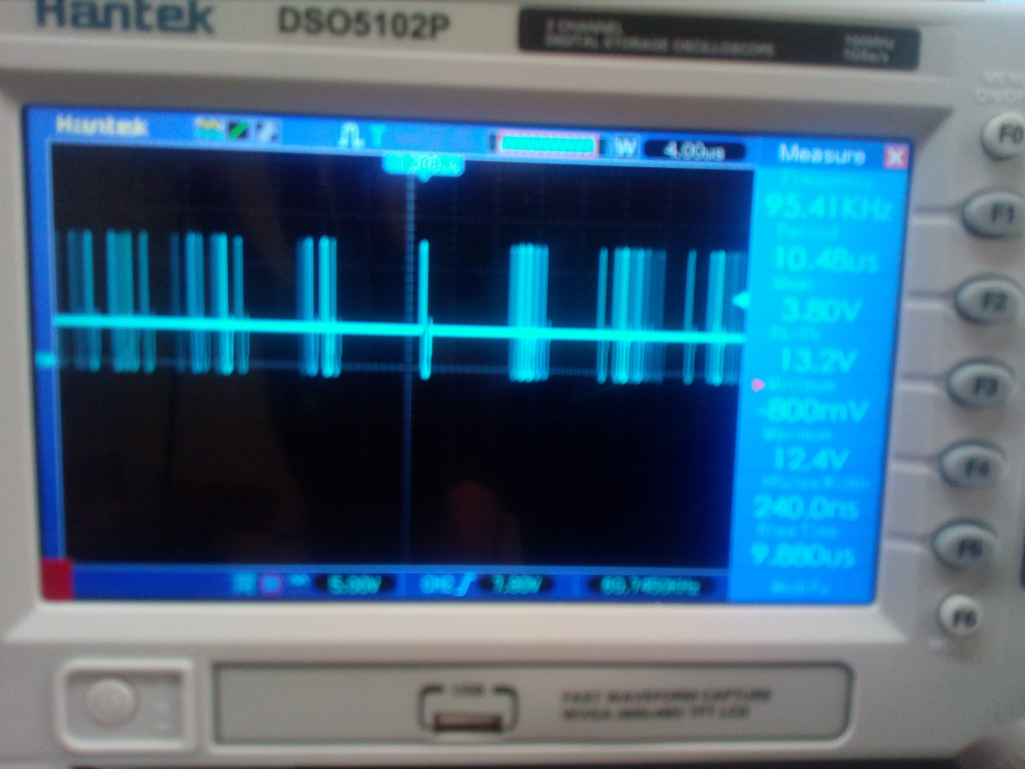

  • This is the video of what I see on the oscilloscope (Vsys), always with the battery not connected:
    Vsys:

    What are your test conditions such as VBAT (voltage at BAT pin), IBAT, VSYS, ISYS? The pictures only show VBUS=12V and IVBUS=20mA. And what are the waveforms?
    Ning.

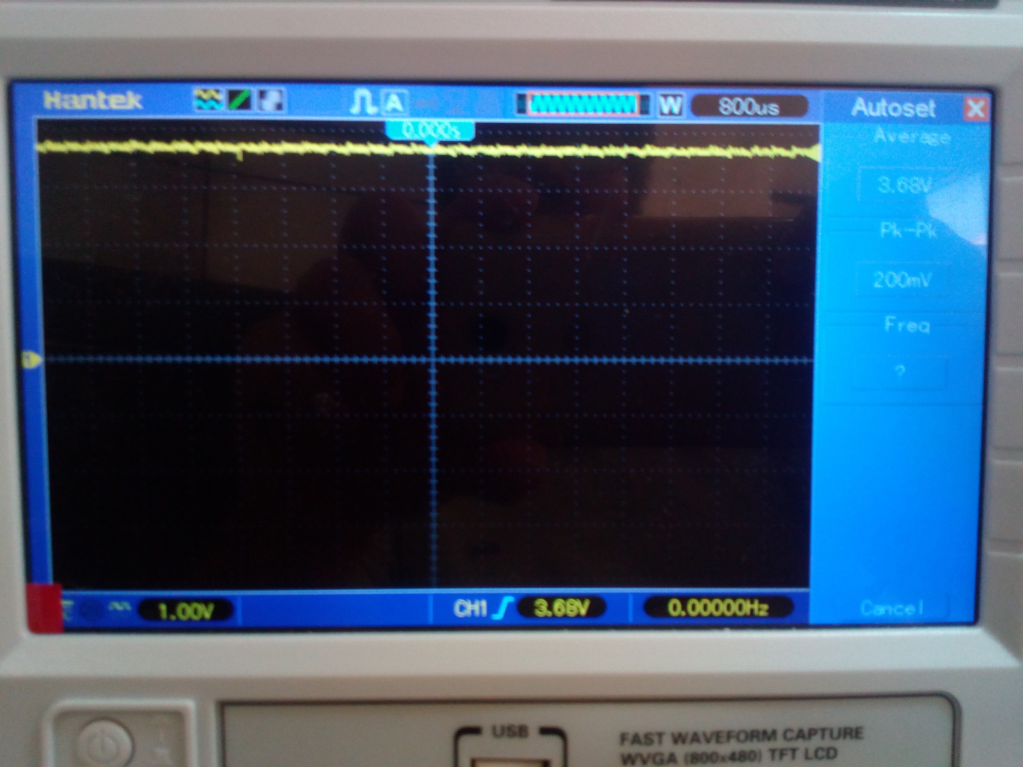

  • Hi Ning,
    Without load:
    Vbus = 12,2 Vdc
    IVbus = 20mA
    Vsys = 3,68 Vdc (like the fourth photo that I inserted)
    Vbat = 0 Vdc (/CE is pulled up to Vsys, recharging is disabled, no battery is connected)
    IVbat = 0 A  (/CE is pulled up to Vsys, recharging is disabled, no battery is connected)
    IVsys = 0 A (no load in connected)
     With load: (2 Ohm 10 Watt):

    You mentioned Vsys = 3,68 Vdc , SYS load: (2 Ohm 10 Watt). Why Isys is only ~0.27A?
    Ning.
  • Hi Ning,

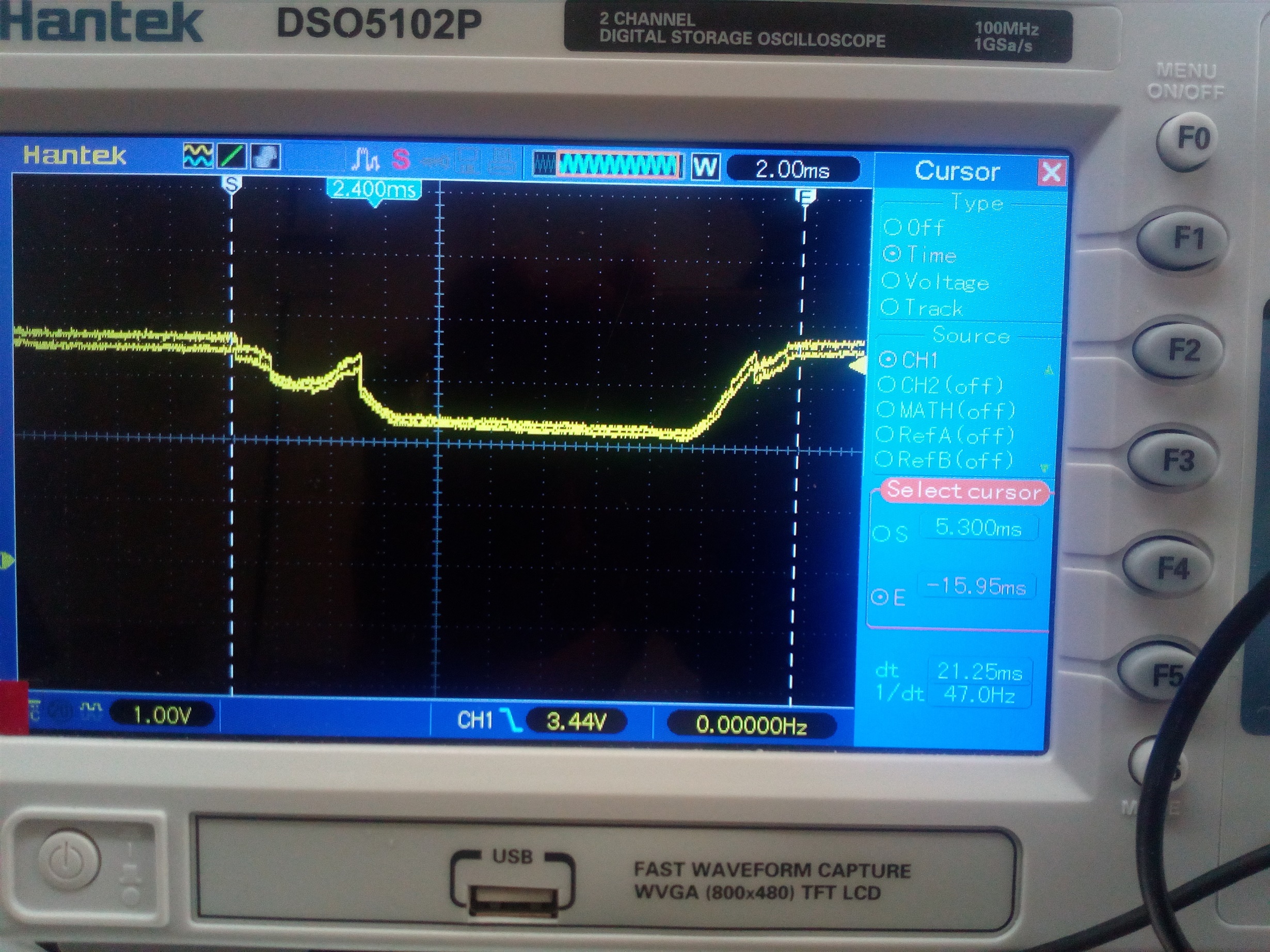

    No, I see Vsys at 3,68 Vdc only when there is no load (2 Ohm 10 Watt) connected, and so I can see Vsys= 3,68 Vdc , Ivsys= 0A (it's all right);
    When i connect the load, I see this waveform (Vsys):
    See this video (Vsys):
    And so Ivsys= 0,27A
    This is the problem, The BQ25606  cannot supply, with this load, 3.68 Vdc and 2 A currents ( if no battery is connected)
