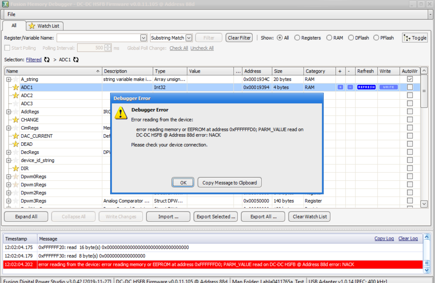

    I also have a issue that some of values I defined are not showing in the memory debugger and when I updated one variable, it worked fine. But when I clicked updated for all register, the memory reading error came as the figure showed. I have tried lab 1 and it gave the same error.

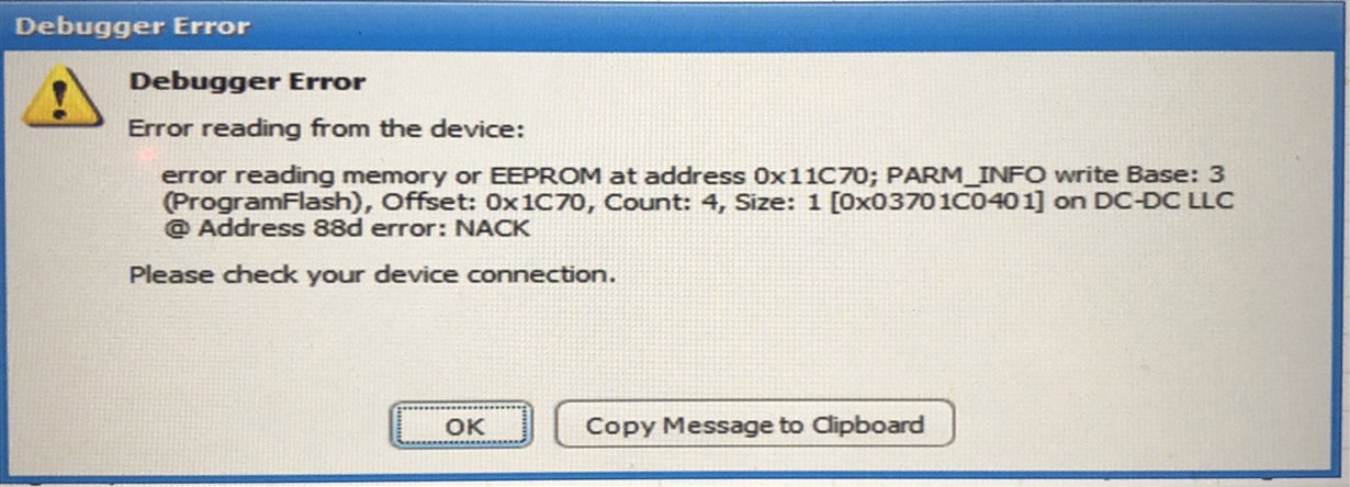

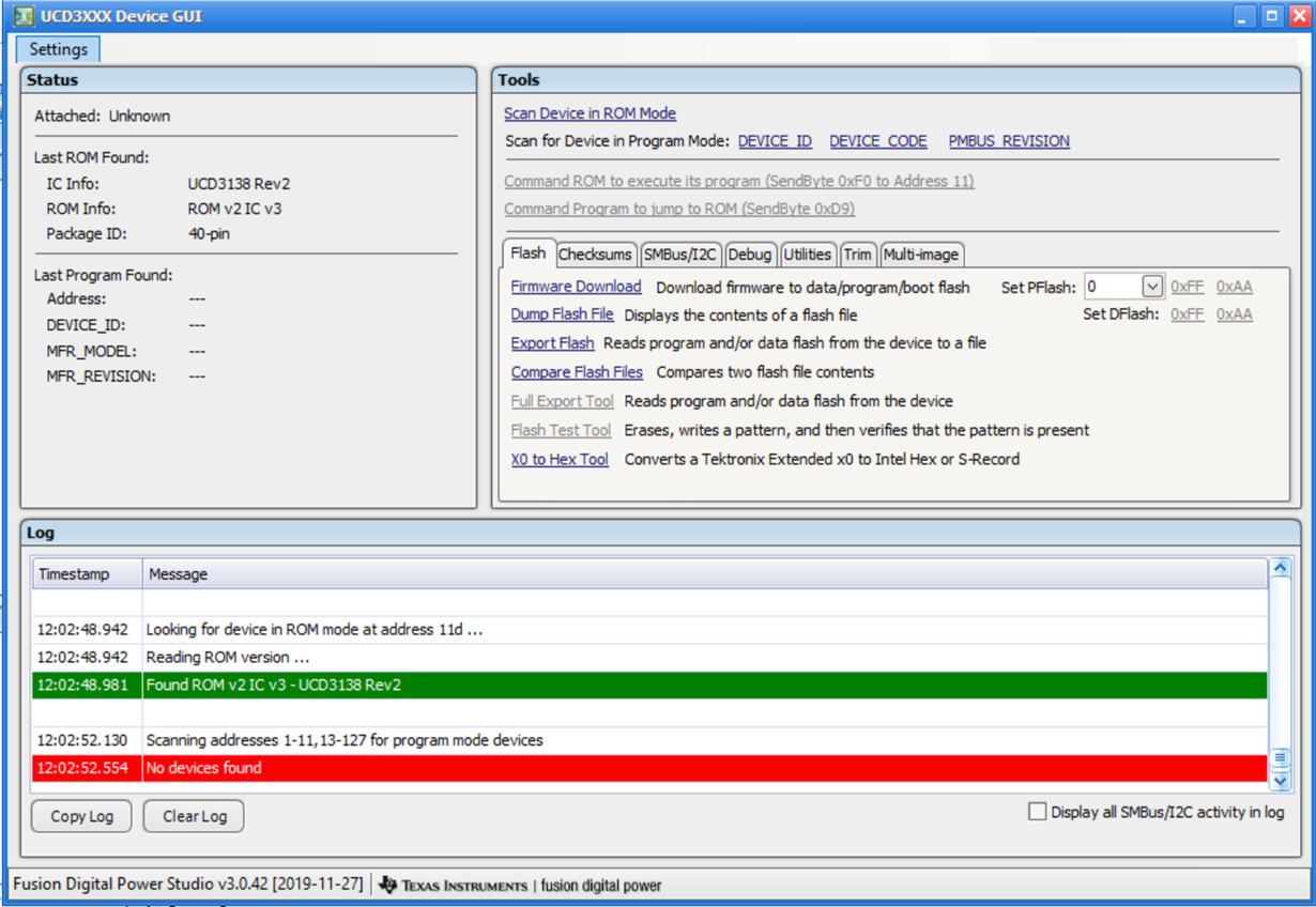

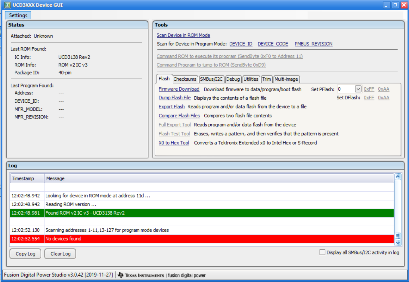

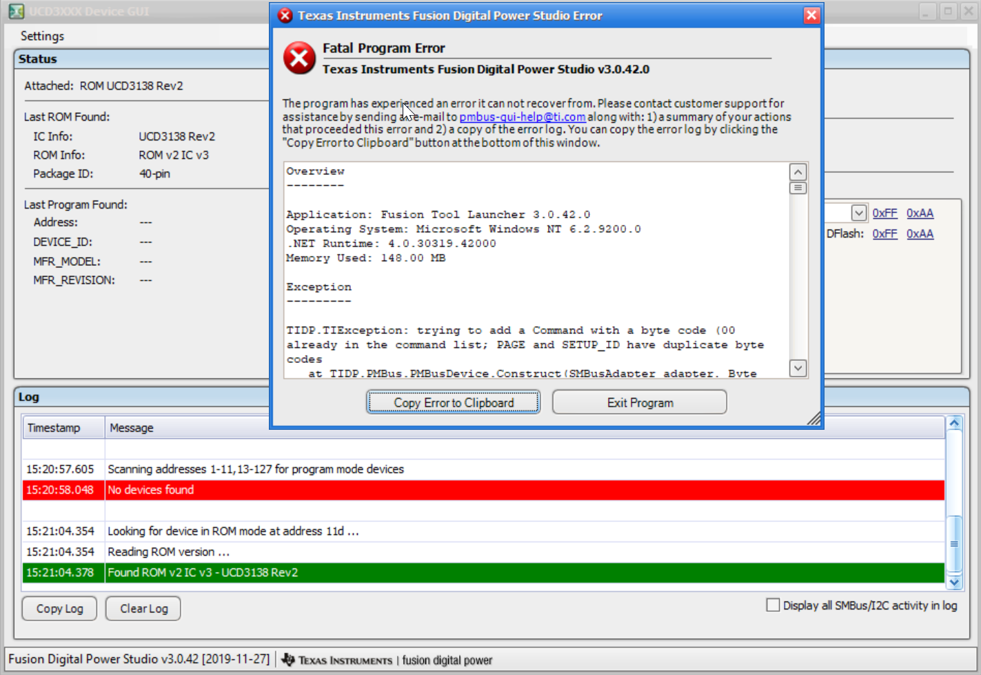

  • Hi Cormac,
    Here is the error.
    Actually, with the original code, I choose not to write program checksum, it won't be able to run as I click command rom to execute and shows no devices found. But as I have changed two parts mentioned before, it worked but directly program the checksum even though I select don't program checksum. And with modified code, all the memory update comes the error above.
    origin code
    modified code
    Cliff

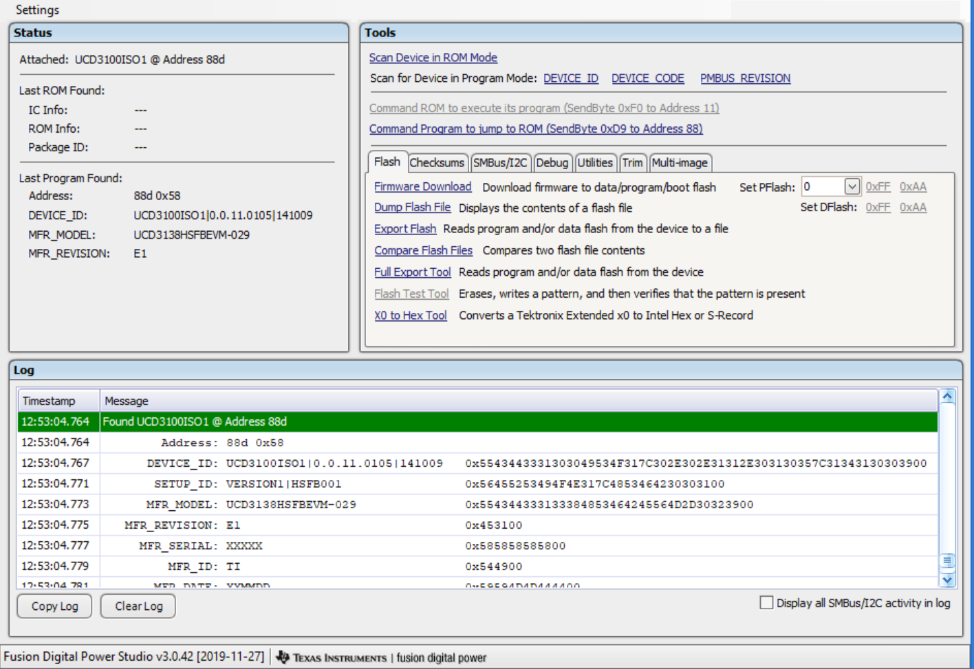

  • Hi Cliff
    So when you click "DEVICE_ID" as shown below, what do you see in the message log
    Do you see something like this?
    Best regards
    Cormac

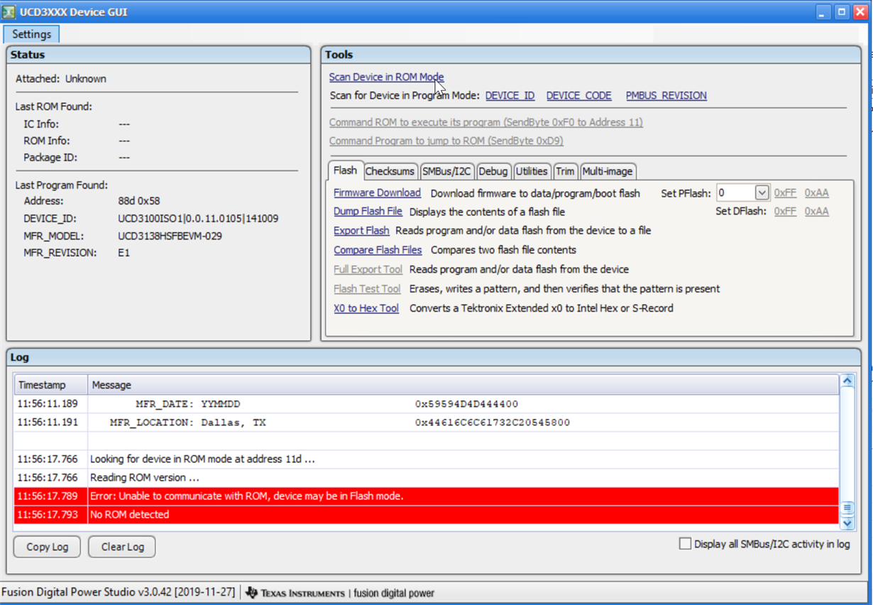

  • Hi Cormac,
    The picture didn't show. You might need to save and upload the picture.
    After click DECIVE ID, it shows id, which suggests it is in flash now, even though I select run in ROM mode.
    Thank you,

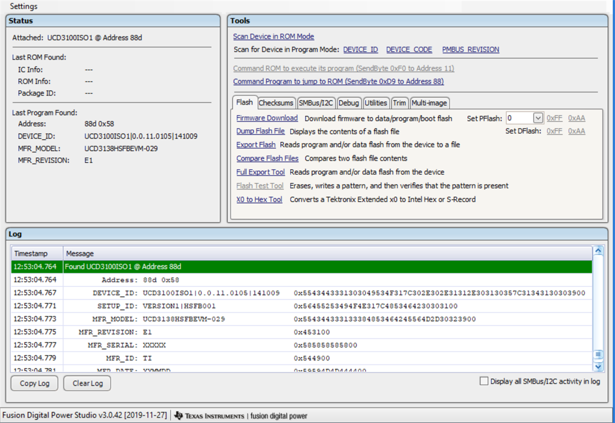

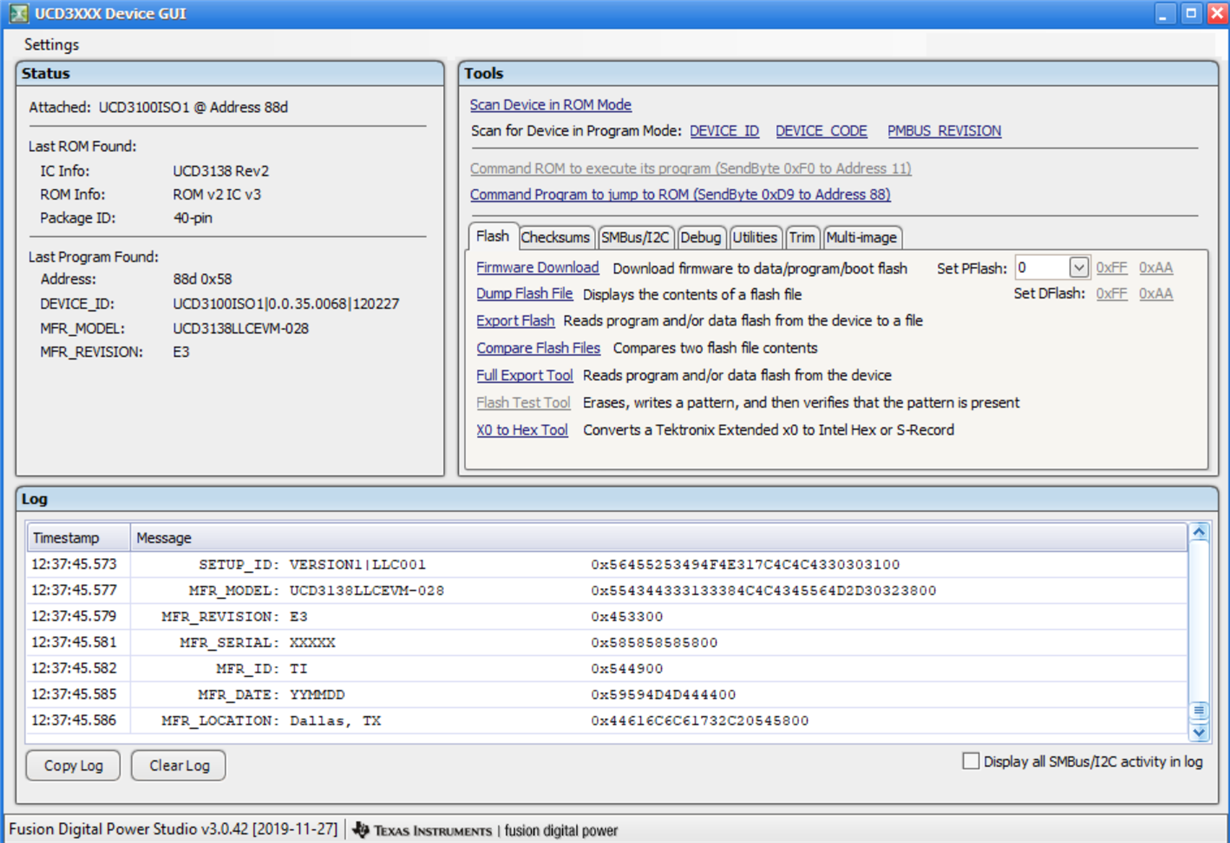

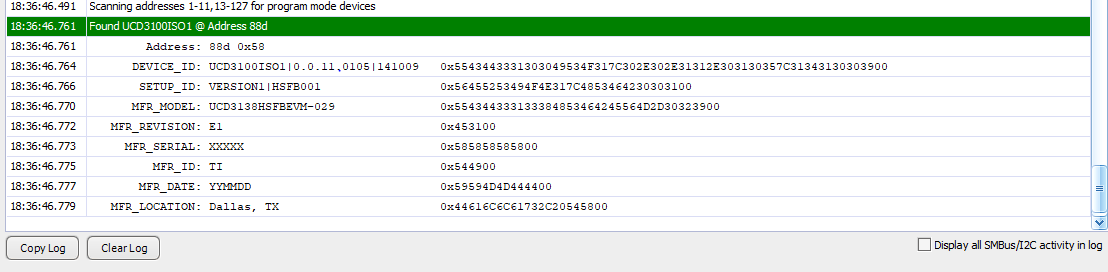

  • Hi Cliff
    Thanks. See attached now. For training lab 1, you should see the message below (HSFB, E1), you show LLC, E3. Is it definitely the training lab 01 firmware that you are using?
    Best regards
    Cormac
    The message
  • Hi Cormac,
    The right one is shown below. The previous is with my own code. But the error is within lab 1
    Cliff

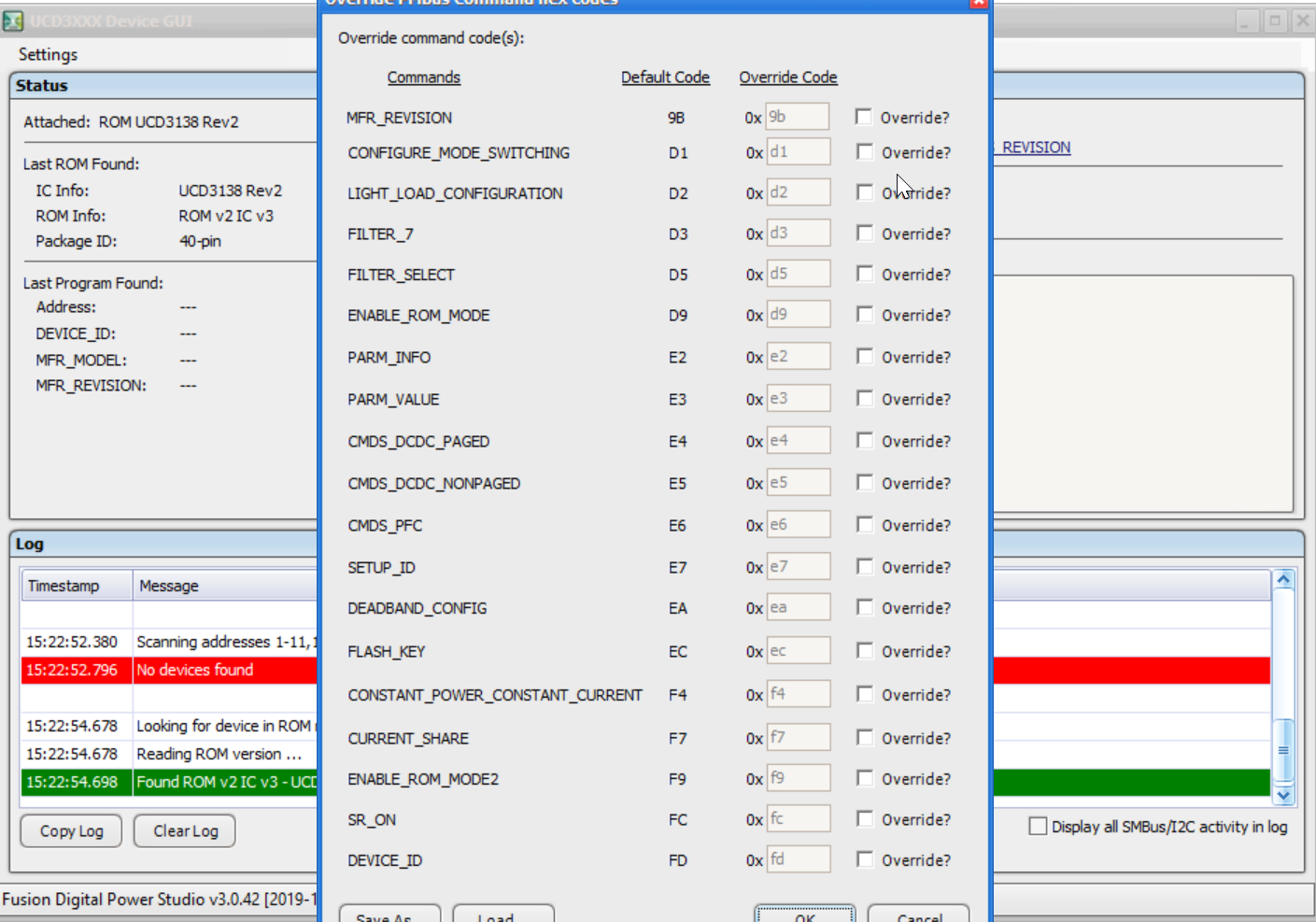

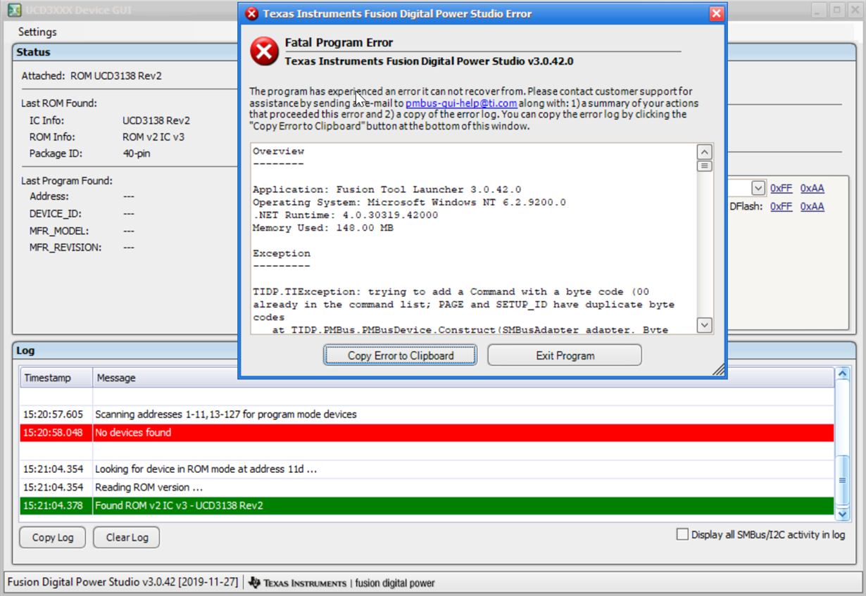

  • Cliff, one thing you can try:In device GUI, go to “settings”, then “override commands”, uncheck “override” for all of them
  • Hi Bosheng,
    I check this setting and it is not override for all of them already. if I checked it, an error came.
