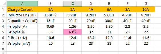

We have implemented BQ24630 to charge 14.2V 3AHr LiFePO4 battery at Ichrg: 1.5A down to Iterm 150mA.
Recommended LC or 8.3uH / 20uF gives a large Ripple current of 1.25A, which is 83% of Iload, much higher than the recommended range in your datasheet of 20-40%
It also is creating unnecessary noise in our delicate circuit (shielded Inductor may help)
It also switches to DCM below 600mA and we have had instability at 150mA.
Can we change LC to  22uH / 8uF or 33uH / 4.7uF  - both of these have resonant frequencies within the required 10-15kHz band.

    But I am trying to understand why TI's Datasheet recommends "inductor ripple is designed in the range of 20%–40% of maximum charging current", (and this indeed appears good practice), but then for 2A, TI recommends 8.2uH (same as for 4A) which gives a 1.25 A ripple and which is 63% of 2A (and 83% of our 1.5A charge current). 15uH and 15uF would make more sense (see table)
    So, I am interested to distinguish what is a tradeoff for size/cost versus what TI was forced to recommend due to some requirement of the chip freq. compensation (other than the resonant freq).

    The 20-40% suggests Ir of 300-600mA instead of the 1.25A, using for example 22uH (with 10 uF for Freson. of 10.7kHz)
    PS: you may think (correctly) - if designing high integrity device, I should get an expert to design my Buck - I did and he told me the above and strongly recommended we use 33uH !

  • Hi Michael,
       Using the 33uH inductor will give you < 40% inductor current ripple. If tradeoff with higher DCR and size is not an issue for you, then you can use this configuration with 6.8uH or 10uH capacitor. If you can handle slightly higher ripple then 22uH inductor with 10uF capacitor would also be an option.
    Again this is based off of worst case ripple, assuming 50% duty cycle (9V battery). If your cutoff voltage doesn't allow battery voltage to fall so low, then you can recalculate worst case ripple.

    Our test suggests 22uH / 10uF is stable throughougt BQ24630 charge cycle, so problem solved.
