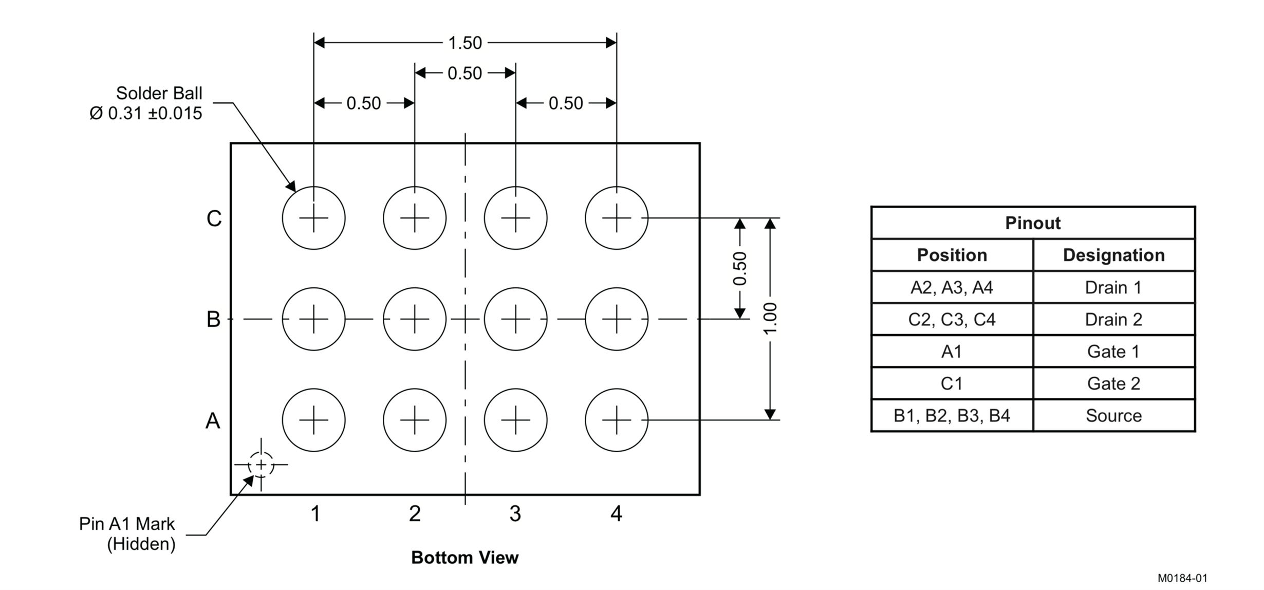

Hi TI experts,
There seems to be conflicting information between the datasheet and the WEBENCH CAD/CAE Symbols of this part. One has ABCD x 1-3, while the other has ABC x 1-4.
package information: https://www.ti.com/lit/ml/mxbg028d/mxbg028d.pdf
datasheet: www.ti.com/.../csd86311w1723.pdf
Attached are the package dimension drawings from the above two sources and the CAD/CAE symbol loaded from WEBENCH using the ultra librarian.
All the best, and thank you for your help in advance!
Yixin
Hi Yixin,
Nice to hear from you again and apologies for the confusion. In this case, the datasheet takes precedence as it is the officially released documentation for this device. However, there is definitely a discrepancy between datasheet, package drawing and CAD symbol. I will create a table mapping the various pinout implementations and attach it to a follow on response. I have to admit, this one has me a bit confused as well.
Hi Yixin,
Please see the attachment. Again, apologies for any confusion this may have caused. Please let me know if you have any additional questions.
