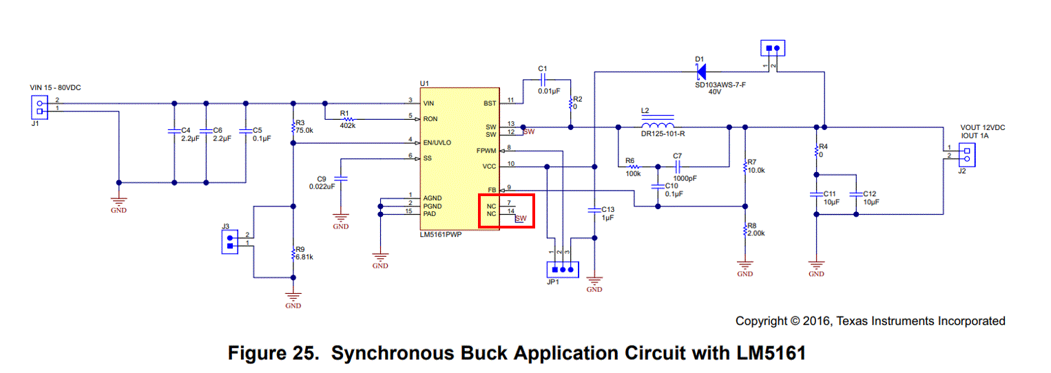

In the reference circuit, the NC pin (Pin14) is connected to SW.
Is there any reason to make such a connection?
Is NC okay with floating?
