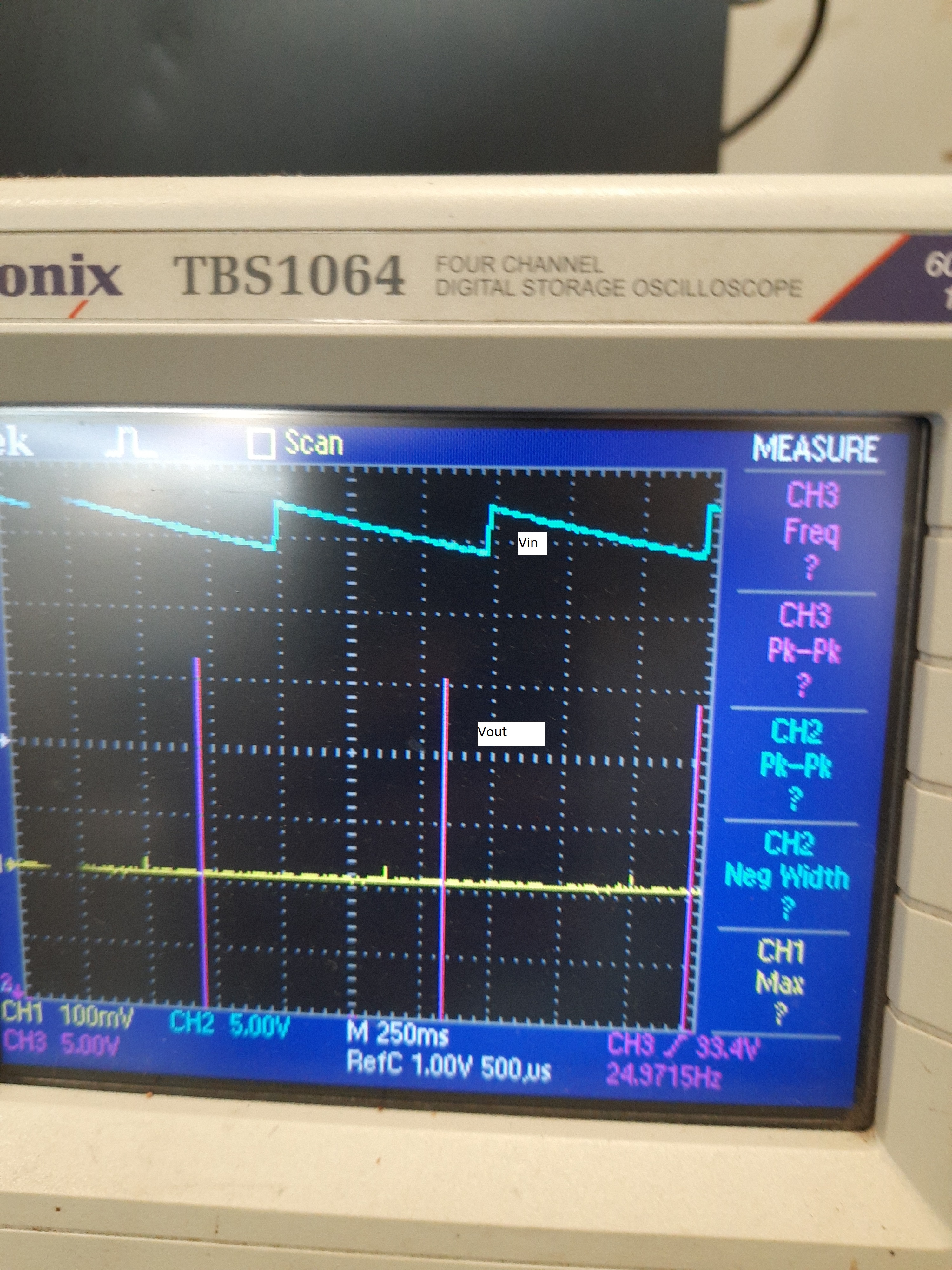

    Please find the attached images of VIn, SW node, and Vout waveforms.
    There is no signal waveform at COff Pin. PWM is - 50usec On-Time and 40mSec off time
    If there is no signal at Coff that is your problem.  It should have 1.0V triangle waveform.  Your schematic is wrong as mentioned before, Roff needs to go to the load and Coff is connected to the Coff pin (the resistor is on the wrong side).

    Please what about Sw node and Vout signal waveforms(Attached images)?  Are they okay?
    If there is no Coff waveform the sw node and Vout will not operate correct  It is rising and current flows but if Coff is not running it cannot work correct.  MOSFET turns on until peak current threshold is met.  It turns off for as long as it takes to charge Coff to 1.0V.  If it doesn't it goes to maximum off-time and you get what you see.
