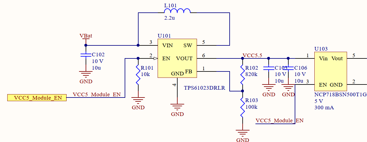

TPS61023: output drops after 400 ms
Part Number: TPS61023

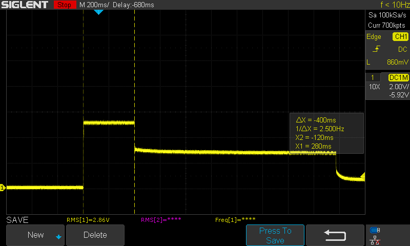

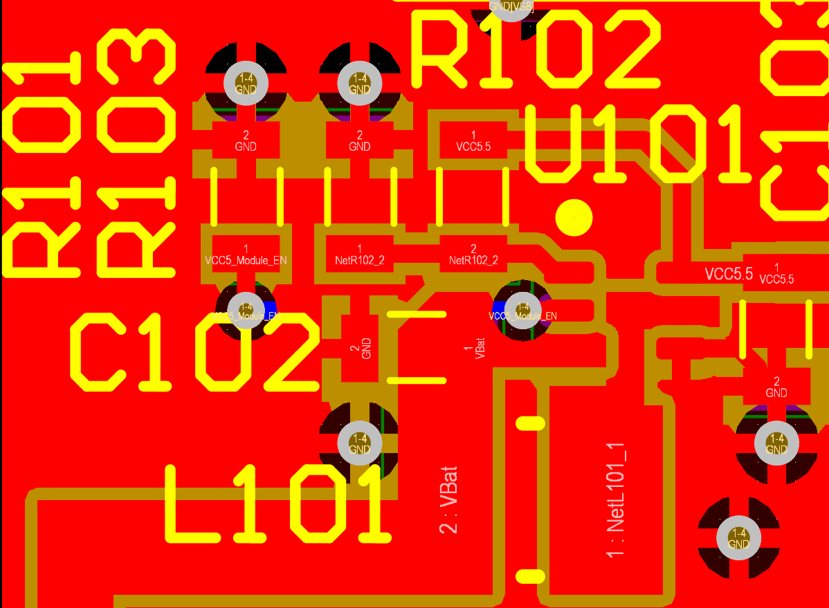

I'm using TPS61023 to boost voltage from a battery to 5.5 V, and converting to 5 V using LDO. My issue is when the load is not attached, the voltage rail is correct, however, when a load is attached, the voltage drops after 400 ms. I also noticed the inductor gets really hot, my guess is the switch node is always on. Can anyone provide any hint to solve this?
Thanks for any suggestions,
YS
