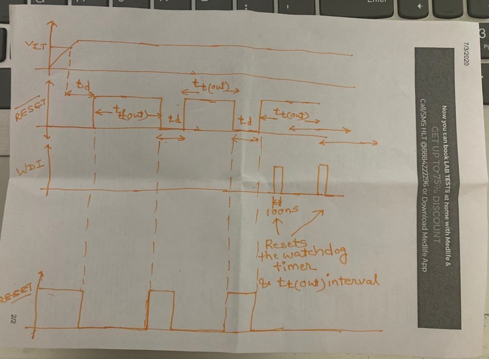

I have some confusion regarding the operation when VCC is stable. I have tried to explain my understanding through attached media.
So as per my understanding if I want to tie my RESET(bar) pin to Logic '1' , I have to continuously apply WDI input of 100 ns (pulse) at every T interval while T < Tt(out)[Watchdog TimeOut] .
Let me know if I am missing anything in this.

    The way the TPS3824 works is that you have to supply a rising or falling signal at least 100ns wide (could be much wider) before the watchdog timeout of 1.6 seconds typical (0.9 second minimum) otherwise a /RESET transition to logic low will occur for the reset delay time of 200ms. Is this the behavior you are seeing?
