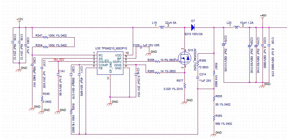

    My customer designed the TPS40210 schematics show as below.

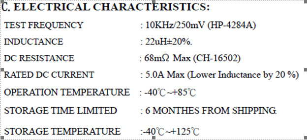

    and they used the inductor parameters show as below.

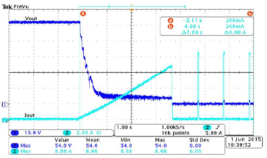

    The figure-1 is shown for 5Vin to 48Vout/Iout 0.15A nonsynchronous boost regulator, and they selected the RISNS(R577)=120 Ohm, when output current=80mA, the TPS40210 is going to the OCP state.

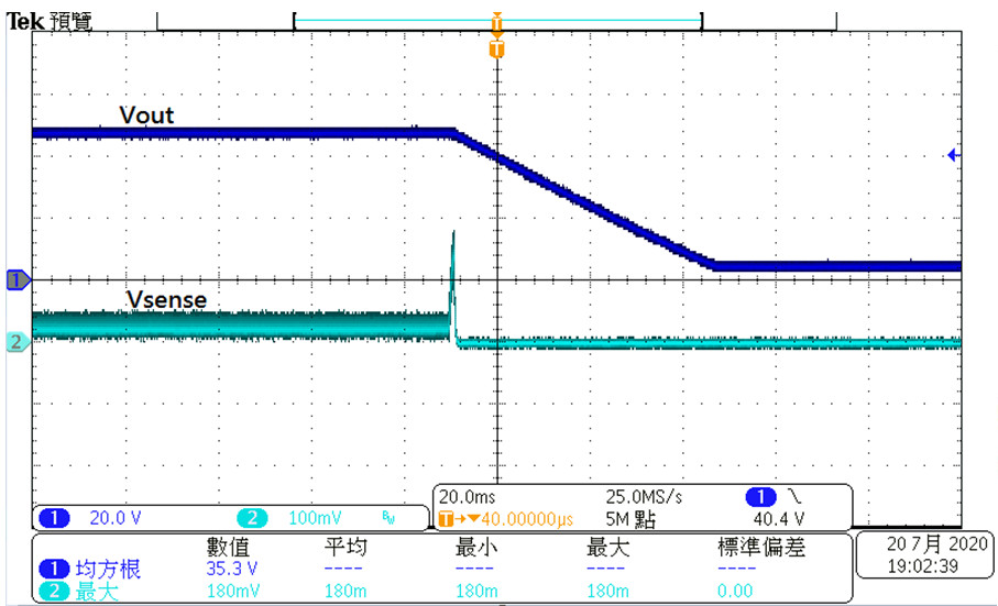

    The figure-2 is shown for 5Vin to 52Vout/Iout 0.15A nonsynchronous boost regulator, and they selected the RISNS(R577)=0.025 Ohm, but the output current need to load up to 6A, the TPS40210 is going to the OCP state.
    They would like to know why they followed the equation 50 to select the RISNS=0.025 Ohm, the OCP point is 6A?
    They would like to know they select the RISNS limitation is given by equation 49 or equation 50 or other equations by you recommend?

    Formulas 49 and 50 define the maximum sense resistor. Please be aware that in a boost converter the inductor current is higher than the output current. You need to calculate the peak inductor current before you can use formulas 49 and 50. 120 ohm is for sure too high.
