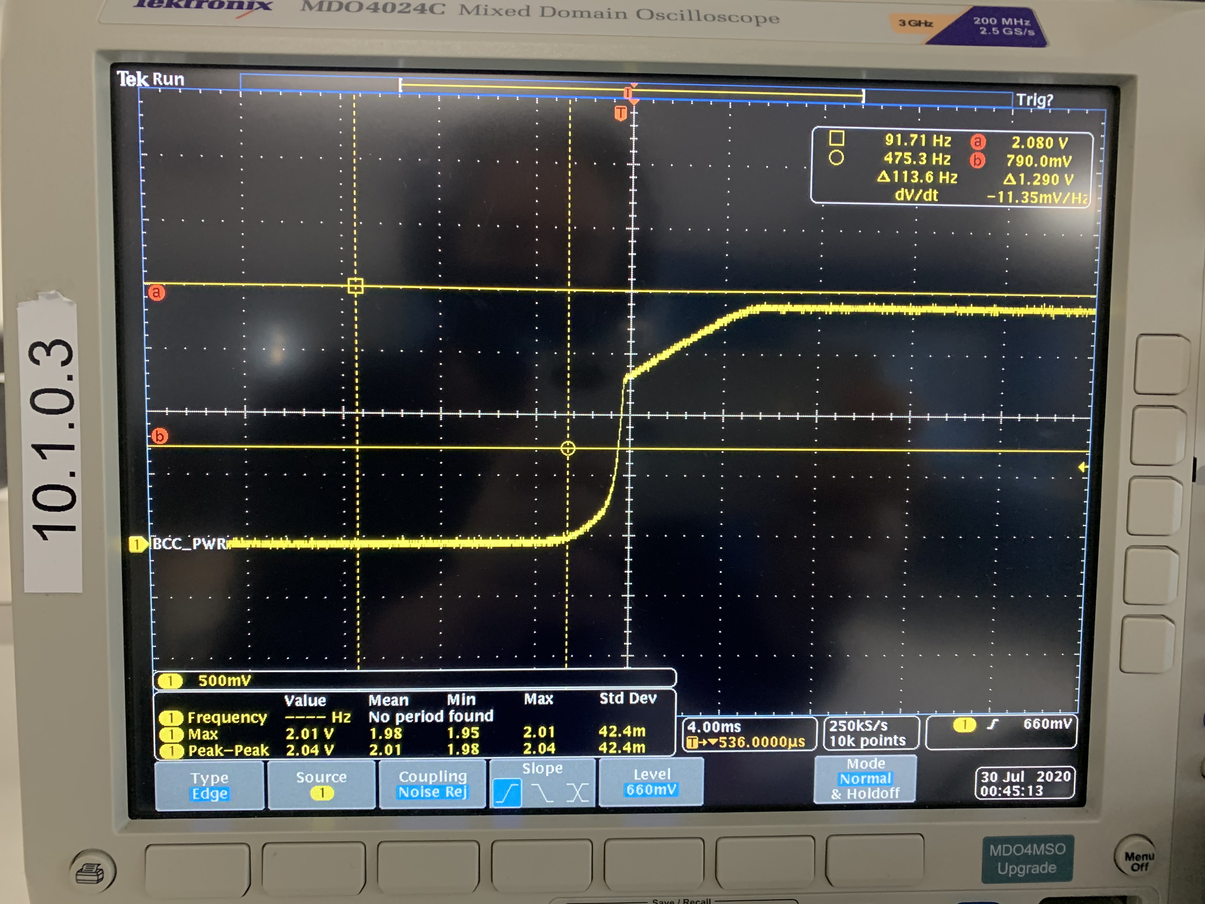

  • Wade,

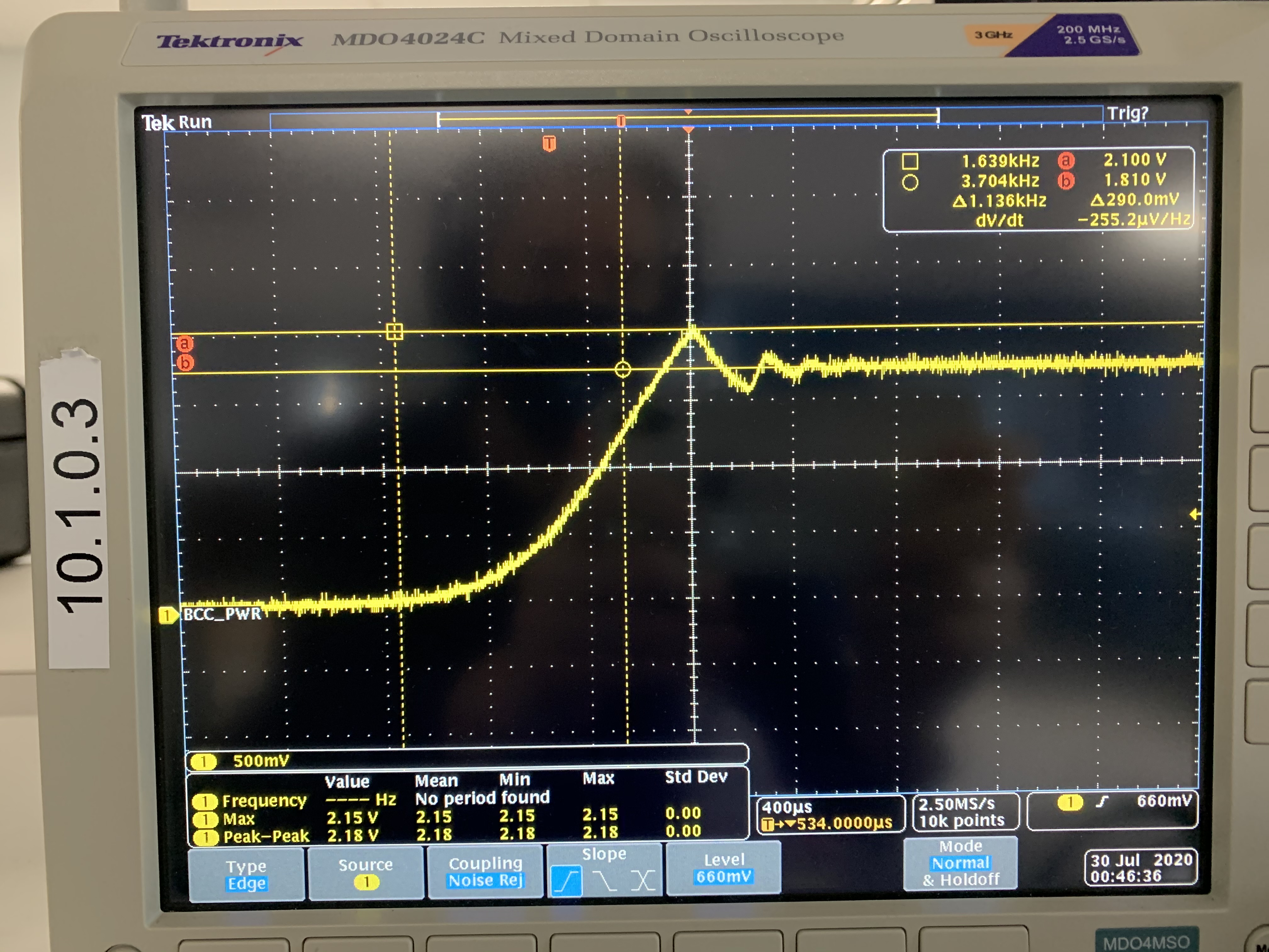

    Another engineer on my team is working this overshoot issue and had this to say in response to your last response (referenced JPGs are attached in referenced order at the end):
    While using the TPS7A4501DCQR, it was noticed that if the regulator was enabled AFTER power was applied, that overshoot would be seen on the output rail (Overshoot_No_Changes.jpg). We initially suspected inrush, and changing the output capacitance on the rail had some effect, but did not fully correct it, even after removing nearly all capacitance on the line.
    It was also noticed that some rails on our designs, as well as on the eval board, showed a nice, gradual increase up to the final voltage (Eval_Board.jpg). We finally pinned down that it was only the rails that were being sequenced via the SHDN line that were having issues. After making that discovery, the eval board was tested by simply starting the regulator in the OFF position, then transitioning to the ON position while power was applied. Once that was done, the eval board began exhibiting the same behavior of overshooting that we were seeing on our boards.
    As far as we can tell, this issue seems to be unrelated to the amount of time that it takes for SHDN to ramp (faster or slower makes no difference). We believe that the issue is that the error amplifier is defaulting to a full on state on powerup, which is then shorting VOUT and VIN. The error amplifier then takes a longer time to compensate for the extra current, resulting in the overshoot. This means that the second portion of the rise time seen on the eval board is actually not intentional – it’s the slew rate being limited by the ramp time of VIN (VIN_vs_Vout.jpg).
    We’re currently planning on moving the control of this external to the IC to make sure that we can ramp both of them together. We’ve also tried a number of different values for the compensation capacitor with not much effect (except on the noise). Is there anything that we can do to mitigate this issue without the use of external circuitry?

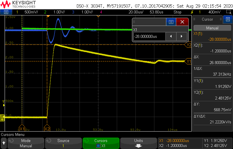

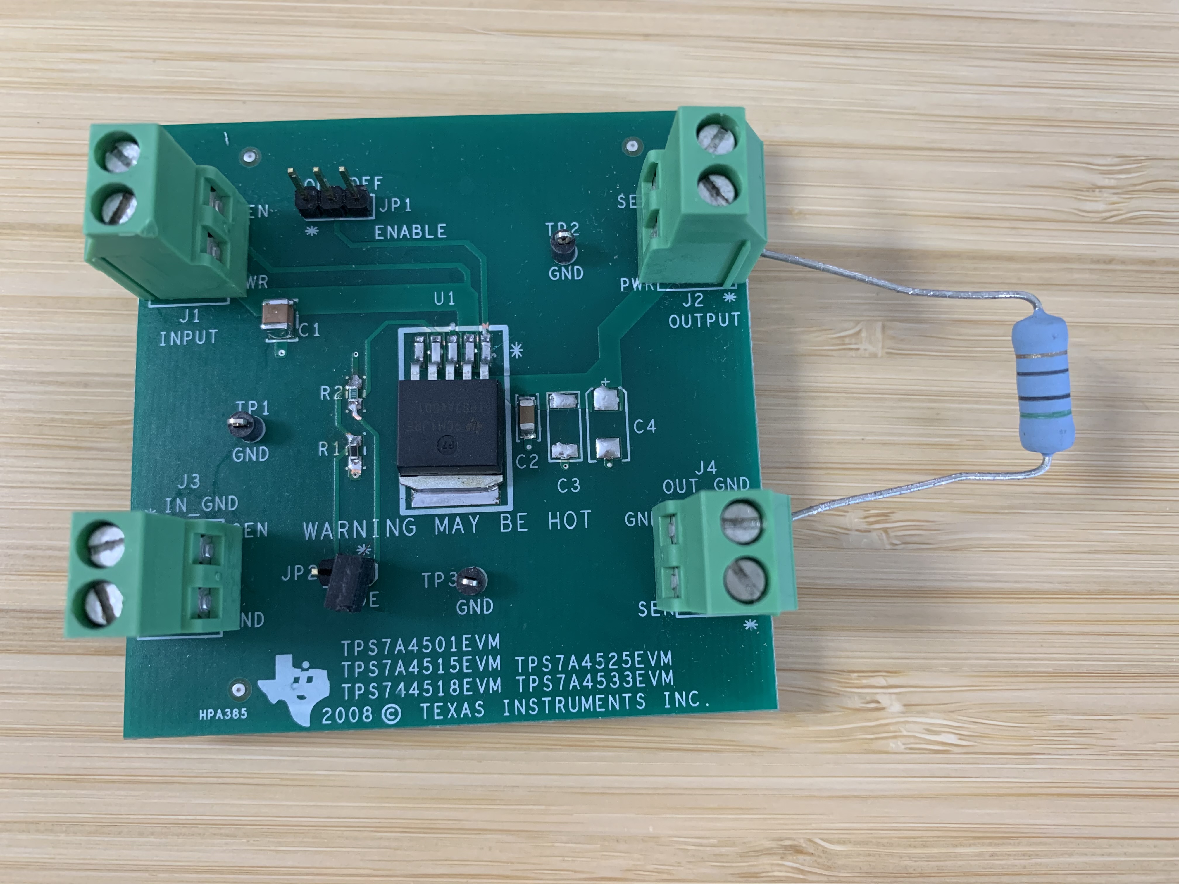

    I'm the engineer who took the scope shots in the previous post + wrote the write up. The part that we are using is the TPS7A4501DCQR.
    We are using the TPS7A4501EVM-385 board. I modified it to use the DCQR package just to make sure that it uses the same package that we are using. I've also removed some of the output caps except for a 10uF ceramic to simplify things. Load resistance is 50Ohms, but I've also tested this circuit out with high loads all the way to low loads and have seen similar behavior.
    The first scope shot is actually of the TPS7A4501DCQR on our board, in circuit after being powered on. The second two are the eval board.
    If it would help, I can generate a schematic that represents what we've done to the eval board if it helps the people on your end figure out what's going on. If there's an eval board handy over there, I'd recommend powering up the board with it in the OFF position, then moving it over to the ON position. You might see some bouncing issues, but I've found that to be a decently reliable way to get the LDO to overshoot.
    Let me know what additional info you need, and I'll get it to you.

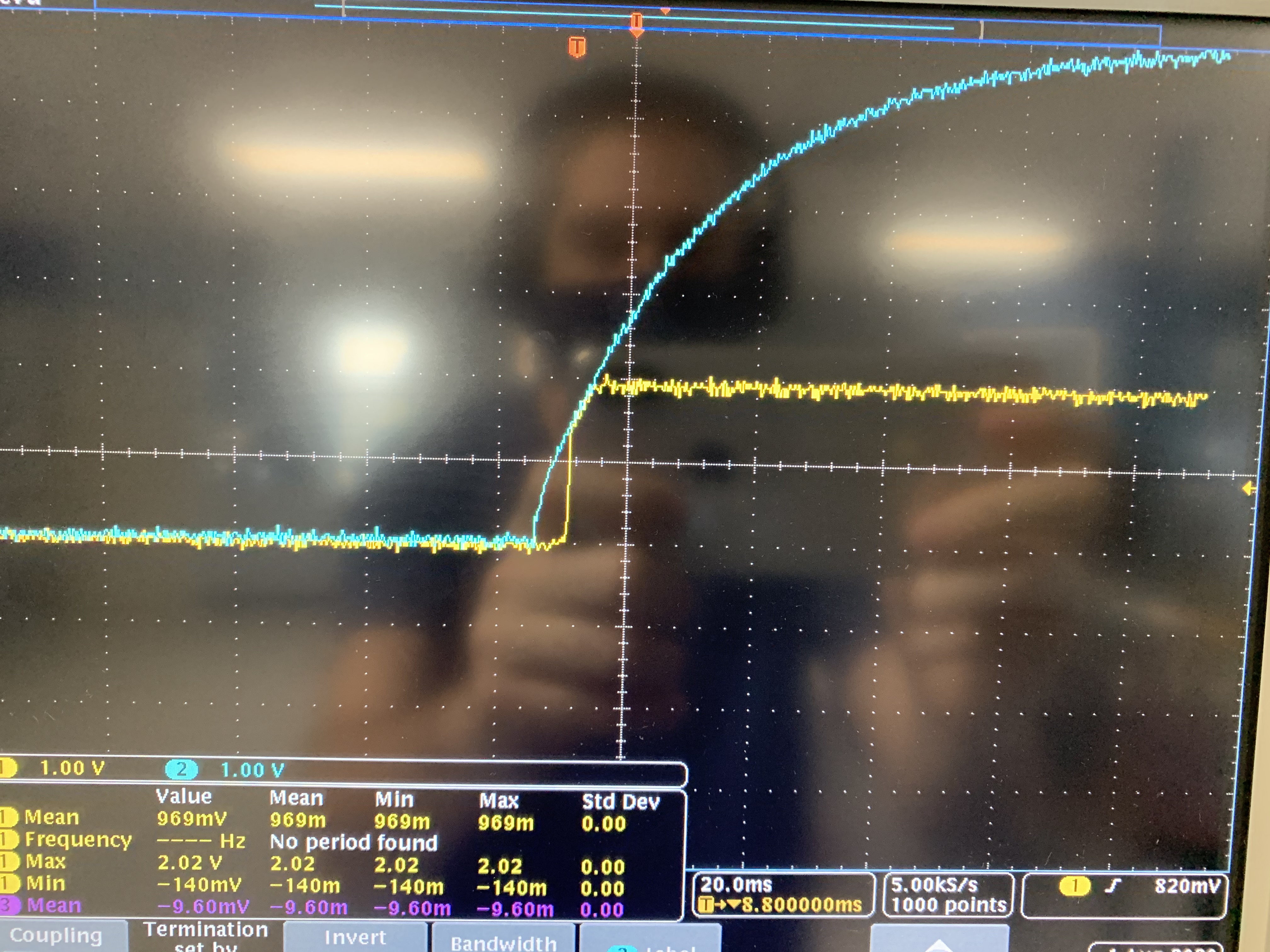

    I have a question on the plot you shared that shows an overshoot when you have an external control on the /SHDN, do you have a plot that shows the Vin level when the /SHDN has been quickly toggled on? I would like to make sure Vin is already at a level higher than the set output before toggling /SHDN.
    Jason Song
  • Jason,
    Just to make sure I understand your request properly - you are asking for a scope shot that shows VIN at steady state, with SHDN toggling after, correct?
    My initial scope shot shows that scenario - VIN isn't shown there because it's steady state out of a linear supply, which wasn't very interesting.
    If that's what you're asking for, I can get those to you Monday.
    Daniel

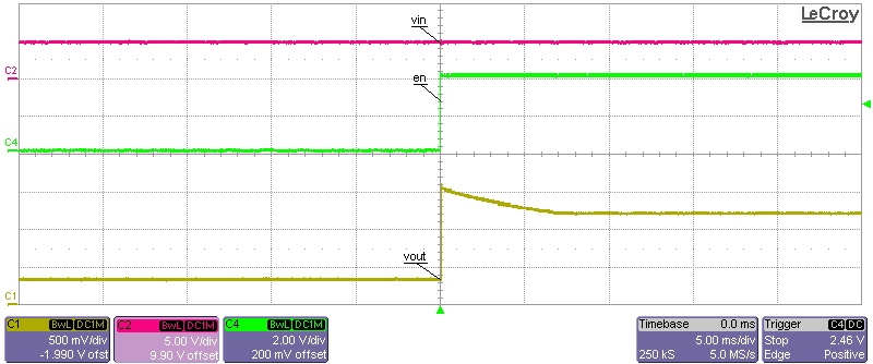

    I found one of the startup plots we took using the TI EVM for the non-SP part, and as you can see from the thread, the startup waveform looks very clean and without obvious overshoot. Please take a scope-shot that is similar to the one in the thread in which Vin, SHDN, Vout are clearly shown in the same plot.
    Jason Song

  • Hi Daniel,
    In the scope-shot you just uploaded, CH1 is the output, CH2 is the SHDN, and CH3 is the input. It would be better if you could also show the delay from SHDN (low->high) to the output (low-high).
    Looking at the other plots collected using TPS7A45 EVM, this part does seem to have a built-in soft start which would result in a controlled monotonic ramping up. In addition to evaluating using the dedicated TPS7A45 EVM, I would also suggest checking if you have the right TPS7A45 unit on the board. I would not expect the startup behaviors to be that different from the same die but different packages.
    Please let me know once you have more data to share.

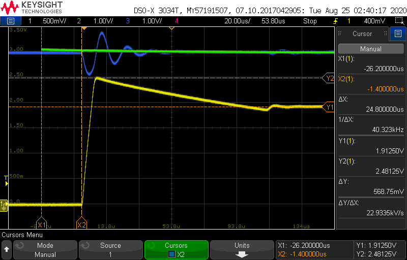

  • Hi Daniel,
    The latest scope shot you attached did not show the low-high transition of the SHDN and when you are doing your new comparison, please having it so we could read the startup time from the scopeshot.
    I have placed an order for the EVM and the DCR samples but for our internal samples, they only ship via ground shipping, which could take up to 5 business days.
    Jason Song

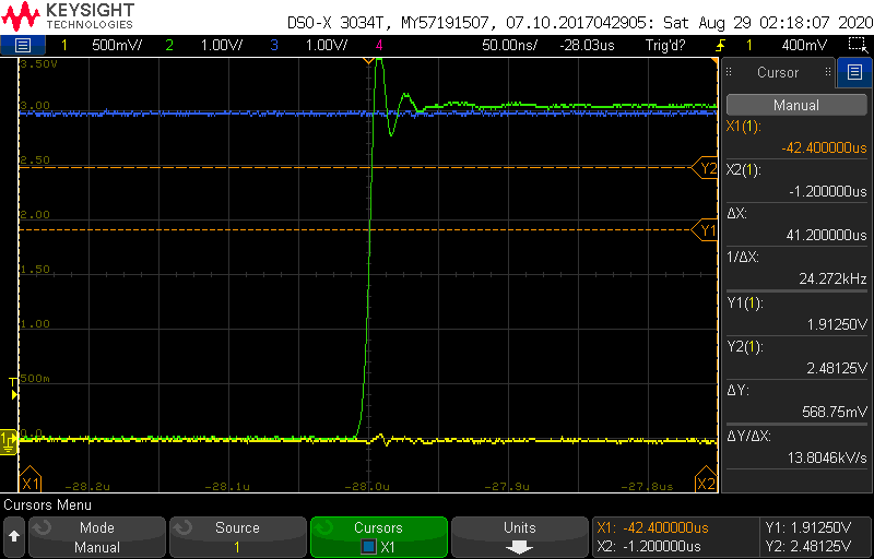

  • Jason,
    I think you're mistaken. CH2 shows SHDN transitioning from low to high. The rising edge happens very quickly, so it is difficult to see the line. The time delay that I have measured in that plot goes from the SHDN transition to when VOUT starts to rise. If you look closely, you'll see that there is no HIGH line on SHDN prior to the far left cursor.
    I can zoom in on that area if you'd like to see the rise time of SHDN instead? I just won't be able to show that and VOUT in the same plot.
    Daniel
  • Hi Daniel,
    Okay, thanks for the explanations and if so, the plot is good. Please let me know once you have some test data with the KTT parts.
    Jason

  • The only difference between the stock EVM and our board is that R1 and R2 have been configured for 1.925V out and we are toggling SHDN with a function generator instead of the jumper to make sure that we have a good, clean transition.
  • Hi Daniel,
    Will you provide the values of R1 and R2 on your boards?
    Jason
  • R1 = 1.69k
    R2 = 1k
    Output voltage should be a little over 1.925V, which the scope shots show we're getting (1.9125). If you're concerned about that 100mV, I can remeasure more closely to ensure better accuracy.
    Daniel
  • Hi Daniel,
    Sorry for the delay. Have you tried to use the EVM with the default R1 and R2 and with 3.3V output? For some reason, our bench results are very different than yours. Please let us know once you have verified it with the 3.3V.
    In the meantime, is it possible for you to take a photo of your test setup? I am trying to understand where the difference could be.
    Jason Song

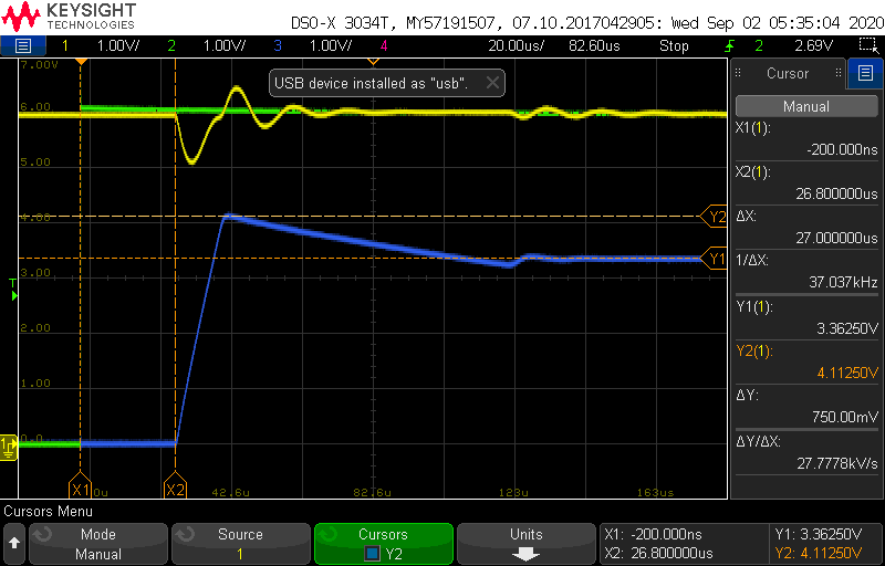

  • Jason,
    Changed the output to roughly 3.3V with R1 = 1k and R2 = 1.78k. Load resistance is 50Ohms, just to get some current flowing. Function generator output is connected to pin 2 on JP1 with a 3.3V pulse every 2 seconds. Delay between SHDN toggling and the output rising is still about 27 - 28us. Still seeing the same overshoot.
    When your team is testing the eval board in the lab, how are they powering up the board/toggling the enable line? Like I said before - this is far from an isolated issue for us - we're seeing this on every design that uses this part that has external sequencing.

  • Hi Daniel,
    I tested the TPS7A45 using the EVM using the default configuration which has FB connecting to the GND. I do observe overshot. I apologized, but the previous scope shot in the forum may have issues.
    It seems to me that this device does not have a built-in soft-start, which could result in an overshoot. At step, are you open to another IC?
    Jason Song
