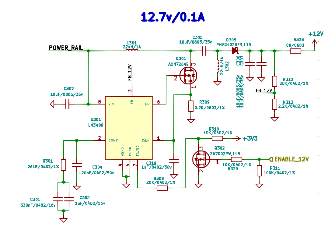

This is my circuit (I have another one reg. set to 3.8V/2.5A having the same problem):

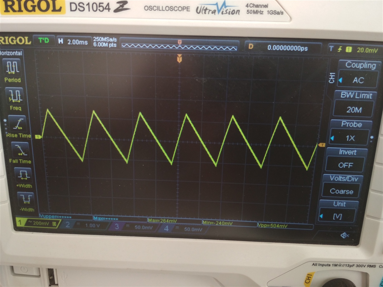

I'm having the pulse-skipping behavior when no load or a low load:
The input voltage will vary from 3-25v all the time.
To design the regulator, I've used the AN-1484(https://www.ti.com/lit/an/snva168e/snva168e.pdf) step-by-step. I don't know if I missed something, but I did not find a way to calculate the minimum load for the given component values.
What is the exact formula to make sure my circuit do not enter in pulse-skipping mode down to 1mA in any condition of input voltage?
Thank you!

  • Hello Bruno,
    There is a minimum energy delivered to the output in each switching cycle. The diode does not allow negative current, so if the output voltage is getting higher than the target level, the device has to stop switching.
    If you need a converter to switch down to almost no load current, you need to use either a dummy load or synchronous conversion to allow negative current from the output to the input.
  • Hi Brigitte, thank you for your response.
    Before moving to a synchronous part, I would like to know if there is a formula that dictates the relationship between the output load and the required on-time for a given frequency in the SEPIC configuration. Perhaps another part which has a lower minimum on-time could be sufficient for me. Would you help me?
  • Hello Bruno,
    A possibility would be to reduce the frequency on the given design. You would need to adjust the compensation for the lower frequency, but dependent on the minimum load you have, it is possible that with a lower frequency the on-time is small enough.
  • Hi Brigitte,
    Indeed lowering the switching frequency helped with the minimum load, but not the necessary.
