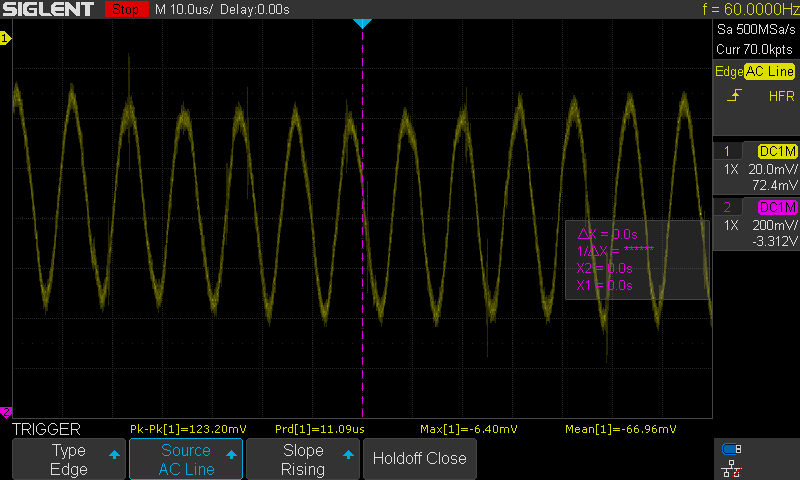

I am working on a custom implementation of POE on a IOT device. I received the boards for this unit, however the POE appears to not power on when it is plugged in.
Because this device is a prototype, I don't know the exact current needed and have the device marked as class 0. I believe it should be drawing 5W on average.
While it was plugged in I checked the waveform on an oscilloscope, and it seemed to fluctuate between -50 and 50mV. I attached this waveform to this support request. I also attached the schematic, which I believe is functionally the same as the example application given on the datasheet.
Do you have any insight on what makes this design not power up?
