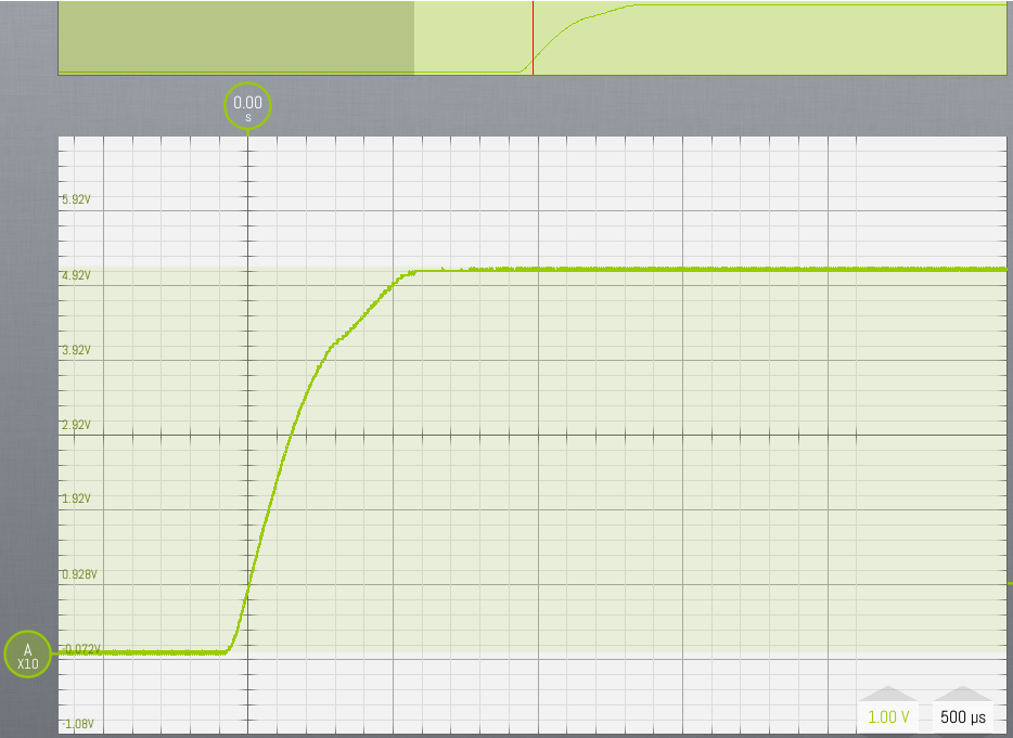

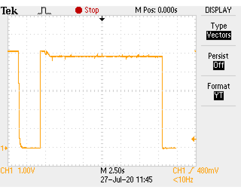

I have a device using the BQ25895 and I'm having problems having it charge consistently. Most of the time, when I plug the device in for the first time, the charger status indicator goes into fault. . I've tested this with multiple chargers. Here are the registers when the device starts charging properly

I've also had the device stop charging abruptly and go into fault with no apparent change in status registers
