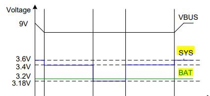

    2.
    For the above circuit, What is the relationship between charging voltage and battery voltage when there is a sudden discharge during charging operation?Could you give me your explanation and advice about the expected behavior?
    Customer wants to know the operation details when there is a sudden discharge during charging.
    I would like to know the following graph image of this circuit version.
    If Vsys and Vbat have the same voltage, I would like to know what kind of operation occurs when a sudden discharge occurs.

  • Yusuke-san,
    2.
    As you are not making use of PPM that figure does not apply to your circuit. During a sudden discharge the current would directly from the battery to the system. Please also note that the charger will not supply more current than it is set to as you have broken the direct connection to the adapter.
    In summary in the "no PPM" configuration VSYS always equals VBAT.
