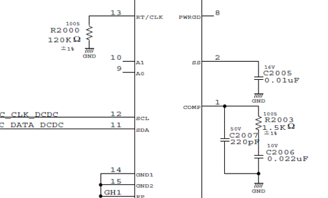

My customer is designing with TPS56921 referring EVM desgin. Let me confirm below design for below usage condition.
Vin: 12V, Vout: 1.0V, Iout: 1A (max), Fsw: 400kHz
1. Can 1.5uH of L1 inductance be used?
2. Can below components for COMP pin with above condition?
My customer had evaluated on EVM, so they referred it. But Webench shows different values.
