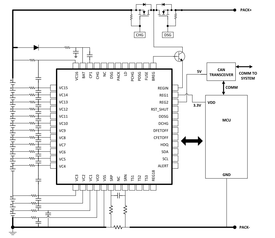

  • For instance, Datasheet specifies following circuit:

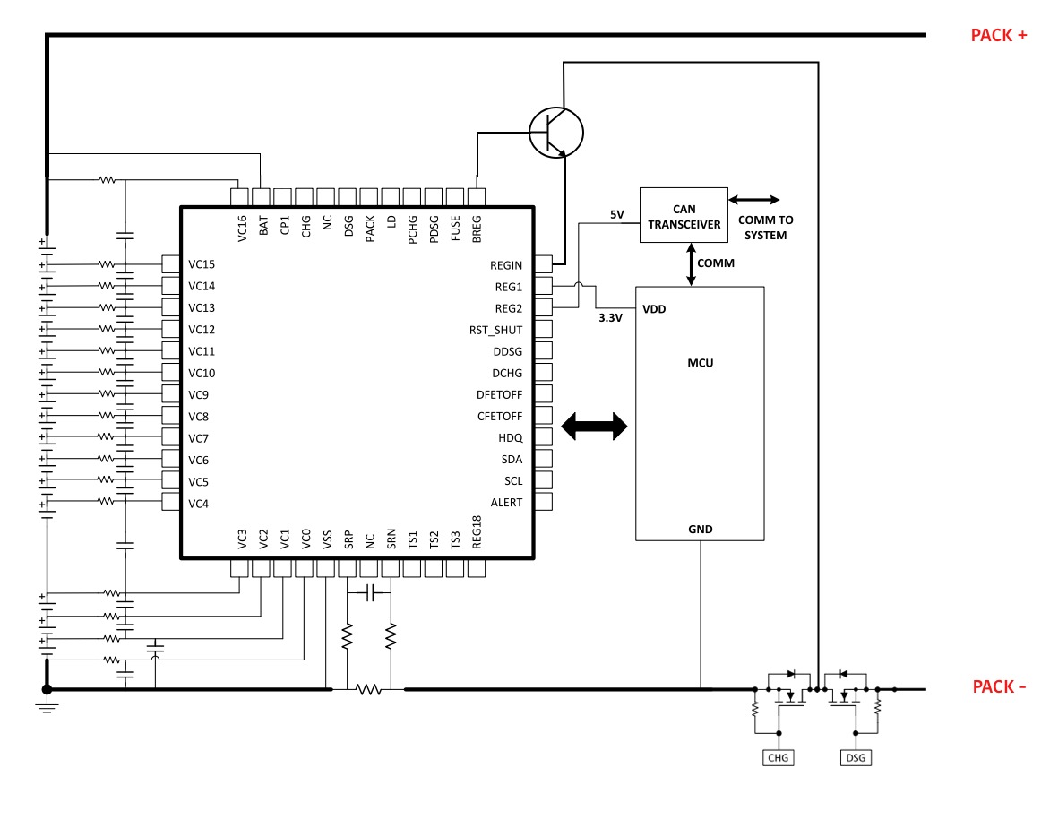

    But, I am trying to connect FETs along low-side as following:
    (Connections Just for reference)
    So, my doubt is:
    1. Do I need to use charge pump circuit with above low-side driving
    2. Are there going to be any issues as you suggested above related to breaking ground connection. Or should I use Isolation?
    Anurag
  • Hi Anurag,
    In some systems isolation may be need when using low-side FETs if the host is outside of the battery pack. For example, if the battery has a problem and the protection FETs switch off, the host (which is using PACK- as ground) may lose communication with the battery monitor (which is using BATT- as ground). In your diagram, the MCU is inside the pack, so this should not be an issue.

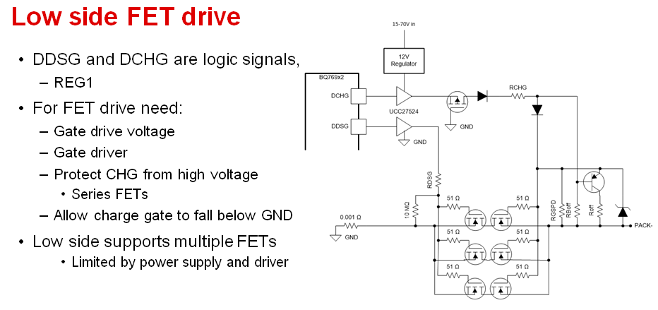

    The BQ76952 FET drivers are for high-side FETs. It is possible to use low-side FETs, but you will need to use the DCHG and DDSG signals (instead of the CHG and DSG FET drivers). This would also require a FET driver IC since DCHG and DDSG are digital logic outputs. This image below shows an example My colleague is preparing a detailed report on this specific topic that should be available in one or two months. As you can see, driving low-side FETs with the BQ76952 is a little more complex than using the integrated high-side drivers.
    Matt
  • Hi Matt,
    This clears my doubts and thanks a lot for sharing this diagram, highly appreciate it.

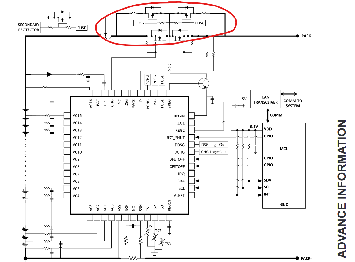

    As attached here:
    Anurag
  • Hi Anurag,
    Yes, level shift the PCHG and PDSG from the battery voltage.  Use low side N-ch FETs with resistors across the appropriate power FET.  Use zeners on the gates and dropping resistors as needed.
