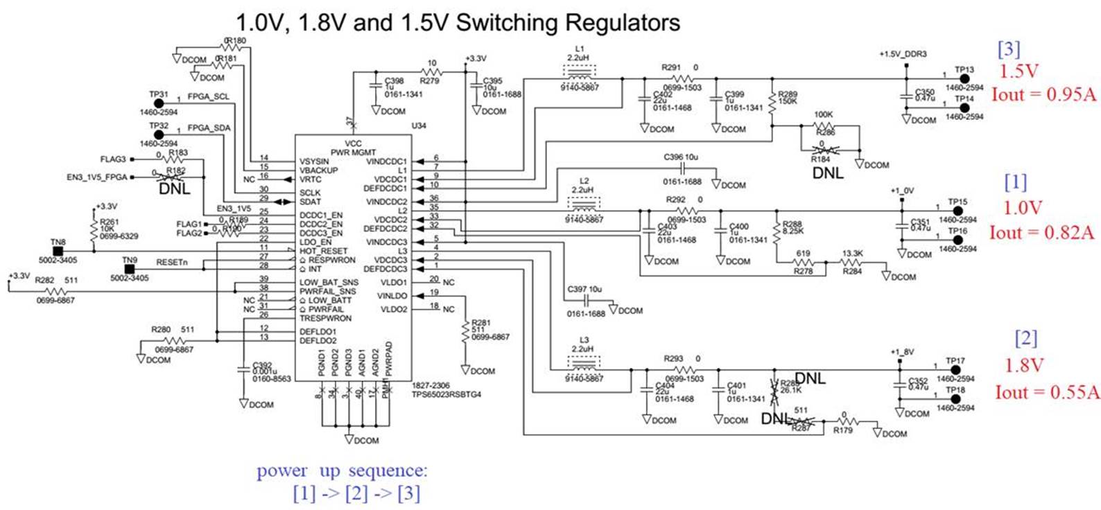

I am currently designing a power supply with power up sequence using TPS65023RSBTG4. The schematic is shown below.
Could you please review if the design is correct? Thanks.

  • Hi, I inserted the image file. Could you please review? Thanks.
  • Yes, I will review and provide my feedback now that I can see the image :-)
  • Below is my feedback, based on TPS65023x Schematic Checklist document:
    • Even if VRTC is un-used, recommendation is "to connect at least 100nF cap" from the VRTC pin to GND
    • If PWRFAILz output is un-used (floating), then PWRFAIL_SNS input should be connected to GND
    • If LOW_BATz output is un-used (floating), then LOWBAT_SNS input should be connected to GND
    • Cannot see pull-up resistors connected to SCLK (FPGA_SCL) and SDAT (FPGA_SDA) pins - should be 1k to 10kOhms
    • Cannot see FLAG1-3 source of signals that controls EN_DCDC1-3 inputs to ensure your desired timing of Seq. 1 = DCDC2, Seq. 2 = DCDC3, Seq. 3 = DCDC1
    • Because both LDOs are un-used, you can connect both LDO1 & LDO2 pins directly to GND (same as VIN_LDO)
    You can refer to the attached Checklist file that I started for you.

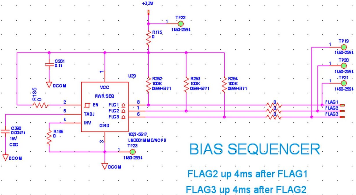

    Could you please review the pwr seq schematic using LM3881 shown below?
    • DCDC1_EN = FLAG3 = Sequence #3
    • DCDC2_EN = FLAG1 = Sequence #1
    • DCDC3_EN = FLAG2 = Sequence #2
    Result: when EN pin of LM3881 is >1.22V (t0), the sequencer will start operation. Since INV = GND (Low), FLAGx outputs are active-high which is correct for controlling the TPS65023 PMIC.
    1. 1.0V (DCDC2) will be enabled by FLAG1 at time t0 + TD1
    2. 1.8V (DCDC3) will be enabled by FLAG2 at time t0 + TD1 + TD2
    3. 1.5V (DCDC1) will be enabled by FLAG3 at time t0 + TD1 + TD2 + TD3
    T_enable_delay = 1.22V * CEN / 7uA = 0 because there is no capacitor at the EN pin to create an RC delay during startup. When "+3.3V" net > 1.2V, sequencer will start.
    The image is hard to read, but it looks like the capacitor at TADJ pin, C390, has a value of 0.0047uF
    TADJ,period = 120us/nF*0.0047uF = 0.564ms
    TD1 = 9*0.564ms = 5.076ms Min, 10*0.564ms = 5.64ms Max
    TD2,TD3 = 8*0.564ms = 4.512ms typical
    These are the sequence order and timing parameters for the LM3881 as it has been implemented in your system.
    Since I do not know the FPGA that is being powered the TPS65023 device, you will need to determine if the sequence timing and order will meet the sequencing requirements of the FPGA.
