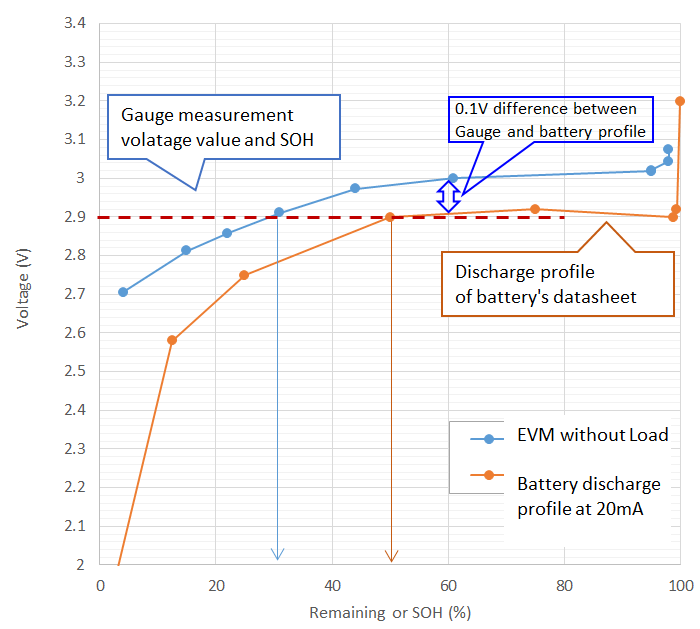

    For Q1:
    I would like to share my customer concern about Q1 with you again.
    There is 0.1V difference between Gauge's measurement and discharge profile of the battery. For example, When voltage was 2.9V, the gauge says about 30% but discharge profile in datasheet of the battery says about 50%.
    Could you please provide a discharge profile of ChemiID (Pana CR123A) of BQ35100?  I want to compare it to battery's profile (Pana CR123A)
    Does customer need to make procedure of GPCCHEM?
    If yes, how long does it take after customer send data to TI?

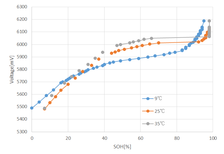

    For Q2: correction by temperature
    Please check below figure it shows a relationship between voltage and SOH of the gauge for three temperature as 9c, 25c and 35c.
    It seems storage that 9c line was cross to other higher temperature under SOH 30%.
    Could you please provide how it is calculated with the formula?
    Could you tell us how to solve this?

  • Here is the response from our algorithm team
    How did the customer get the chemID for this primary cell? Was it obtained through cell characterization or was it by a chemid match. If it is chemid match, I would not recommend it since we don’t have a lot of primary cell chemids in our database and hence we may not get a good match.
     Q1. Also from this discharge profile that I found on e2e, it seems they are comparing OCV to voltage under load, so obviously it will be off. Even though the load 20mA is a relatively light load, the Ra values are pretty large as you can see below and hence the IR drop will be large.

  • Hi
    Figure of Q1 has bq35100 at no load but Panasonic datasheet at 20mA load. When load is lighter, the voltage is expected to be higher for same SOC. We expect the curves to match at load of 20mA.

    The OCV correlation operates only under completely relaxed conditions, long after any load has been applied. This gauge cannot be used if continuous current is applied - a wait is required after current has stopped until cell is fully rested (typically more then 5 hrs) before SOH.gets updated.
    Please verify the use case. The curves that were measured at constant load are not applicable to the use case that bq35100 supports.
    Let me confirm my understanding.
    Now customer is comparing SOH result of the gauge and battery's discharge curve at 20mA. this is not correct, right?
    How does customer verify the BQ35100 work correct?

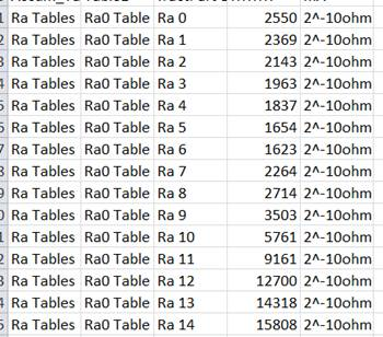

    Customer is checking the discharge curve what you mentioned.
    Customer is trying to make gauging parameter of GPCCHEM using primary battery of pana CR123A.
    https://www.ti.com/tool/GPCRB
    The customer generates data log file in room temperature and cold temperature. then submitted them with config and gg files. But they received error email as below, it seems gg file has problem.

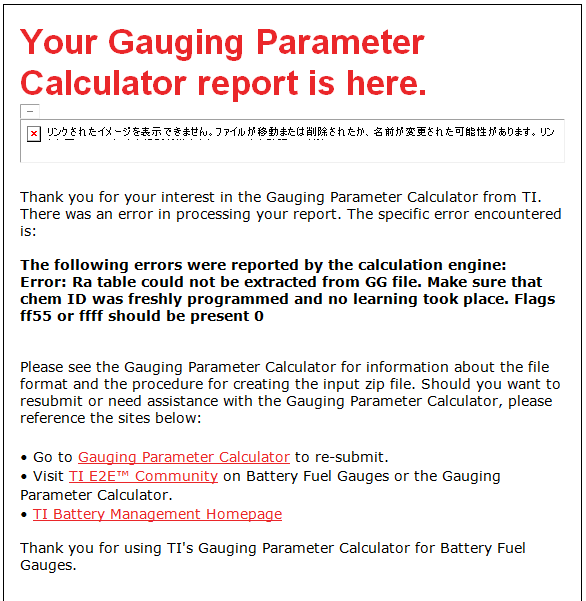

    customer has below question
    1. Is it available to use the GPCRB for primary battery with BQ35100? because the system has only discharge, so teat procedure doesn't meet the usage condition.
    2. Why does the error occur?
       Customer doesn't use BQstudio for getting data log parameter. in this case, .gg file doesn't matter to generate the gauge parameter. What kind of .gg file does customer upload to GPCRB?
    error email is here.

  • Hi
    GPCR  tools requires GG file. The GG file must be of the correct format. It is not necessary to use bqStudio as long as the format is correct for all files.

  • Hi
    The format looks ok. If any parameters values are configured incorrectly, then the GPCRB tool will provide an error message.
    Thank you for your support.
    I still don't understand why customer has the error of GPCRB. I would like to know what a reason of the error?
    Do the configuration file or data log file have something problem?
    Does someone use GPCRB with BQ31500?
    Katsu
    This issue is now a very specific debug activity. It is best to take it offline and connect you directly to the chemistry experts.
