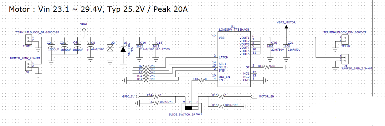

  • Hi Anthony Pham
    The circuit diagram created by referring to the data sheet is shown in the figure below.
    The motor data sheet is also attached.
    Are there any parts of the schematic that need to be supplemented?
    JungHoon

  • Hi Junghoon,
    I'm not sure I'll be able to completely answer the question of being able to drive this motor directly as it does not give me information such as inductance or capacitance. As mentioned previously, it will be able to handle 10A at ambient temps less than about 95C and limit current if it exceeds the internal 20A current limit.
    For your schematic, we do recommend that there be some sort of reverse current protection, either a blocking diode at the input or a resistor-diode GND network. I noticed that you have DNI for R7, we recommend grounding this resistor as the SEL2 pin requires a path to GND to allow for protection in a reverse battery event that allows the device to automatically switch-on to reduce power over the body-diode.
