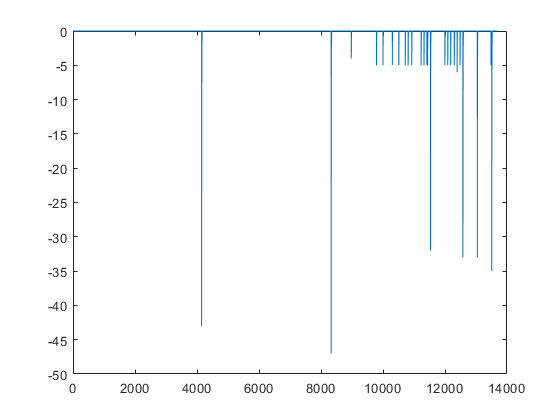

We build low quantities (3-5 at a time)  of power supply modules that have a small (1100 mAh) 4 cell LIPO for emergency battery backup. Our latest build is operating in a way that is different from previous builds. The LCD display flashes periodically, and somewhat erratically. After much sleuthing I discovered that it was behaving as though every time it came out of sleep to measure the current, at (SLEEP CURRENT TIME) intervals, the LCD would flash (not blink)  for (CHG RELAX TIME). Initial values were  45 for (SLEEP CURRENT TIME) and 60 for (CHG RELAX TIME) which seems to make the actual behavior somewhat erratic. I played with both (SLEEP VOLTAGE TIME) and (SLEEP CURRENT TIME) and (SLEEP CURRENT TIME) was the setting that altered the behavior, which makes sense
However when I change CHG RELAX TIME to 6 and SLEEP CURRENT TIME to 15 the behavior becomes quite regular in time and easily observable and about what one would expect. Changing SLEEP CURRENT TIME to 150 changed the behavior as one would expect.
Next I looked at why the current builds manifest this behavior.  There is a difference between current and earlier boards. The layout had to change, many parts moved and a calibration register, (BOARD OFFSET) had to change from -34.7 to -104.8.
The tech manual explains that the chip enters charge mode if the current > (CHARGE CURRENT THRESHOLD), which is 100 in all the builds. What I did was by successive approximation determine the threshold that this behavior manifests itself at (on 1 unit that flashes) that threshold was 151 . That is if I set (CHARGE CURRENT THRESHOLD) to 152  the chip does not enter CHG mode upon waking from (SLEEP CURRENT TIME), at 151 it does. (sample of 1 board)
Important points. This happens on a system where the chip has been calibrated, and the battery has been idle for hours. It must come out of sleep. With the timers set to the longer values (CHG RELAX TIME) = 60 and (SLEEP CURRENT TIME) = 45 I could connect  the EV2400 (running the bq20z655-R1 v0.03) software (while the LCD was flashing), and read the status (SBS screen - Refresh) while flashing the DSG bit would be GREEN (two places) and go to RED once the flashing stopped. I verified this on the PRO screen by reading SMB WORD 54. (8447 or 8445 when not flashing, 8405 when flashing) The EV2400 seems to stop the chip from going to sleep, so normally to observe this behavior I had to leave it disconnected. Also with the board calibrated and the (BOARD OFFSET) as above the EV2400 typically reports 0,0 for current and average current.
SO... it seems as though somehow upon waking from (SLEEP CURRENT TIME) our latest builds (at least) make some sort of transient, glitchy current reading that can trip the chip into CHG mode for (CHG RELAX TIME). I don't rule out that earlier builds with the lesser board offset operate similarly, with a lower then 100 (but still rather high) (CHARGE CURRENT THRSHOLD). I am not the original designer, having inherited it, so I don't know what early issues might have been been found.
Question is,  has any one seen something like this? Any fixes, or suggestions? Could it be related to the what seems (to me) the rather large (BOARD OFFSET) value that we have to use?
  • Hello Doug,
    Could you provide the data logs from your testing? You can log with the evaluation software and also pull the .gg configuration file from the gauge so we can take a look?
    I have not seen this kind of error before, but if you were using the same gauge before in the system and then changed layouts and this error began it may be a hardware issue, is the hardware the same with a different layout or have multiple changes been made?

  • Here is the GG flash dump from the unit I have been experimenting with and behaved the way I described
    I just realized that I could drag and drop files for upload so I have done that as well. I'll leave the added stuff below, but hopefully you can get the files.
    I've repeated something I wrote below, if you can read the files you have no need to read past the end of the next paragraph, just look at the files
    I have an all night log file, that does not exhibit the behavior, I believe because the gauge never went to sleep . Its 13000+ lines so I wont post it, just some interesting bits. The log showed something else that I didn't bother to mention. I was logging voltage, current, average current battstatt opstat and chgstat, hoping to see it cycle in and out of CHG mode. Instead I see 0 for current the whole test, and occasional  spikes (negative) in average current. As it didn't cause the problem in the topic, I chose to not cloud the issue, but since you asked... Here is the beginning and a few spikes, you can tell by the sample number and time stamp when it occurred in the complete log. I have attached the GG file, complete log file and a BMP of a MATLAB plot of the average current. The current was zero for the whole log duration (> 16 hours).  - looks like I have to make the txt filex docx files...

    I have an all night log file, that does not exhibit the behavior, I believe because the gauge never went to sleep . Its 13000+ lines so I wont post it, just the interesting bits. The log showed something else that I didn't bother to mention. I was logging voltage, current, average current battstatt opstat and chgstat, hoping to see it cycle in and out of CHG mode. Instead I see 0 for current the whole test, and occasional  spikes (negative) in average current. As it didn't cause the problem in the topic, I chose to not cloud the issue, but since you asked... Here is the beginning and a few spikes, you can tell by the sample number and time stamp when it occurred in the complete log.
    gplagg.docx
    overnightlog.docx
    START

    ******* a spike in average current *******

  • Hello Doug,
    You can share the whole log file here in a zip or just drop them how BQEVSW outputs them, it's harder to look through the docx files compared to a .csv.
    I believe there is a scanning feature in BQEVSW you may need to turn off when logging which could cause current spikes like this.
    As I mentioned earlier, if you are using the same chip and almost the same .gg file besides the board offset then the issue is most likely hardware. I would compare the two schematics and make sure there is no noise on the inputs to the gauge.
    Sincerely,
    Wyatt Keller
