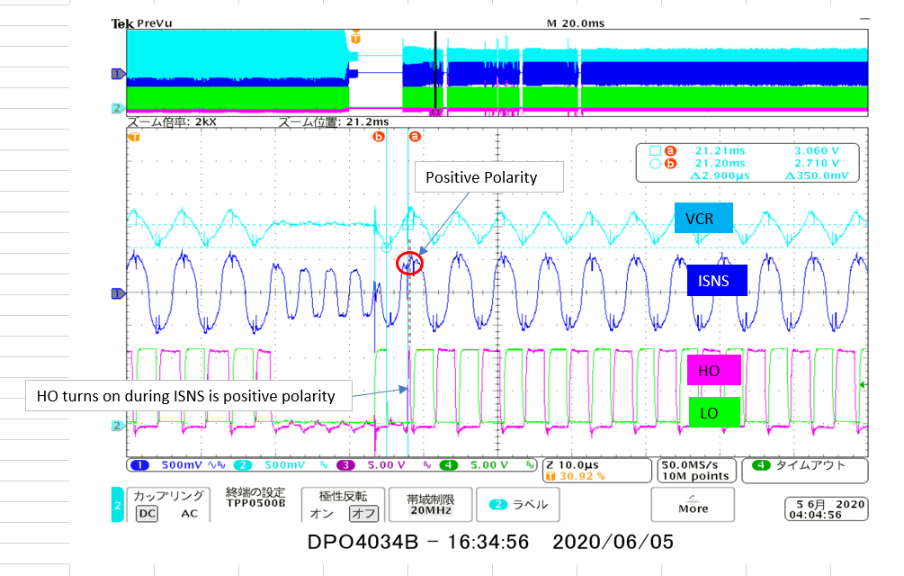

    I have an additional question.
    Mike-san commented that "when both FETs turn off during burst mode there is ringing in the primary and to stop the transformer from saturating the opposite gate turns on when coming out of the burst.".
    Is this turning-on behavior included the figure 39 on the datasheet?
    I would like to know the mechanism which HO turns on during ISNS polarity is positive as below.
    Kuramochi
  • Hi Tadahiko-san,
    I would say it's not explicitly captured by figure 39 in the UCC256302 datasheet but the controller will always deliver an equal amount of HO and LO pulses within each burst packet. This also helps to keep the resonant capacitor DC voltage at 1/2 the input voltage and keep the SR stresses fairly equal when in burst mode. If an unequal amount of pulses are delivered in the burst packet, the resonant capacitor DC offset voltage may not stay at 1/2 the input voltage and stresses may not be equal through each leg of the power stage.
