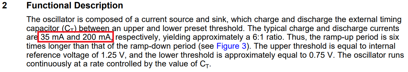

MC33063A: Mistake in application note SLVA252B §2 on charge/discharge current.
Part Number: MC33063A
This is not a question. I just wanted to spot a mistake in application note SLVA252B, §2 where it is mentioned that charge and discharge currents are respectively 35mA and 200mA. In fact, I think that it is 35µA and 200µA as mentioned in the §1.2 of the same application note.
This post was just for information. I don't expect feedback from TI.
