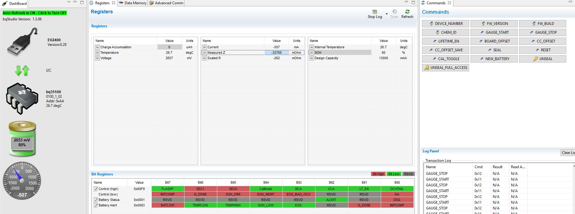

  • Hi Wyatt,
    I have recorded the data for a new battery.
    Battery: PK Cell 14000mAh 34615M LiSOCl2
    Chemistry selected: 0x622
    Load: 500mA [Data shows ~250mA, because I had to change the sense resistor on the EVM from 0.1 to 0.05 ohms. And I'm not able to calibrate it.]
    Todays test: Started with a new battery (new battery command). The procedure was this:
    1. Connected EVM through EV2400, opened BQstudio. Inserted battery. Now, I could see the registers in the BQstudio.
    2. Connected load of 500mA.
    3. GAUGE_START
    4. Load turned on. current goes to 250mA (understandable)
    5. After a minute. Load turned off. Current reduces to zero.
    6. GAUGE_STOP
    7. wait for GA=0 and R,Z,SOH updates.
    Then again:
    1. Gauge_start, load on, load off (after one minute), Gauge_stop (and see for updated values). [I dont do GE Low - as the IC is continuously turned on - hence the data is recorded continuously].
    Now:

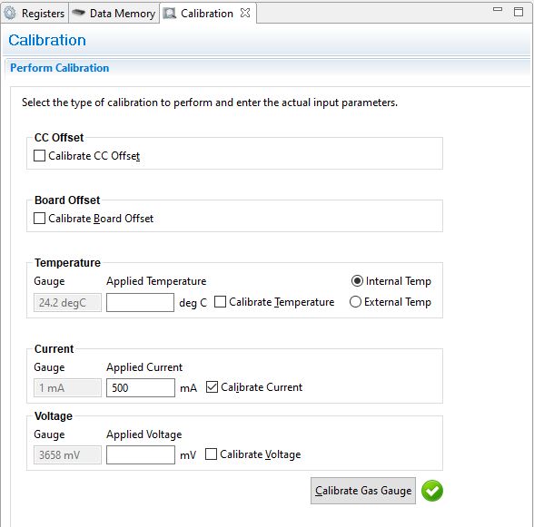

    1. I understand that the chemistry is not exactly same. However, I tried to choose as close as possible (in my opinion).
    2. I tried to calibrate using software and it shows this (green tick in the end. But when I refresh the register values. I dont see the changed current values.)
    PFA: gg.csv file and logged data file.ic_memory_data.gg.csv

    89,2020-09-16 10:49:15,445.048,0x40E1,0,24.2,3546,0x0001,0x0083,0,-32768,-262,24.2,79,13000,1122,SUCCESS
    90,2020-09-16 10:49:20,450.049,0x40E0,0,24.2,3546,0x0001,0x0083,0,-32768,-262,24.2,79,13000,1132,SUCCESS
    91,2020-09-16 10:49:25,455.049,0x40E0,0,24.2,3546,0x0001,0x0083,0,-32768,-262,24.2,79,13000,1127,SUCCESS
    92,2020-09-16 10:49:30,460.050,0x40E0,0,24.2,3546,0x0001,0x0083,0,-32768,-262,24.2,79,13000,1119,SUCCESS
    93,2020-09-16 10:49:35,465.051,0x40E1,0,24.2,3577,0x0001,0x0083,2,-32768,-262,24.2,79,13000,1130,SUCCESS
    94,2020-09-16 10:49:40,470.052,0x40E1,0,24.2,3584,0x0001,0x0083,0,-32768,-262,24.2,79,13000,1127,SUCCESS
    95,2020-09-16 10:49:45,475.052,0x40E1,0,24.2,3330,0x0001,0x0083,-125,-32768,-262,24.2,79,13000,1122,SUCCESS
    96,2020-09-16 10:49:50,480.052,0x40E1,0,24.2,3023,0x0001,0x0083,-253,-32768,-262,24.2,79,13000,1130,SUCCESS
    97,2020-09-16 10:49:55,485.053,0x40E1,0,24.2,2977,0x0001,0x0083,-253,-32768,-262,24.2,79,13000,1126,SUCCESS
    98,2020-09-16 10:50:00,490.054,0x40E1,0,24.2,2922,0x0001,0x0083,-253,-32768,-262,24.2,79,13000,1121,SUCCESS
    99,2020-09-16 10:50:05,495.055,0x40E1,0,24.2,2880,0x0001,0x0083,-253,-32768,-262,24.2,79,13000,1146,SUCCESS
    100,2020-09-16 10:50:10,500.055,0x40E1,0,24.2,2846,0x0001,0x0083,-254,-32768,-262,24.2,79,13000,1154,SUCCESS
    101,2020-09-16 10:50:15,505.056,0x40E1,0,24.2,2822,0x0001,0x0083,-253,-32768,-262,24.2,79,13000,1075,SUCCESS
    102,2020-09-16 10:50:20,510.056,0x40E1,0,24.2,2792,0x0001,0x0083,-252,-32768,-262,24.2,79,13000,931,SUCCESS
    103,2020-09-16 10:50:25,515.056,0x40E1,0,24.2,2770,0x0001,0x0083,-252,-32768,-262,24.2,79,13000,929,SUCCESS
    104,2020-09-16 10:50:30,520.057,0x40E1,0,24.2,2750,0x0001,0x0083,-254,-32768,-262,24.2,79,13000,933,SUCCESS
    105,2020-09-16 10:50:35,525.057,0x40E1,0,24.2,2736,0x0001,0x0083,-254,-32768,-262,24.2,79,13000,960,SUCCESS
    106,2020-09-16 10:50:40,530.058,0x40E1,0,24.2,2724,0x0001,0x0083,-253,-32768,-262,24.2,79,13000,936,SUCCESS
    107,2020-09-16 10:50:45,535.059,0x40E1,0,24.2,3489,0x0001,0x0083,1,-32768,-262,24.2,79,13000,927,SUCCESS
    108,2020-09-16 10:50:50,540.060,0x40E1,0,24.2,3512,0x0001,0x0083,0,-32768,-262,24.2,79,13000,971,SUCCESS
    109,2020-09-16 10:50:55,545.061,0x40E1,0,24.2,3525,0x0001,0x0083,0,-32768,-262,24.2,79,13000,933,SUCCESS
    110,2020-09-16 10:51:00,550.061,0x40E1,0,24.2,3537,0x0001,0x0083,0,-32768,-262,24.2,79,13000,943,SUCCESS
    111,2020-09-16 10:51:05,555.061,0x40E0,0,24.2,3537,0x0001,0x0083,0,-32768,-262,24.2,79,13000,943,SUCCESS
    112,2020-09-16 10:51:10,560.061,0x40E0,0,24.2,3537,0x0001,0x0083,0,-32768,-262,24.2,79,13000,227,SUCCESS
    113,2020-09-16 10:51:15,565.062,0x40E1,0,24.2,3560,0x0001,0x0083,1,-32768,-262,24.2,79,13000,327,SUCCESS
    114,2020-09-16 10:51:20,570.062,0x40E1,0,24.2,3564,0x0001,0x0083,1,-32768,-262,24.2,79,13000,257,SUCCESS
    115,2020-09-16 10:51:25,575.062,0x40E1,0,24.2,3249,0x0001,0x0083,-142,-32768,-262,24.2,79,13000,257,SUCCESS
    116,2020-09-16 10:51:30,580.063,0x40E1,0,24.2,2969,0x0001,0x0083,-253,-32768,-262,24.2,79,13000,350,SUCCESS
    117,2020-09-16 10:51:35,585.064,0x40E1,0,24.2,2916,0x0001,0x0083,-253,-32768,-262,24.2,79,13000,209,SUCCESS
    118,2020-09-16 10:51:40,590.064,0x40E1,0,24.2,2863,0x0001,0x0083,-254,-32768,-262,24.2,79,13000,269,SUCCESS
    119,2020-09-16 10:51:45,595.065,0x40E1,0,24.2,2836,0x0001,0x0083,-253,-32768,-262,24.2,79,13000,354,SUCCESS
    120,2020-09-16 10:51:50,600.065,0x40E1,0,24.2,2804,0x0001,0x0083,-253,-32768,-262,24.2,79,13000,270,SUCCESS
    121,2020-09-16 10:51:55,605.066,0x40E1,0,24.2,2782,0x0001,0x0083,-253,-32768,-262,24.2,79,13000,266,SUCCESS
    122,2020-09-16 10:52:00,610.066,0x40E1,0,24.2,2762,0x0001,0x0083,-253,-32768,-262,24.2,79,13000,283,SUCCESS
    123,2020-09-16 10:52:05,615.067,0x40E1,0,24.2,2746,0x0001,0x0083,-253,-32768,-262,24.2,79,13000,206,SUCCESS
    124,2020-09-16 10:52:10,620.067,0x40E1,0,24.2,2731,0x0001,0x0083,-254,-32768,-262,24.2,79,13000,205,SUCCESS
    125,2020-09-16 10:52:15,625.067,0x40E1,0,24.2,2722,0x0001,0x0083,-253,-32768,-262,24.2,79,13000,285,SUCCESS
    126,2020-09-16 10:52:20,630.068,0x40E1,0,24.2,2706,0x0001,0x0083,-253,-32768,-262,24.2,79,13000,205,SUCCESS
    127,2020-09-16 10:52:25,635.069,0x40E1,0,24.2,2701,0x0001,0x0083,-253,-32768,-262,24.2,79,13000,219,SUCCESS
    128,2020-09-16 10:52:30,640.069,0x40E1,0,24.2,3496,0x0001,0x0083,-253,-32768,-262,24.2,79,13000,335,SUCCESS
    129,2020-09-16 10:52:35,645.069,0x40E1,0,24.2,3513,0x0001,0x0083,-253,-32768,-262,24.2,79,13000,203,SUCCESS
    130,2020-09-16 10:52:40,650.070,0x40E0,0,24.2,3520,0x0001,0x0083,-253,-32768,-262,24.2,79,13000,218,SUCCESS
    131,2020-09-16 10:52:45,655.070,0x40E0,0,24.2,3520,0x0001,0x0083,-253,-32768,-262,24.2,79,13000,215,SUCCESS
    132,2020-09-16 10:52:50,660.071,0x40E0,0,24.2,3520,0x0001,0x0083,-253,-32768,-262,24.2,79,13000,373,SUCCESS
  • In additions to the previous reply. This is the calibration widows snapshot.
    Kamlesh
