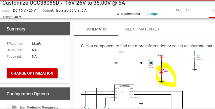

Our customer just like to clarify what the the voltage source Vbat that is connected to the Vdd pin of UCC38085 means. Is this a battery? What type of battery is this?. See below image.

Hello Hong,
Apologies for the delayed response as I have to confirm first with the customer if the schematic can be shared here. Refer to below link for the full schematic.

Hi Hong,
I have attached the schematic in pdf.
The VBAT is the one connected to Vdd pin of U1 (UCC38085D).

That is just to show a bias is needed for UCC38085. The bias circuit is not designed so a battery is shown here to say here a bias is needed and you need design a bias. A usual way is to add a bias winding to the transformer to serve this purpose. But the circuit you provided does not have such a bias so the circuit uses a battery to represent this bias.
Hi Hong,
thanks for your answer.
I was already thinking that the ic's need a bias voltage, but I wonder how high this voltage must be.
