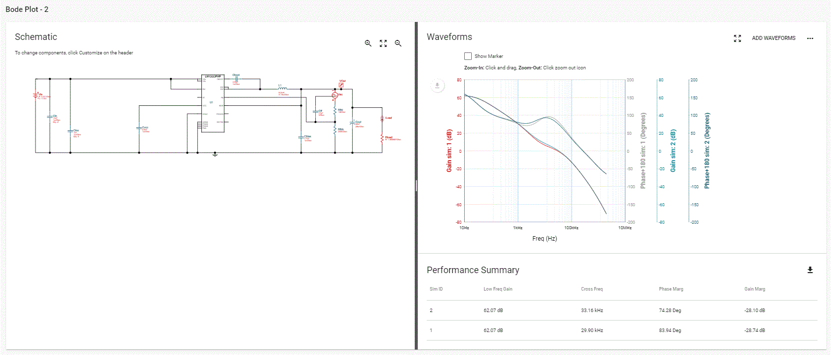

  • HI
    you can use the wenbench mode to performance the loop analysis to see the cff impact on the gain and phase.
    Improve the cross frequency means to get a higher cross frequency which will be helpful to the transient.
    below is wenbench sim result of 33pF and 47pF
  • Thanks Daniel, I'll give it a go and then let's see how accurate simulation is.
