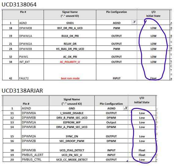

Are all the ucd3138’s pins (not include ADC/BP18/RESET/Vss/VDD/EAP) configured to input mode during power on reset?
For example:
                              Pin 12 is Open Drain. So it is float mode. But how about DPWM0A? Does it float mode also?
 Thanks!
Alfred
  • Can you confirm that the below table is correct for the pins initial state at power on reset?
  • I don't know where you got those last charts.  I hope it's not a TI document, as it has some issues, for example all DPWMs are always low after reset.
    It's a bit more complicated, because on some devices, all GPIO pins are pulled low during reset, and then released when reset is releases.  Other devices the GPIO pins float during and after reset.  Of course, before the 3.3 volt supply reaches an acceptable level, they are indeterminate.

    * For definition of IReset please see drawing below
    Note that Ireset actually is low when the external reset pin is low, not high.  So if the reset pin is held low, most of the devices will pull their GPIO pins low as well.
