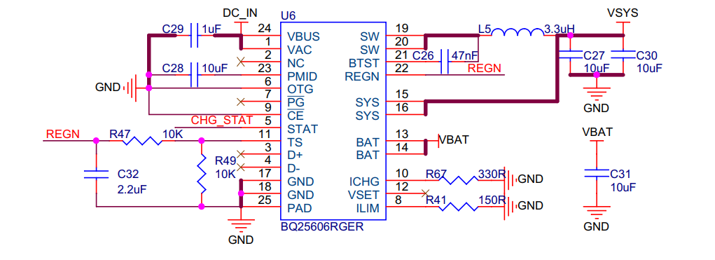

I am using BQ25606, but it seems to work abnormal.
1.When I only connect battery to BQ25606 but no load in VSYS,VSYS is normal;
2.But when I connect a 100mA load at VSYS,VSYS has no output;
3.I connect a VBUS input to BQ25606,the VSYS is normal again.However, at this time, if I remove VBUS, the VSYS output is still there.
4.Then I remove the VBUS input and use a DC power instead of battery,VSYS is normal whether the load is connect or not.
What can cause this issue?
I connect the  BAT to the VSYS directly,it seems to work,does it cause anyother problem?
Thank you!

    Looking at your schematic, your TS pin is configured incorrectly. Please refer to section 8.3.6.4 for proper configuration and substitute the thermistor with a 10k if you do not desire JEITA.
    Also, please replace C32 with a 4.7uF capacitor.

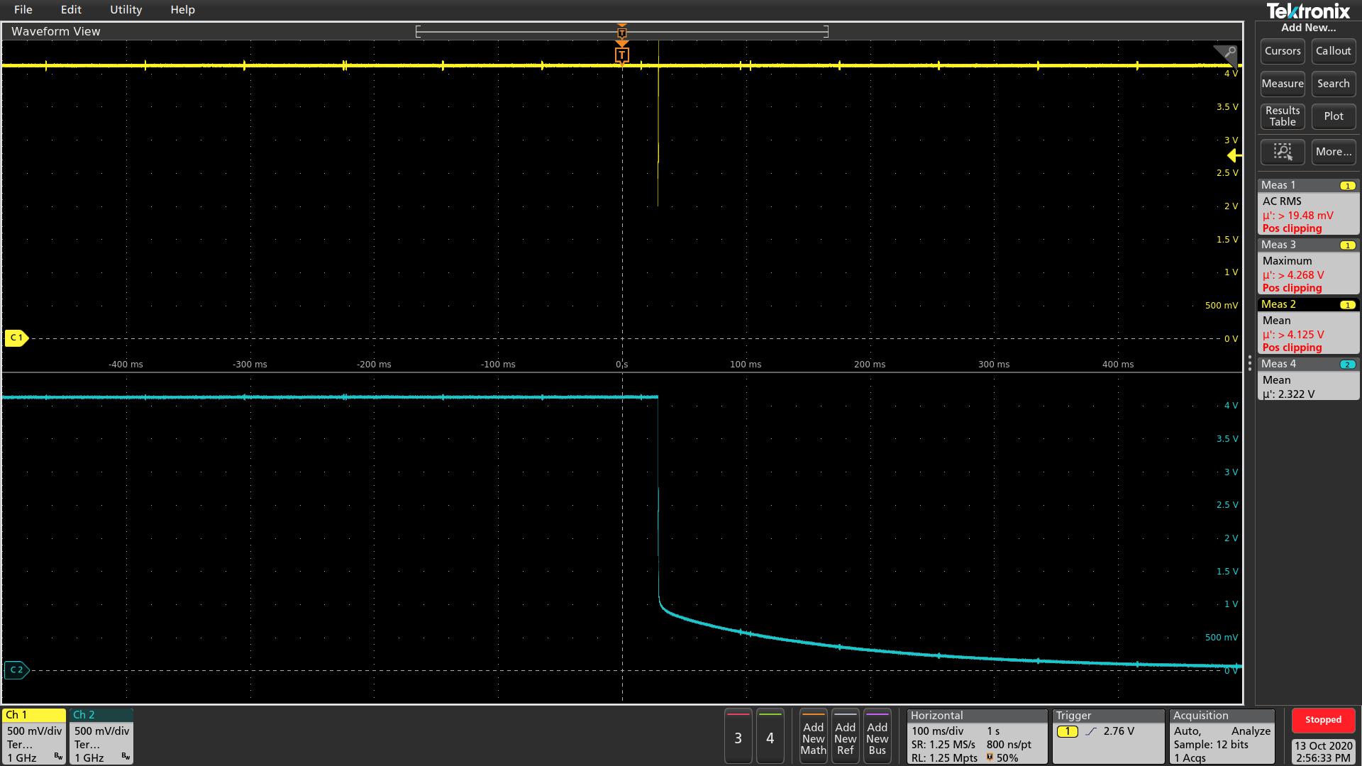

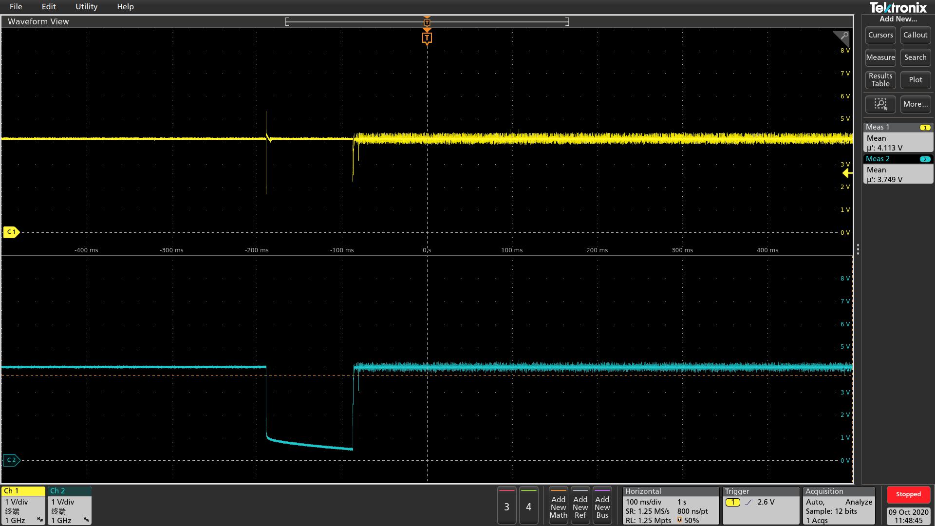

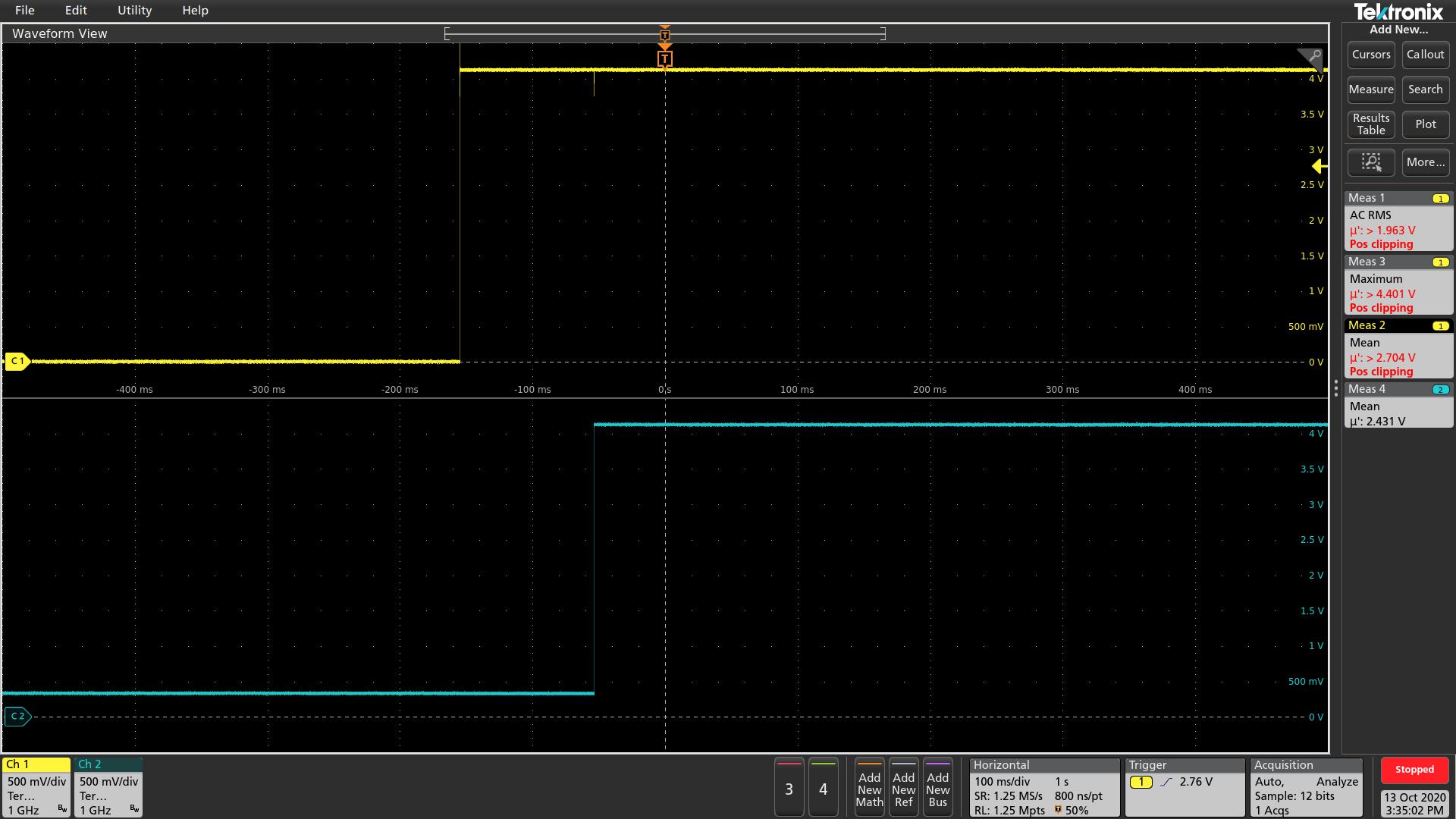

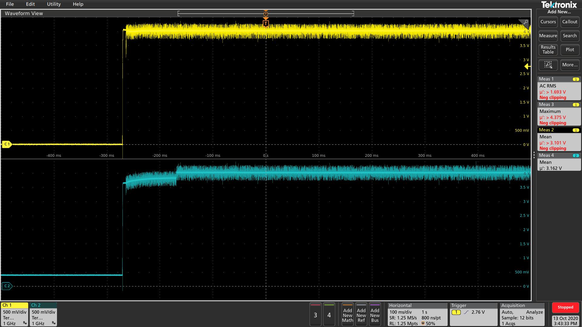

  • Hi everything looks OK. If DC power supply at BAT works but battery does not work. I suspect the battery. Could you compare the waveforms at BAT and SYS when load is added or battery is plugged in? If you connect your load to the battery directly, what is the battery voltage?
    What is your load resistance on SYS? How do you connect your load to SYS? If you connect your load on SYS and then apply battery, do you have problem?
  • Hi, HongMao
    Thanks for your patient reply
    Here's the waveforms(CH1 for BAT and CH2 for SYS)
    1.BAT and SYS when load is added(Powered by DC power supply)
     2.BAT and SYS when load is added(Powered by battery)
    3.BAT and SYS when battery is plugged in

  • For #3, the load is connected before insert battery? If yes, I think there is surge current somehow when load is connected to SYS. Do you have a way to measure current from SYS to load when load is connected. From #1 and #2, there is voltage spike observed which should be caused by the surge current.
  • Hi, HongMao
    1.In #3,the load is not connected.That's just the waveform of BAT and SYS when battery is plugged in.

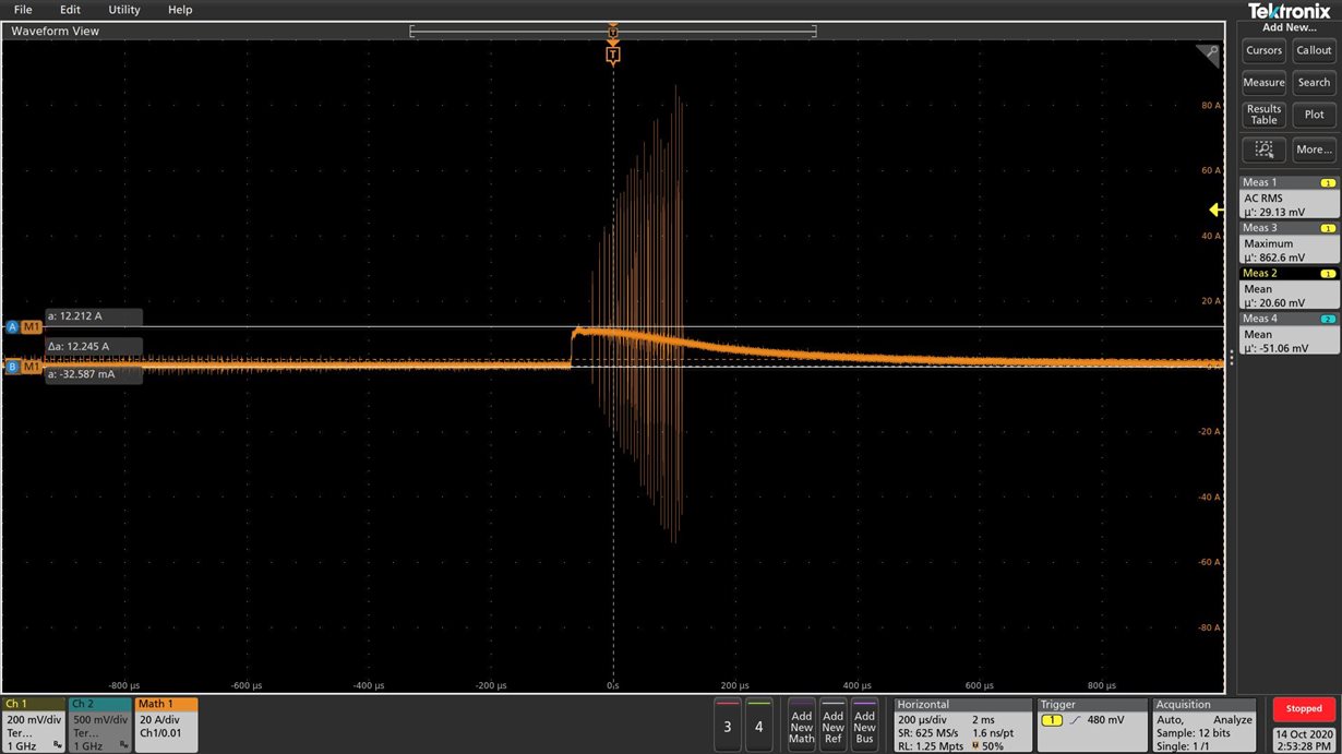

    2.I put a 0.01Ohm series resistor between SYS and the load to measure current.Here's the waveform.
    SYS current waveform when load is added(Powered by battery)
  • Is the current 12A according to the waveform? In this case, the BATFET OCP is triggered and turned off.
  • What can cause the surge current?What can I do to prevent the surge current or turn on the BATFET again?
  • If it is caused by the surge current,then why do I use DC power supply is no problem?
  • Even with DC power supply, you can see the SYS voltage is pulled to zero and there is big voltage spike. I suggest to find out what caused the current spike. You have big cap on your load? If yes, slowing down your ON/OFF FET.
