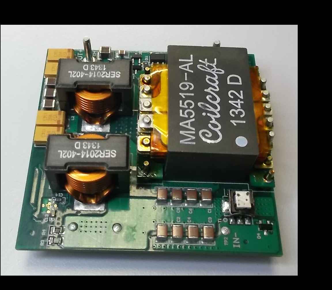

  • Hello Furkan,
    we neither have TINA simulation of design nor TINA model of controller;
    we just got PSPICE model.
    On the other hand we got built & tested hardware that you could rebuild,
    please check if attachment speeds up your design process,
    best regards, Bernd
     PMP9219_Assy.PDFPMP9219_BoM.pdf5367.PMP9219_schematics.pdfMA5519_FB_xfmr.pdfPMP9219_GERBER_data.zip

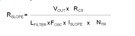

  • Hello again. I continue with snva627b.pdf. I have a question. I am trying to determinate the formula in below
    For this example
    Rslope = 1K
    Vout = 60V
    Rcs = 3R
    Lfilter = 4uH/2 = 2uH
    Fosc = 416666 Hz
    Islope = 100uA
    When I wrote these values I cant find logical Ntr value. What is the my fault can you please help me to fix it?

  • Hello Ali,
    please have a look at schematics, there is a current sense transformer implemented, please see schematics T1.
    If you check data sheet windings ratio is 1:125.
    CS at LM5045 will trip at 750mV; so for a pure resistor sensing at 26Apk (36Vin) and a margin around 20%..30%
    the resistor value is 750mV/32.5Amax = 23milliOhms, selected 22milliOhms. BUT:
    rms current of both legs is 2x 16Arms (36Vin), losses 32Arms^2 x 22milliOhms = 22.53W (!!!)
    To avoid this losses a high side current sense transformer is implemented instead of low side resistor sensing.
    Let's calculate backwards: 750mV across burden resistor 3 Ohms results in 250mA.
    By windings ratio 1:125 this reflects a maximum primary current of 31.25Apk.
    By windings ratio 1:125 the burden resistor 3 Ohm injects a current sense resistor of 24milliOhms at bridge.
    So the design and my quick estimation is fairly close.   (-;
    Attached a analysis of your power stage at nominal input 48V, best regards, Bernd
    FullBridge_Ali.pdf
  • ello Bernd
    First of all thank you for your answers.  These answers helped me understand some another things but they were not actually my questions :)
    I asked my question with pictures but I recognized now my pictures were not sent. Sorry about that. My questions were about the formula that in below.
    Rslope = 1K
    Vout = 12V
    Rcs = 3R
    Fosc = 416666 Hz
    Islope = 100uA
    With these parameter's values the Ntr shows up 432. Which parameter is wrong?
    BR

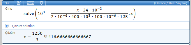

  • Hello Bernd.
    I understood you but I need to calculate Vout voltage. But when I try to calculate Vout with the formula the result is equal 416.6 V. Can you please tell me that how to calculate Vout value. I also wrote Rcs = 24*10^-3
    I wrote x instead of Vout. Please help me to put this formula right way.
    Best regards

  • Please see the example at the data sheet at the bottom of page 23:
    output voltage 3.3V, current sense resistor 0.15 Ohms, output inductor 0.8uH, slope current 100uA, switching frequency 420kHz, windings ratio 9:1
    results in slope resistor:
    Rslp = (3.3V x 0.15 Ohms) / ( 0.8uH x 420kHz x 100uA x 9) = 1637 Ohms, would select 1k65.
    Similar for your design:
    Rslp = (12V x 24milliOhms) / (4uH x 400kHz x 100uA x 1.5) = 1200 Ohms, the design itself shows 1k.
    I can't answer the question why 1k has been used instead of 1k2, this has to be answered by the designer;
    but we're tuning our designs on the bench, and there always might be a small difference in theory and built & tested hardware.

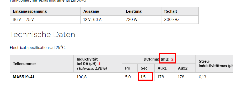

    The upper windings ratio 1.5 I got from data sheet of Coilcraft MA5519-AL:
    Best regards, Bernd
  • Hello Bernd,
    Thank you first of all. That was actually what I am asking. Do you see 1.5 ohm thing is shown as mOhm?
    Also I actually want to set output voltage what ever I want. For example if I want to make output voltage 50V Can I use the same formula? If I change the place between Rslope and Vout that in the formula can I calculate Vout with the other parameters? Or Is Vout depended with another parameters? Can you help about this question?
  • I understood 1.5 is about 6/4 I realized late sory. Can you please answer the second question about Vout?
  • Hello Ali,
    Vout means output voltage; the design we're talking about got 12V output voltage;
    that's the value the prior equation is based on.
    I just added another example for 3.3V out of the data sheet so that you are able to follow
    the design procedure of our data sheet.
    Both equations are correct, best regards, Bernd
