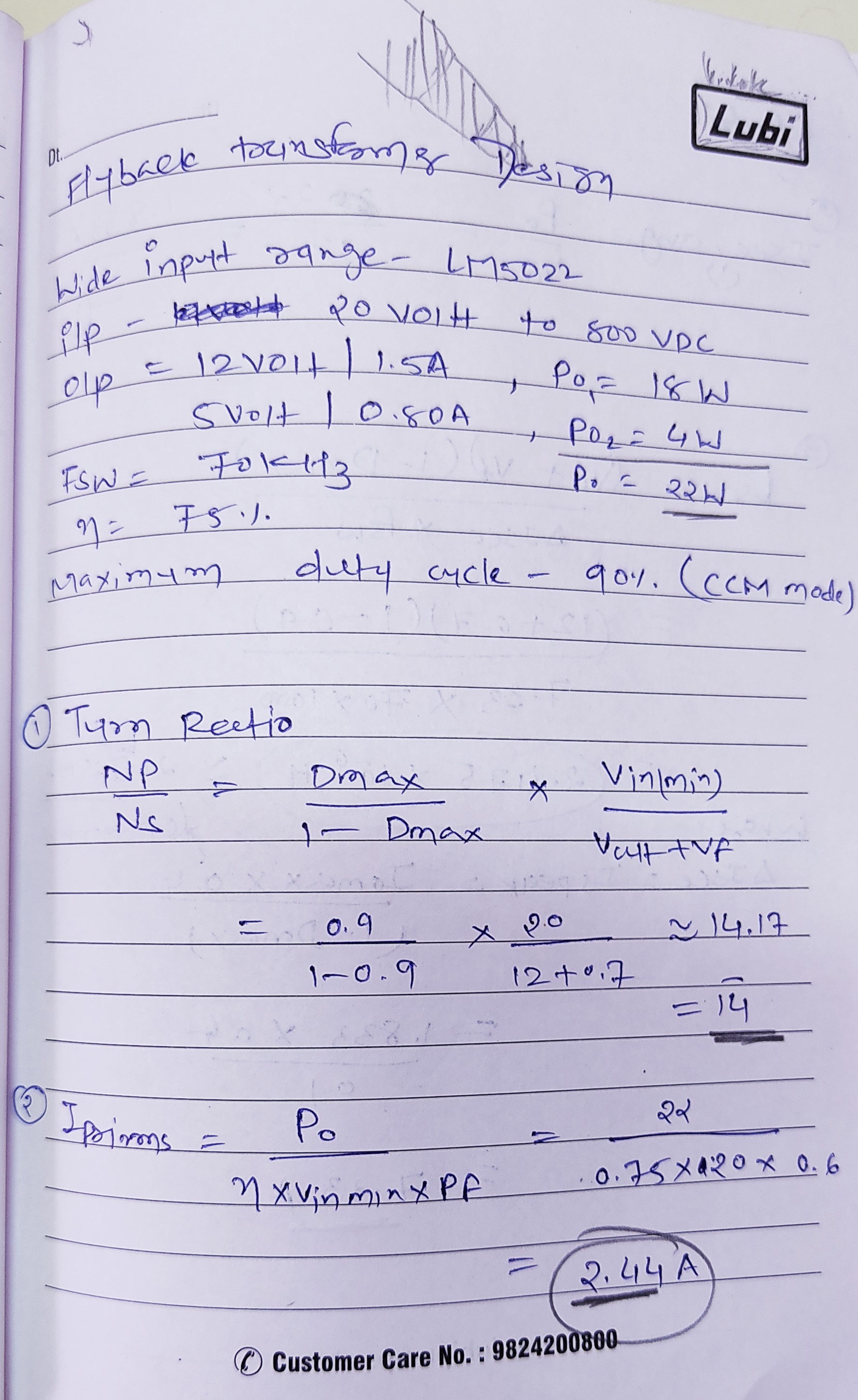

HI,
Kindly verify the transformer design for this wide input power supply using LM5022
i am designing the power supply for my solar inverter in which output of solar panel (750Vdc to 800Vdc) directly fed to the flyback power supply by using PMP7760 circuit.
i/p : 20v to 800V
o/p : 12V/ 1.5A & 5 V / 800mA
Fsw: 70kHz
efficiency :  75max. duty Cycle: 90% in CCM Mode
i wanted to get 2 secondary ouput in which Sec_1 : 12 Volt/1.5A & Sec_2: 5 Volt/800 mA.
Currently I've calculated the transformer turn, inductance and all with respect to 12 Volt/1.5 A.and for 5 volt/800mA  is remaining.
will anybody please verify it give me there valuable feedback on it.
i will follow the PMP7760 exact circuit for the same so that you can consider it respectively.
also suggest me that can i use multiple tapping for generate more supply voltage on secondary side ?

  • Hi Vivek,
    Thank you for your patience. I'll look into your calculation.
    How many output do you want to have in total?
    Generally yes, you can add another winding turns on the secondary side for additional output. But make sure you check the transformer specs to see  how much galvanic isolation it provides between the turns.

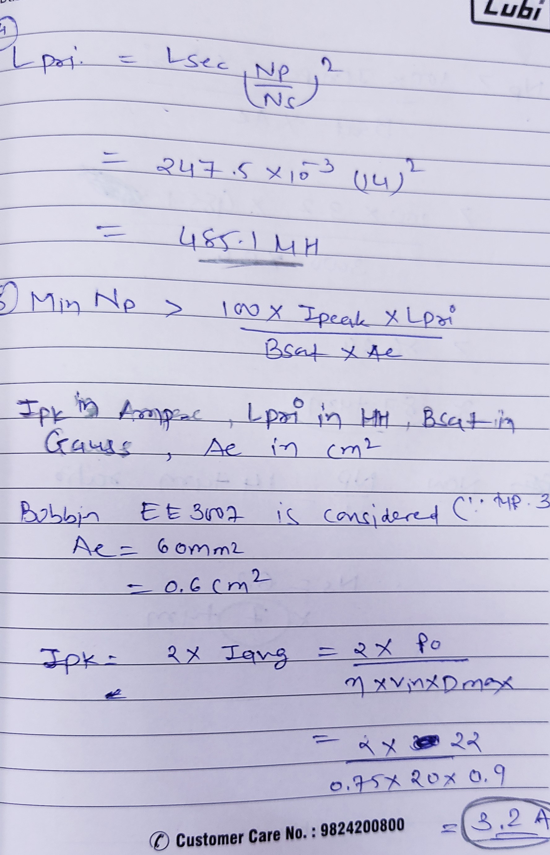

  • Dear  Yinsong Cai1,
    if i just add those output on secondary side then should i change the transformer or not ?
    You dint tell me about the calculation ?
    i am attaching you the transformer datasheet that i am going to use.is it ok?
    Also this transformer has Core area is 53.9mm2, Flux Density is 4800G @ 10Khz, 25°C; 3800G at 100°C. comfirmed with vendor as well.
    please comment on my calculation and transformer selection and give your valuable advise.

  • Hi Vivek,
    The transformer only has one secondary turns so you will need a transformer with more secondary turns. Since you have selected the primary aux turns ratio, the secondary side turns number will be decide accordingly. However, since the three outputs are all different, you may want to go back and make sure the turns ratio of the new transformer is good for all.
    For the calculation, you just need to add the additional part of the power into the total power and remember to reflect it to the primary side.

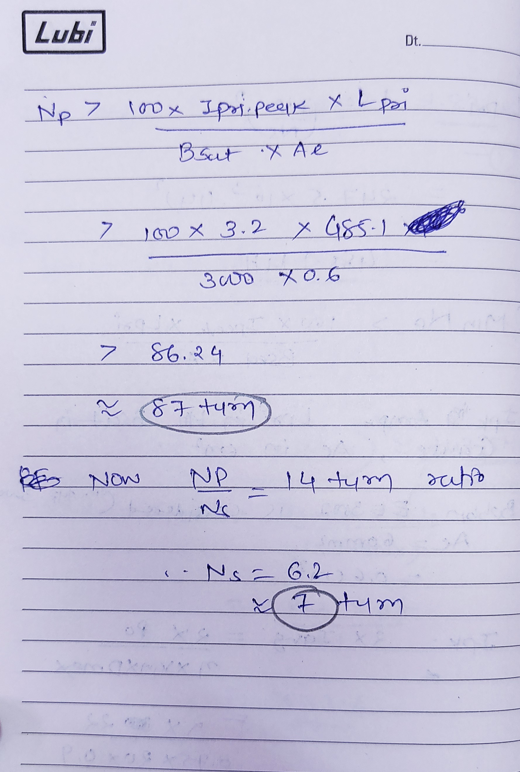

  • Hi Vivek,
    Yes. For the calculation of the other two, just make Po = 12V*Is1+15V*Is2+10V*Is3 and redo the following steps.
    Yinsong

  • Hi Vivek,
    You don't need to change the original turns ratio, but the ratios of the other turns should match there target output voltage.
    Just make sure the primary regulated turns ratio and its output match with the secondary output.
    For example, if your primary side is regulated to 12V and has 1 turn, then the 5V secondary side should have 5/12 turn.

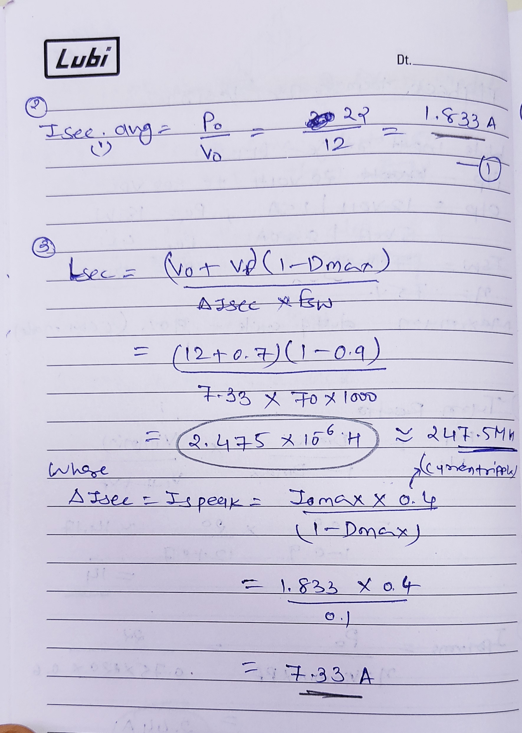

  • Hi Vivek,
    1. Yes, that is a good example of negative output.
    2. Sorry I didn't notice the maximum duty cycle. If you look at the datasheet, the minimum max duty cycle is 90% so it is right at the limit. I would give it some margin. You can increase your prim1 to prim2 turns ratio to reduce the duty cycle required.
    3. Yes, if the four outputs are required.
